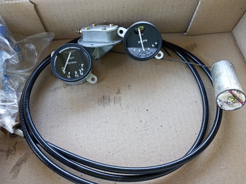

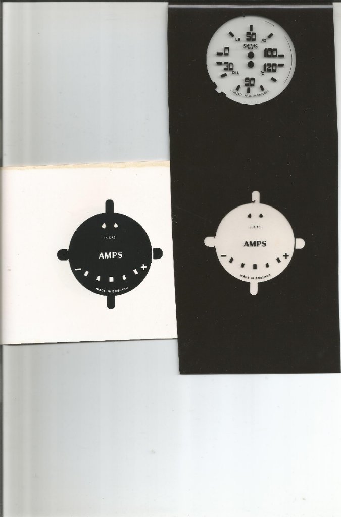

Could some one please post a clear picture of the gauge.
As Lionel Otto instruments is not happy with those on the net.
- Posts: 557
Somewhere I have the art work for all the gauges. Hope to find them today!
Nick Webster
- Posts: 321
- Given Name: Nick
That style ammeter is fitted to late Javelin. Whether it is common to Jupiter I do not know.
- Posts: 557
Had these done through professional contacts for my racer build in 1990. The restoration costs of the face plates exceeded the costs of the mechanical restorations. Dry transfers were made and I did the work. The woman who owned the gauge shop scolded me that it would not last the year. 33 years on, gauges look new.

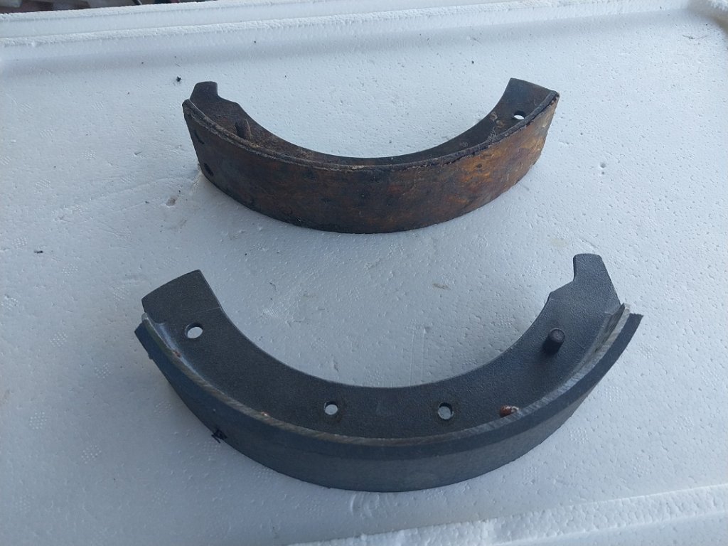

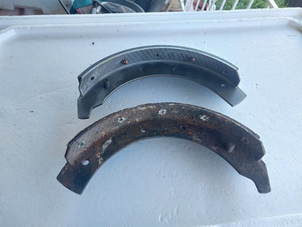

Though I now have a Bradford I have not given up on my Jupiter & have had the brake shoes relined & drums machined to fit. Tomorrow I hope to assemble the brakes & work out what is missing.
- Posts: 642
Many years ago to help stay alive I made sure my girlfriends bed springs were well oiled, this kept her angry gorilla of a Dad off my case. Now many years later I need to find a way to stop my brake shoe springs rusting, this time to stay alive I cant use oil. Any ideas? At the moment a I can think of is a light coat of paint.
- Posts: 20684
The same thought might apply to the Bradford, you can just about lie down in the back. I suggest using a water repellant grease, probably calcium based.
https://www.vintageandsportscarservices ... g-41-p.asp
For brake springs painting them the correct colour (yellow, green and black) is the best option.
For brakes use a high melting point grease made for brakes based on lithium.
https://www.super-lube.com/brake-grease-applications

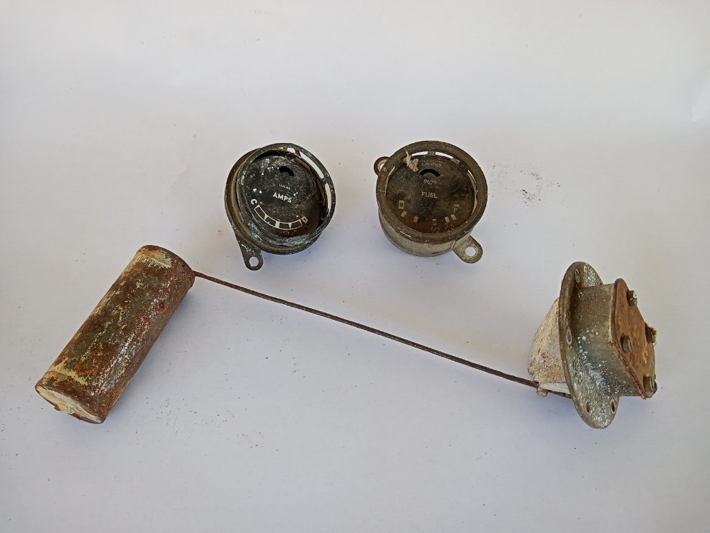

I have had the fuel sender & final gauges rebuilt.
The more holes I plug in the tank the more I find.
I have bought a tank sealing kit, whuch I will use once all the known holes are repaired.

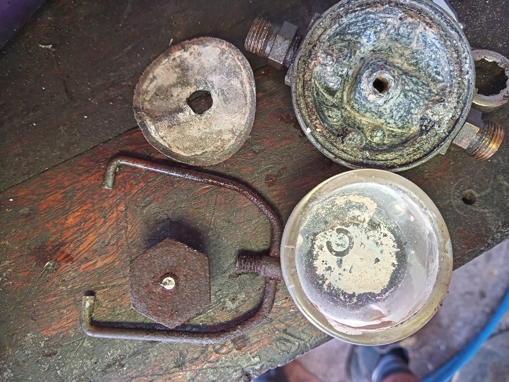

I have patched the holes in my fuel tank with solder, then sealed it with kbs tank sealer. I decided to clean the original filter, it was so corroded I have put it into my too hard box & bought a plastic inline strainer. Likewise the original fuel pump has been discarded in favour of a Kiwi made pump.
All parts from tank to carb are now in a box for the day they are required to bring the car back to museum condition.
- Posts: 20684
We should be able to find a servicable original filter. Points and diaphragm should be available for pump. Speak to JCS.
