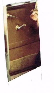

I had the door cards for my 1950 De Luxe Javelin remade by a Jaguar Restoration company. They found that the cards were made in the same manner that the Jaguar Mk 1X were. Possibly by a sub contractor?

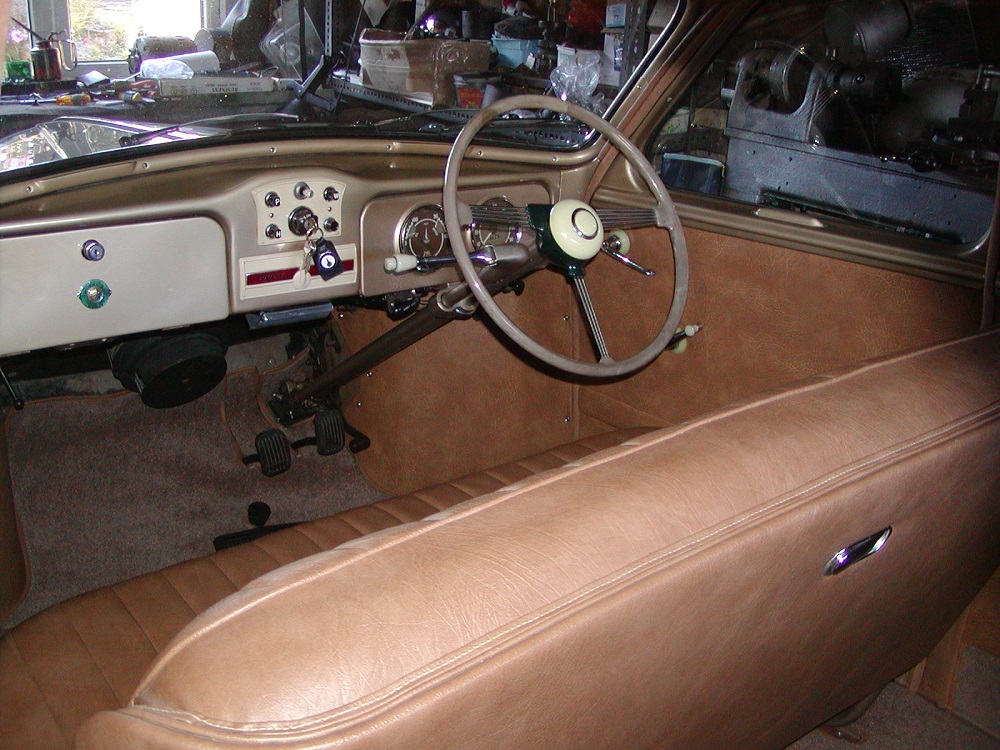

Hi Peter, the correct colour for the window metal surround is gold / beige. All the standard models
with your interior that I've seen have this matching colour for the window surround.
Yours must have been painted in a different colour sometime in it's past
Alf.

Peter, as you may know paint colour will alter after 60+ years, even inside panels to some extent.
Without the original paint-code I find a visual match is as good a method taking into account
the ageing process, you will get very close to the original.
The correct type & colour furflex is available, try Woolies-trim.co.uk
Pict to show Std model interior colour match.
Alf.
