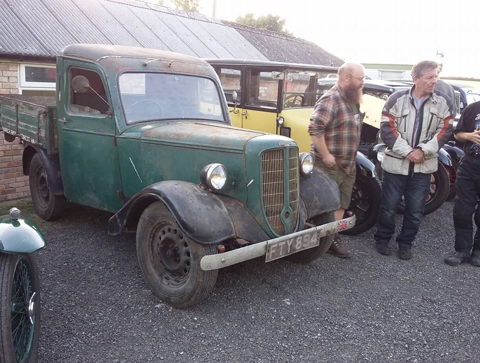

Well 4 years & 6 months after Tramp arrived on a trailer. I and friend attended a Classic Pub night, the first proper outing for the Bradford. Still lots to do, but made it under its own steam and no hiccups. Perhaps the birds provided the luck! Even chasing 50mph at one point. Lots to sort out with steering and brakes along with tyres. But it felt good to be out on road. I have few more videos to upload of driving around the compound over the last few weeks.

I wonder if / hope that you intend to retain that irreplaceable patina that is at last being recognised as confirmation of a working life well lived?

Aha. Yes Ian, the patina is staying, Still working on a way to protect it. All the panel work which has been welded I've tried hard to make the repairs not stand out too much. The brushed over matt black seems to have blended well with the rest of it.

I used to have a 1920 Hupmobile in similar condition. I found the best way to enhance/preserve the paintwork was to brush with black shoe polish and then buff with a lint-free cloth. It also works on surface rust and can build a patina rather like the barrel of a gun.
Any normal car polish/ brasso/ furniture wax dries in the imperfections and shows white. Lots of people suggest spraying with WD40 and wiping clean with a rag. That can work, but tends to become a hazard to clothes and also attracts dust.
