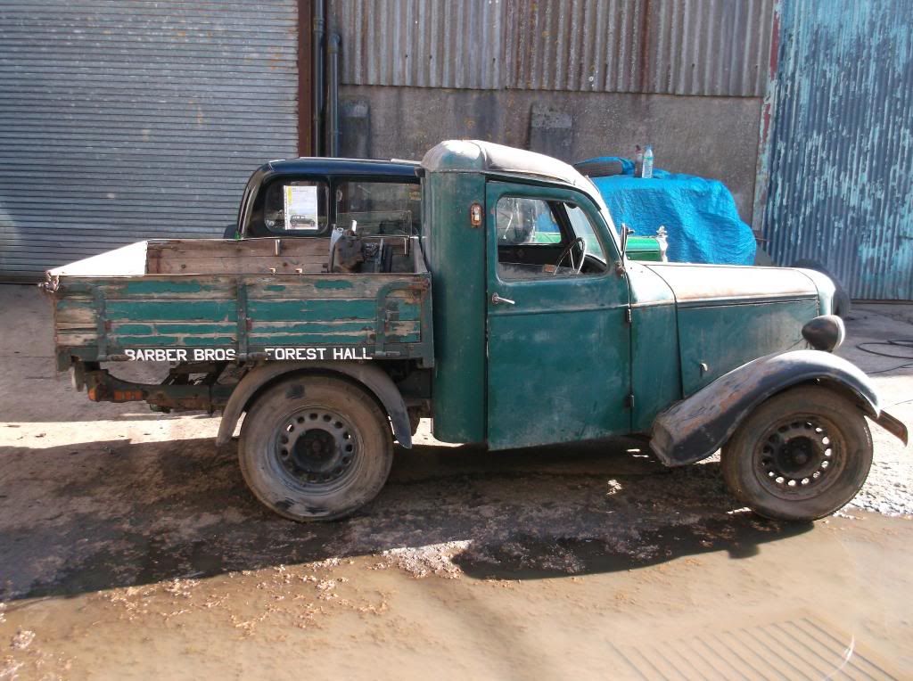

Well I have taken a plunge!
After thinking for a while how I would be interested at some point in the future getting another Jowett. An opportunity came up and I now have taken what seems a giant leap and bought another!
There was an advert in the autojumbler. which a my ex/old boss spotted and asked if I was interested, after a bit of thought and few phone calls later the deal was done. The lorry has spent the last 30 odd years in a garage up in Northumberland. A fair way from Somerset! But with a few work connections it wasn't too much trouble to get it collected and delivered down. It arrived Wednesday evening, and only having seen it a few photos in dark garage. The moment of truth. And it seeming structurally sound with a few bits and pieces to be done. Its starting the look better and better! Although at the moment he looks ragged around the edges I see a lot of potential!
As I still have a lot of cosmetic work to do on The Lady (Long Saloon). Hes going to be on the back burner, but still glad I've taken the first step!

Hi Alan,
Well done! It looks a super project and will give you hours of fun! We look forward to seeing it on the road very soon ( next week? ).

Well done Alan! It looks like the panelwork is sound - at least if there is woodwork to be done you only have the cab to worry about! What's the engine like?
Posts: 759
Re: Bradford CC Lorry (The Tramp)
Its going to be a slow one I think, though it is mainly all there.

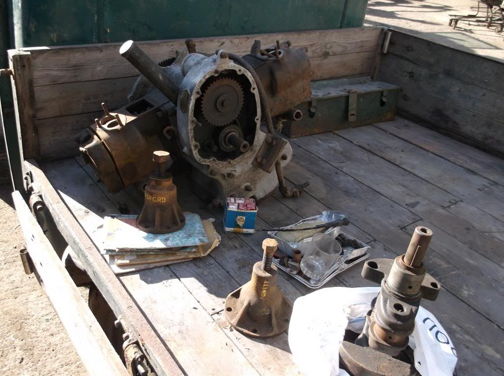

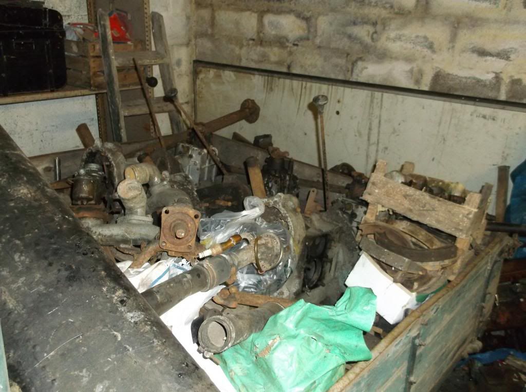

It has been off the road since around 77, and being stored in a garage ever since. The reason it came off the road was it had snapped a crankshaft. In the picture is engine, the original one for it matching the chassis number. Though supplied with it was a lorry load of spares. including crankshafts so I'm hoping one of the spares should suffice together with new bearings and shells.

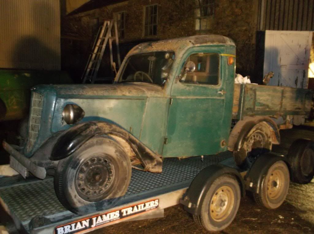

My plan of action is to repair the bits of woodwork, and get the body straight and ready for paintwork, then remove the cab, and get the chassis de rusted and repainted. Everything looks fairly serviceable on the car. Even the tyres hold air!
There are a few woodwork repairs to do but most of it has been already done.

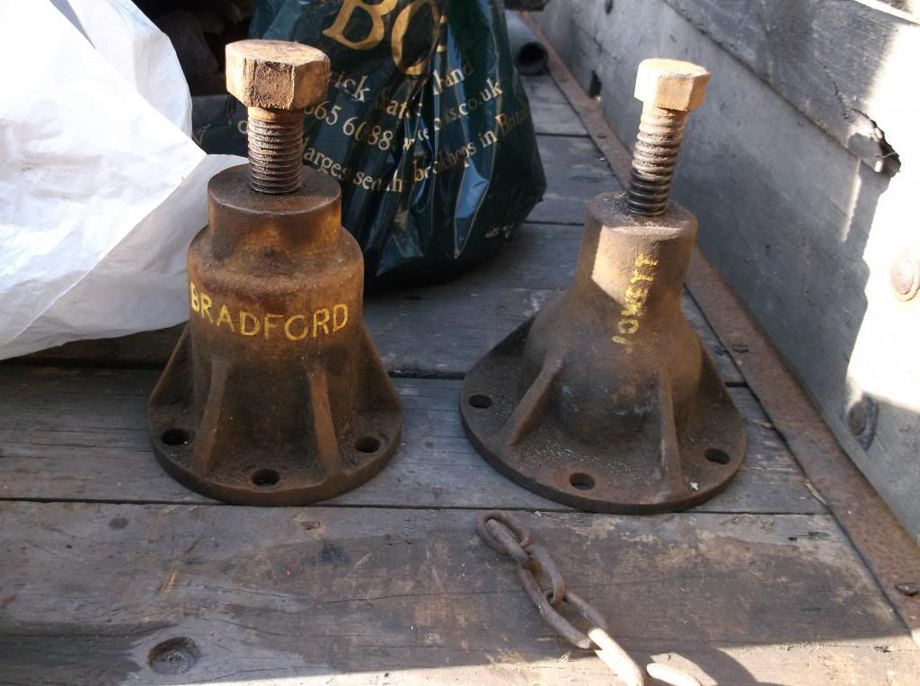

Its nice to see that in a little under 20 years the special tools haven't changed much!
A couple of 'treasures' there Alan in the special tools!

Ian, thanks for the thoughts. My first thoughts and overall plans were to repair what needed repairing, prepare it for a repaint, and sort out the engine and freshen up the chassis with a lick of paint also! But now you say about oily rag it does seem quite a good thing to do! So many directions it could go.
My three options are:
1. Repaint it/repaint all the chassis and make everything nice and presentable
2. Repaint it but perhaps in something with a little flare with paintwork perhaps airbrushing patterns and what not (flames!) A nice gloss black with flames all over the bonnet would be quite fitting! ha. A bit of fun.
3. To leave it as it and service all the mechanicals and running gear and get him going again. I must admit it would be quite an attraction as it is, though he needs a few repair patches for this it wouldn't be a bad options.

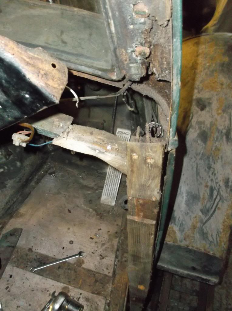

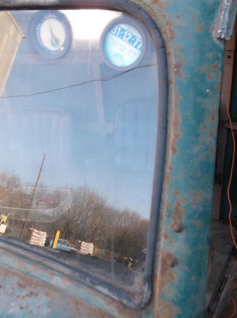

As I spent the day removing the small bits of trim and the doors so I could get to the wood work that needs to be done. I came across two bolts which I'm not sure if they look like there meant to be there or not? These were situated next to the windscreen on the a pillar, all the way though the woodwork and metal work. Which looked like the may have been chrome domed headed nuts at somepoint in the past. Should they be there?

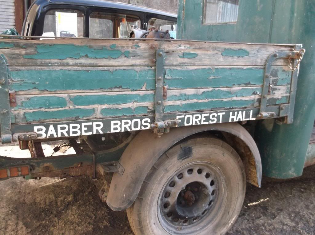

Alan , From an entry in the London Gazette it seems that Barber Brothers were Florists in Forest Hall , Newcastle on Tyne in the 1970s

The domed head nuts are in about the right place for a rear view mirror fitting, when I acquired my Bradford back in the 70's it had a mirror (similar to the one on your drivers door) screwed through the pillar into the timber frame behind albeit on the drivers side, The CC Parts book shows a mirror that would probably fit the fixings. (Part no 865)
Judging by the gap showing along the top of the doors the "A" post pillar has moved, and the door has dropped, it is also evident in the waist line molding, if everything is inline then the scuttle is in the correct position, yours appears to run down towards the back.

Steve, thanks for the link, I was able to find one, and should be on its way to me soon. You are right, both doors have dropped, this my first job to do is to sort out the wood work on the pillars, it has been patched before, luckily there is enough for a pattern, just got to get it out in one piece. Which seems do able.
Those mirror bolts appear to be the only thing holding the rest of the A post together! I shall replace with some chrome ones when I get nearer to it.

I'm doing the utility Lkk77 so I know how bad the pillars can get!

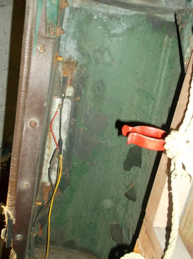

Well yesterdays tinkering discovery is that it used to be fitted with internal semi-phores/trafficators, which the body work has been patched up using filler and and gauze (a very old repair) Together with metal brackets for them which it still has in place. So when I get around to the wiring I would like to put them back in.

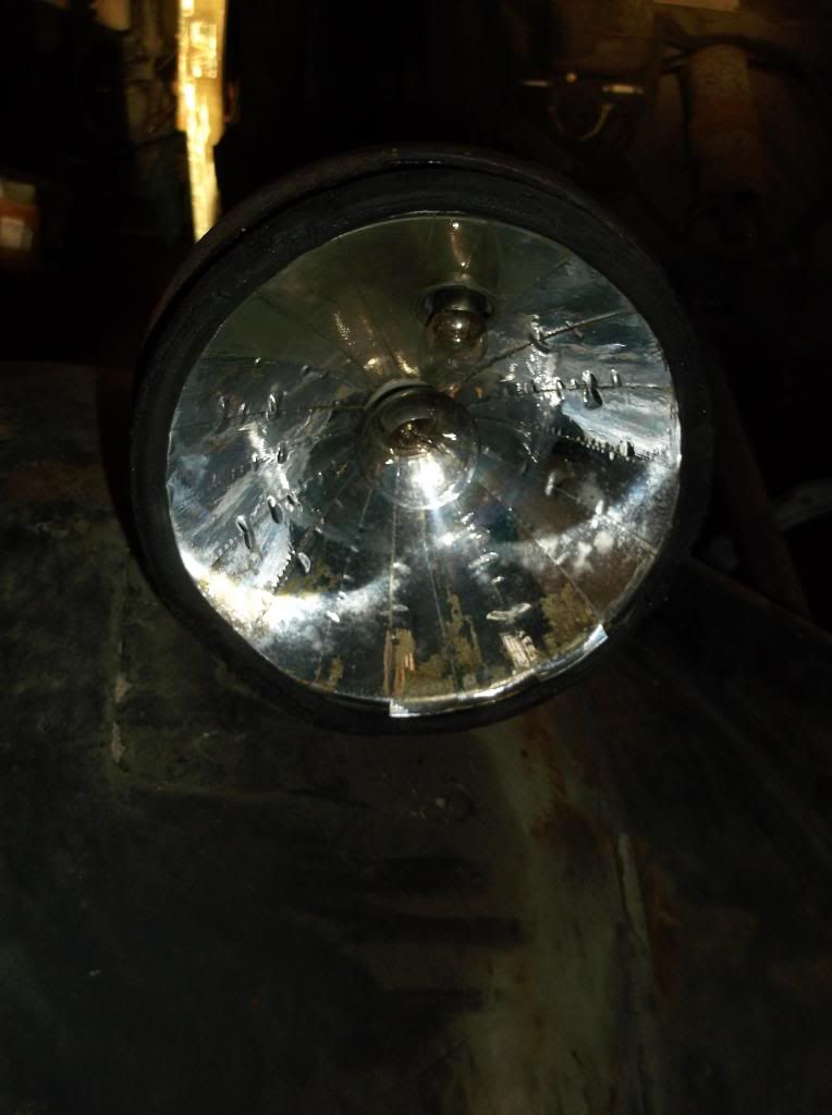

There has been modifcations to the headlights with a sidelight being put into the lightbowl. Or is this how they would have been originally, As I think there is a S - side and H - Headlamp position on the ignition switch. There are also rusty/dent holes where a sidelight may have been put on the front wings? Would they have side lights like a pre war?
