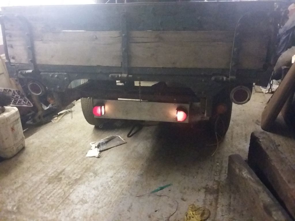

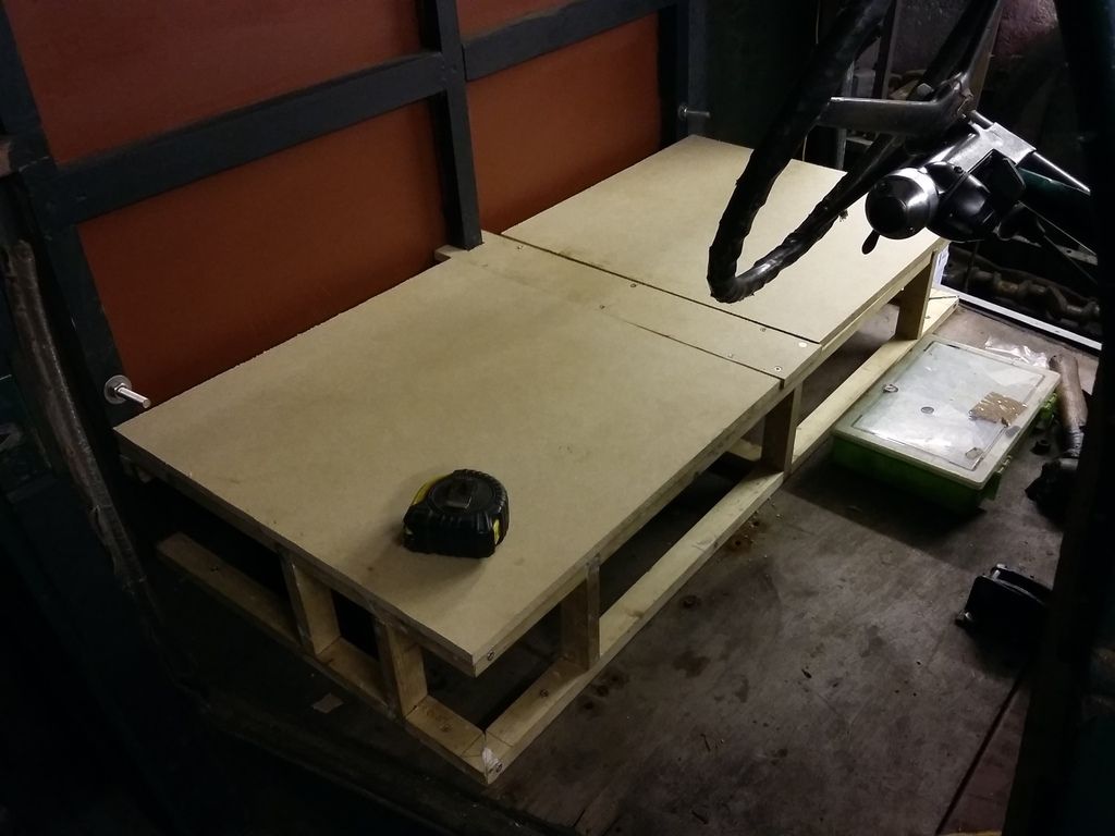

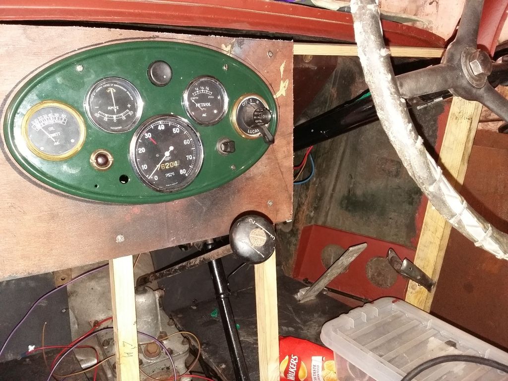

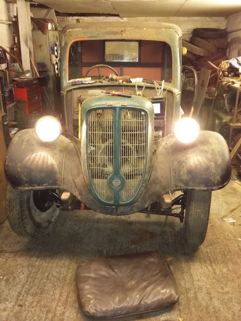

Well after a little under two years since posting here perhaps its time I posted a little update.
Work on the Tramp had slowed down to an almost stop over the past couple of years, having been busy with car shows with The Lady (1934 Long Saloon) dancing, and just general lack on interest. Not much progress has been made. But having got back from a holiday back in October i decided it was time to pull my finger out and get back on with it! So over the past few months I have been getting stuck back into it, making things, wiring up things and just generally putting more things back together so here are a few photos of progress.
Let there be light!

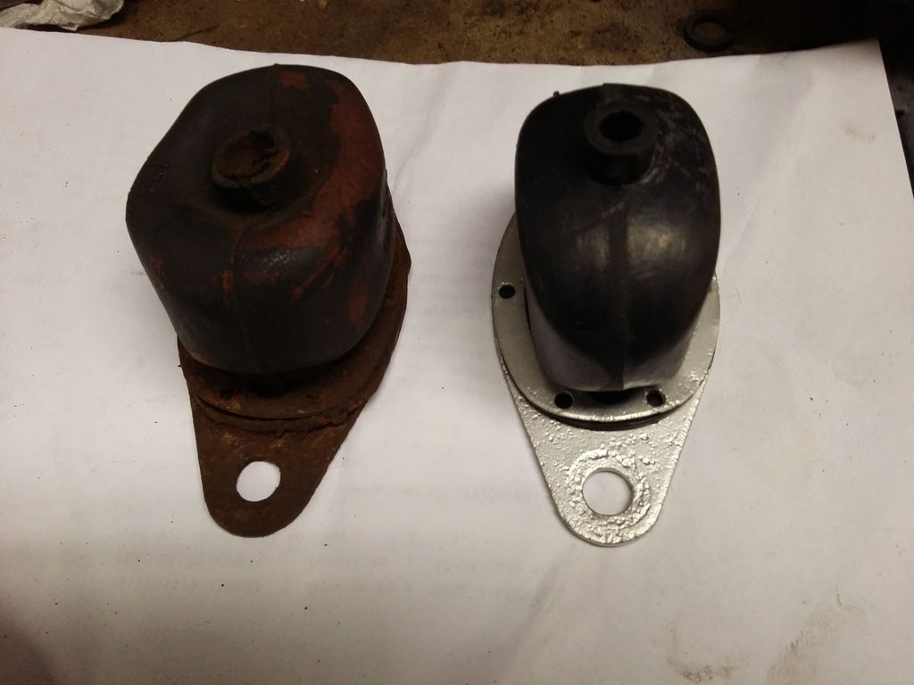

A few photos of updates after a busy few months of pulling my finger out & getting on with things
