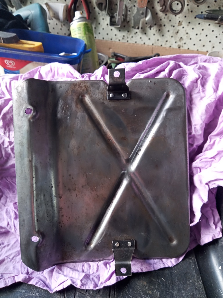

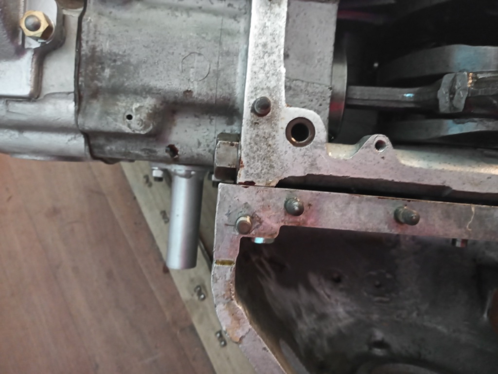

Good morning, is the windage tray held down with bolts or studs?
Is the hole in the crankcase an oil return hole?
If so should it have a pipe?

David,
The windage tray is normally retained with ¼" bolts, typically with spring washers under the head.
The hole that I assume you are referring to has a steel insert and is a jigging feature used to accurately locate the crankcase on the milling machine during manufacture. It is a blind hole and can be ignored during any normal rebuild situation.

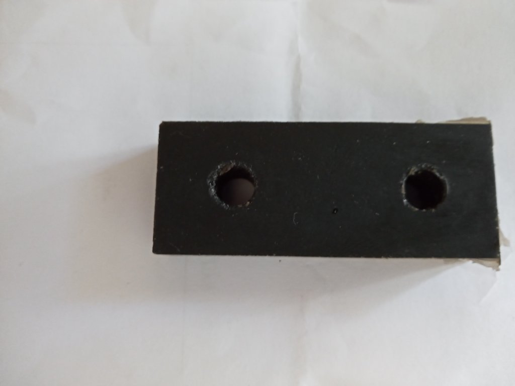

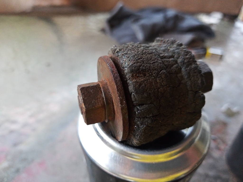

I dont have bolts for the radiator mount.
I am sure like most cars they would be shoulder bolts.
Can someone please give me the dimensions so i can make them
I do have the rubber's.

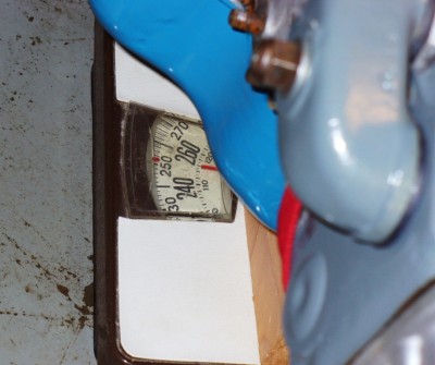

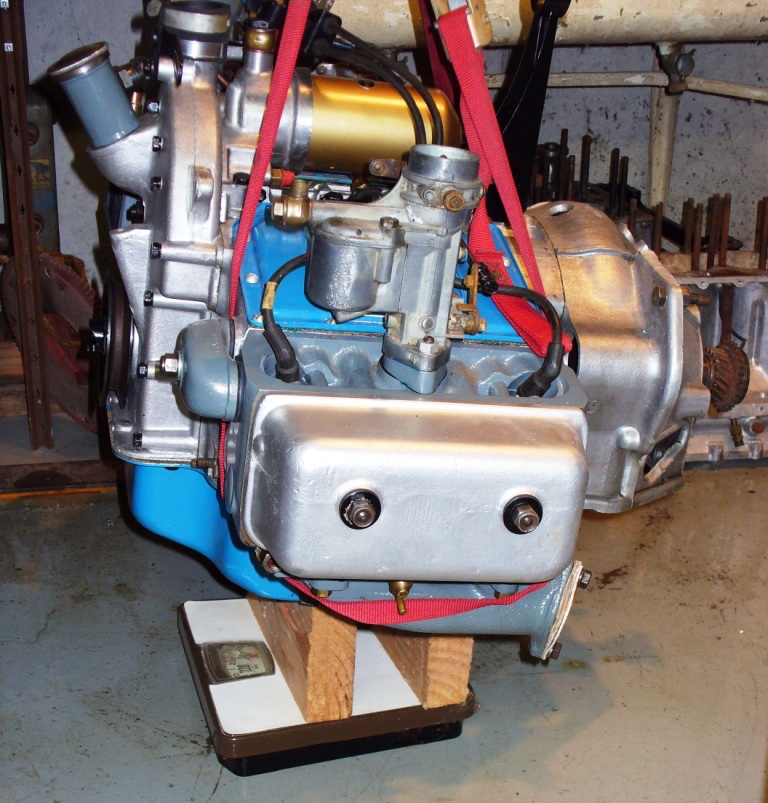

Any one know the weight of a jupiter engine & gearbox?
- Posts: 351
- Given Name: Philip
David,
The weight of the complete engine less the water pump, the dynamo, and the starter (which you can weigh separately and add on) is 250 lb. I don't have the weight for the gearbox.
- Posts: 547
While a long shoulder would be optimum, I can't recall any of the cars I have worked on using anything exotic.David Kemp wrote: ↑Fri Feb 18, 2022 11:33 pm I dont have bolts for the radiator mount.

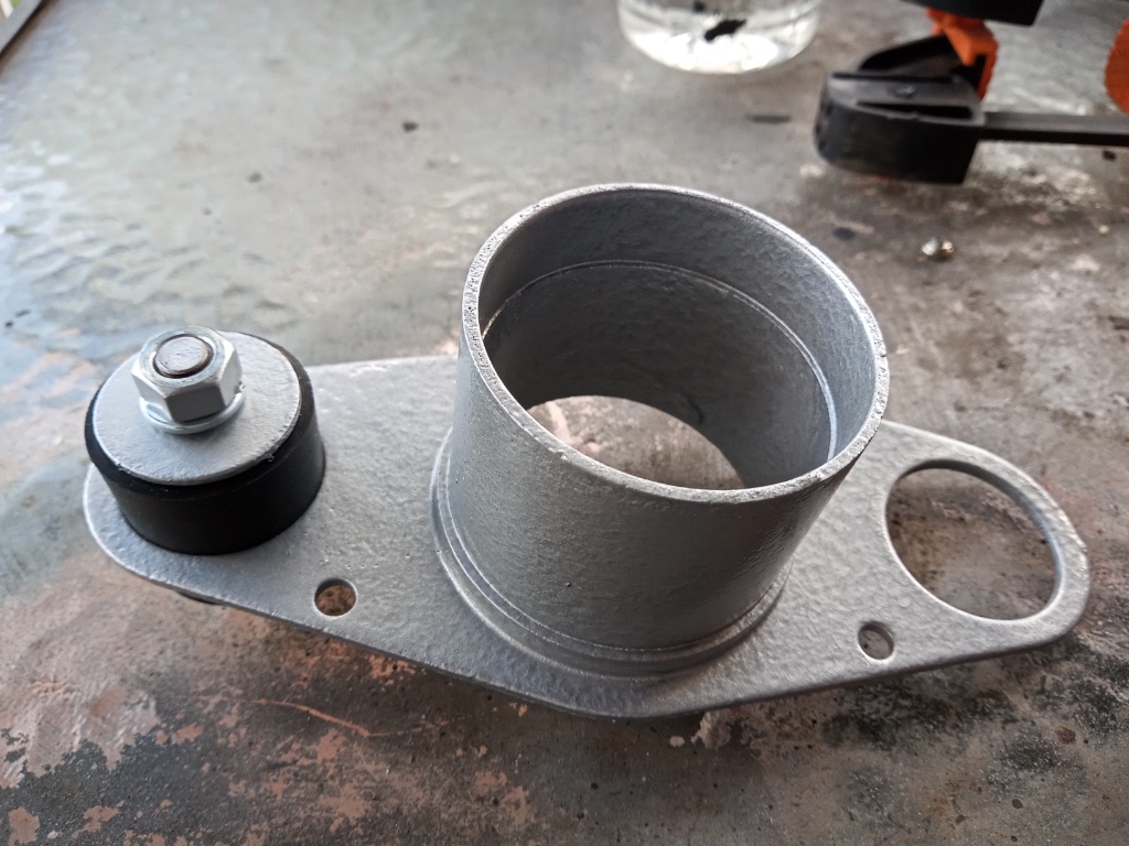

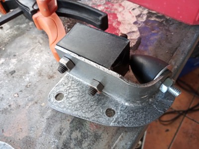

I have done very little to my car as I have been helping my son finish his.
We put an engine & trans in his Mini only to find the trans does not work. Result we removed it & are now fitting his original engine which ran fine.
So the little I have done is buy new midship mounts , clean the fittings & paint.
These midship mounts seem an odd design to me.

The mis-ship mounts look correct to me. The engine mounting is a Javelin one.
Paul Beaumont
They look correct but the rubber needs to be of the correct specification to reduce vibration.
