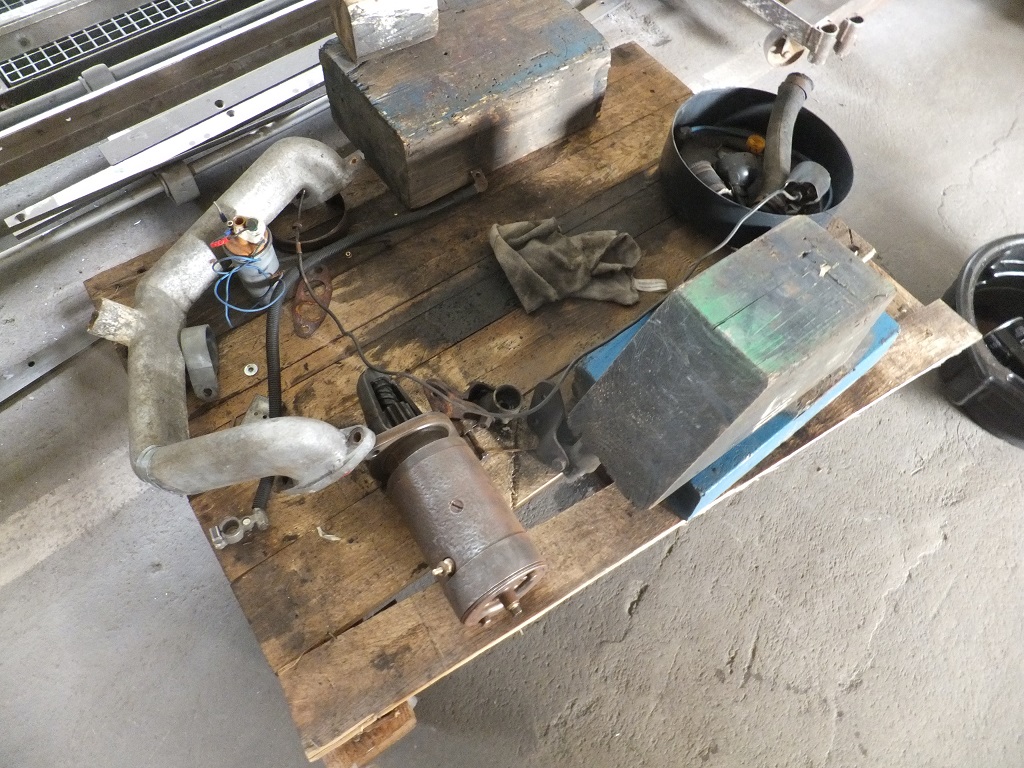

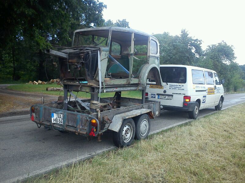

Hello Jowett Colleagues,
here a few Pictures from the my Jowett:
this Picture show the transport

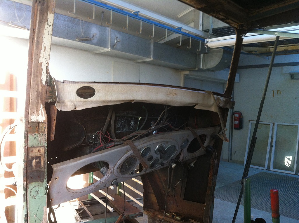

Re: 1936 Jowett in Germany restore

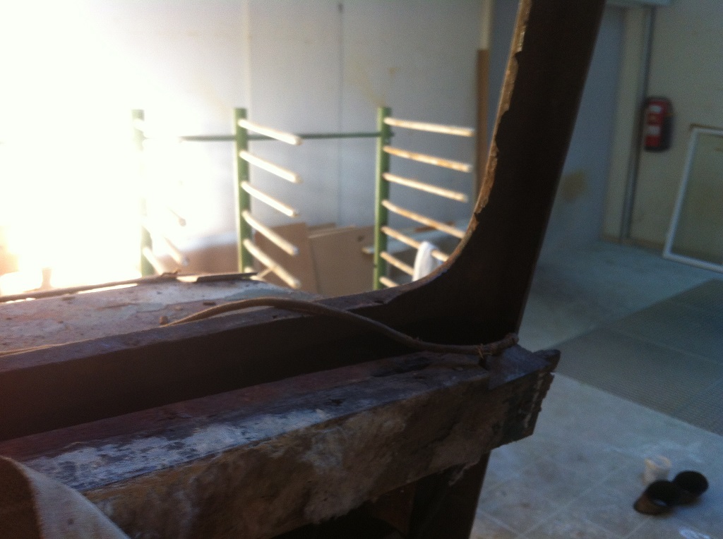

the Jowett in cabinetmakers repair shop:

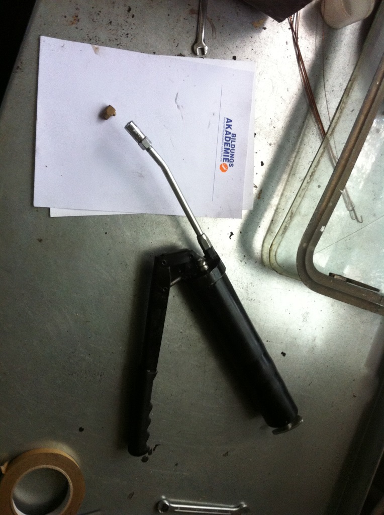

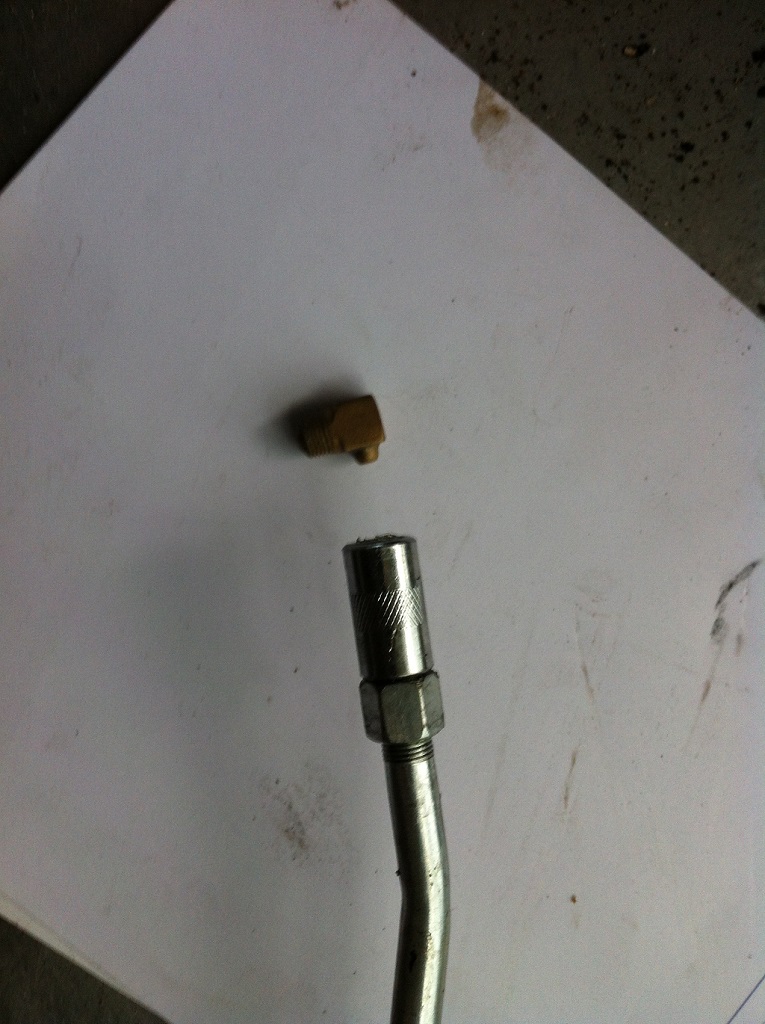

There is a lubrication nipple:
my grease press isn´t right for this nipple,
where can I get a suitable for this?
Marcel: -
What you have there is a 'push' type grease nipple and a 'hydraulic' type grease gun. As you already know - they don't fit!
You need either a 'push type' grease gun ( preferably so that you can use all the existing nipples. That would also be in keeping with the history of the car).
Alternatively you could replace ALL the grease nipples with modern hydraulic types. These were a much later development and are not consistent with the age of the car - but they do work much better!
The correct 'push' type greae gun is still available from Tecalemit in the UK for about £14.
Alternatively watch your local car boot stalls and autojumbles!
Happy hunting!
Happy hunting!

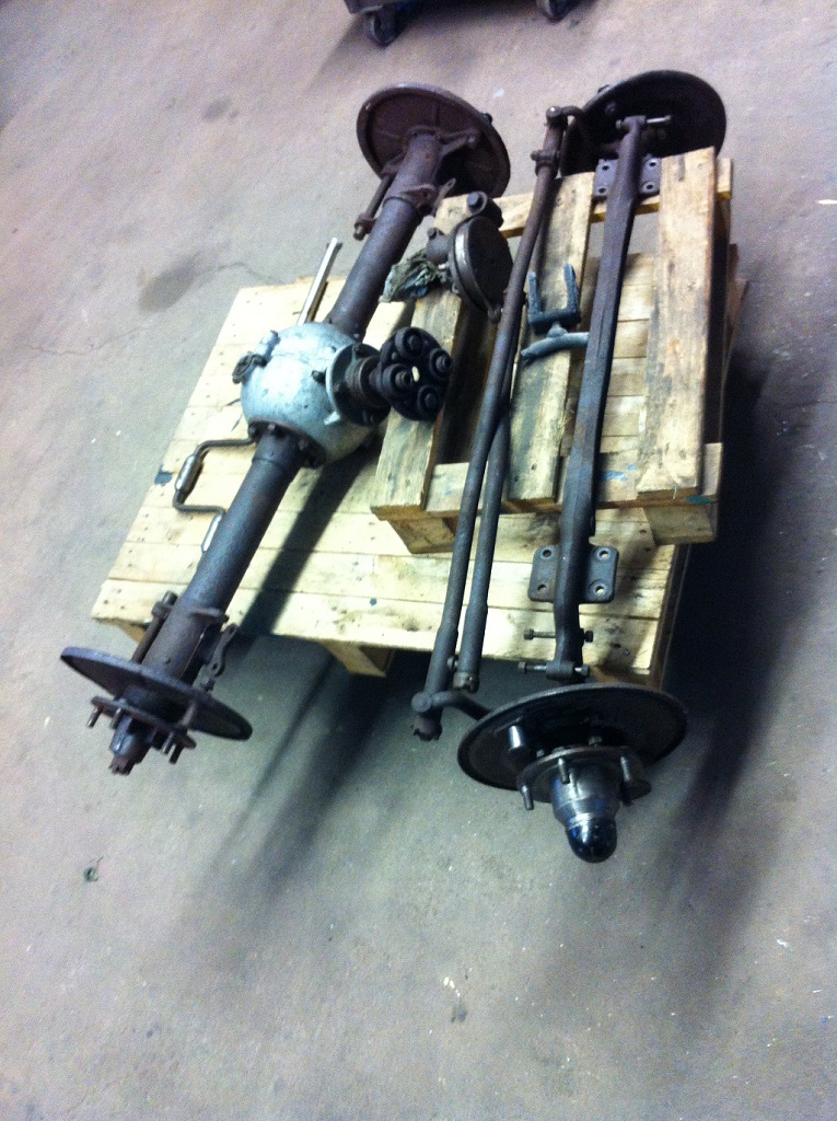

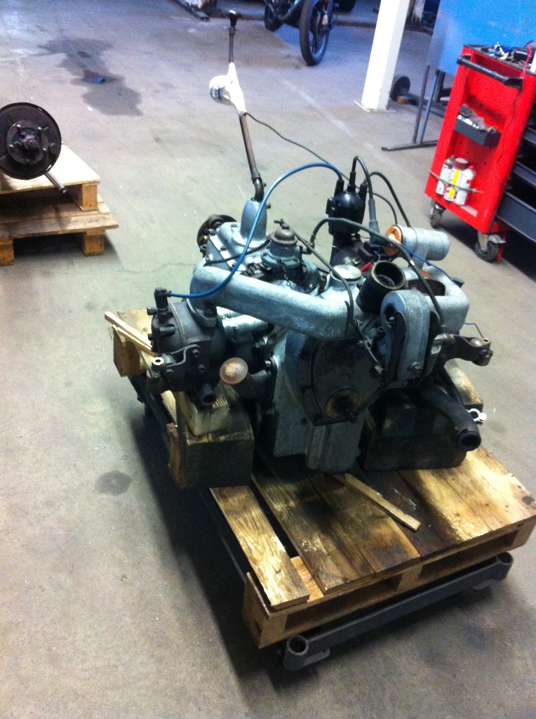

Oh, thank you!
I have looked in the garage and i found a compatible grease gun!
I grease all nipples on front axle, to see, what bearing bushes I have to replace.
all bushes from break leverage must be replace, all other bushes are ok.

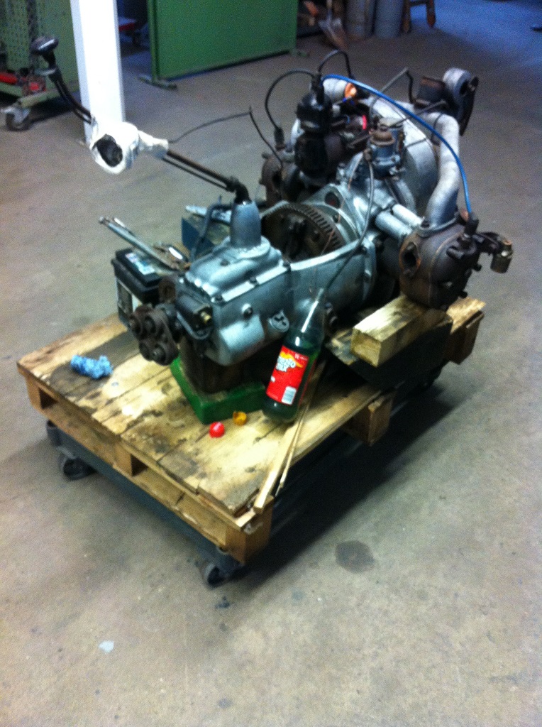

the next step was going to a specialist and bring engine and both axials to ´dry ice´ , the things are very clean
you can see it
today I started the engine, it was great. to see and hear that.
you can see it
proof positive of the efficacy of ''balanced power'' assuming it didn't jump off the pallet while running!

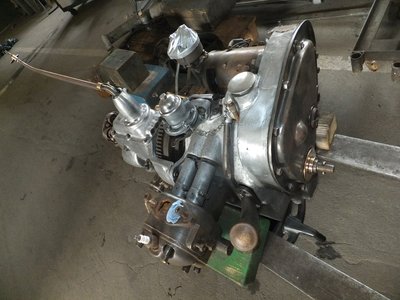

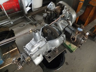

Hello,
on weekend I degraded and cleaned a part from my Jowett engine, still the bottom side must be clean.
Here a few pictures for you:

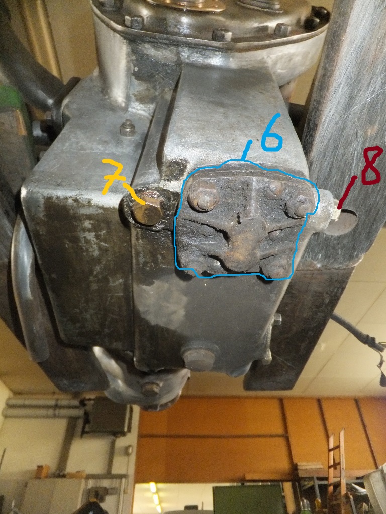

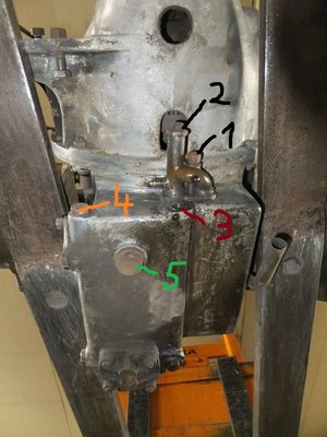

Please, can anybody help me wherefore all those screws are?
1:
2:
3:
4:
5:
6:
7:
8:
Thank you!, I think that do you know in sleep...
Kind Regards Marcel K.
