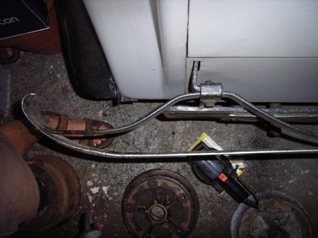

I've often wondered, why there are on both sides holder.
Can anybody say, for what they are intended?
Was that original?
Here a picture, you can see, what I mean:
Was that original?
Peter Holden
- Posts: 140
- Joined: Tue Sep 02, 2008 7:45 pm
Re: 1936 Jowett in Germany restore
Marcel
There are original
There are two L shaped brackets that bolt to these that support the rear bumper.
I have tried to put in an image but this system is not resopnding. I will Email them
There are original

Okay, thank you Peter!!
I don´t know, how Looks my car in ihr heck, orginally...
but I have a presentation, how my car will look in heck!
It will be a own creation!
Greetings
Greetings

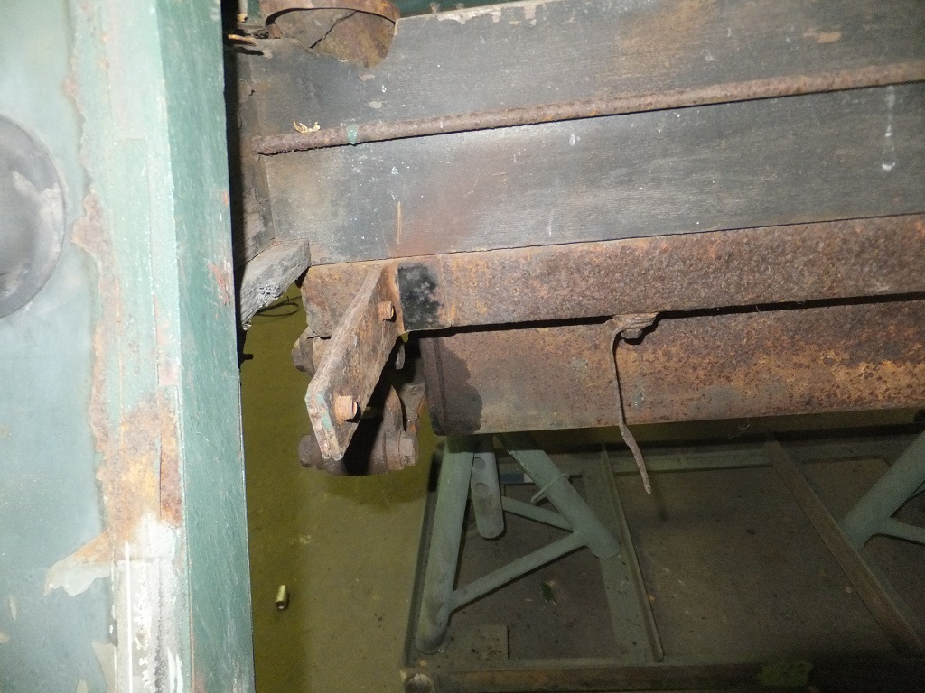

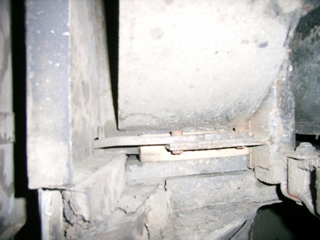

Pictures at Last
The second one is from under the car

Hello peter,
Thank you for showing the potos!
The last photo, you can see the spare wheel well?
Is that right?
Reguards marcel
Is that right?
Reguards marcel
Peter Holden
- Posts: 140
Correct. That is the spare wheel well. But for the Kestrel.
You have a Falcon, therefore the spare wheel is mounted externally and NOT within a compartment as the photo shows. Therefore you do not have the curved well as shown.
In photo 1 you can see the spare wheel cover. It is part of the body work.
Photo 2 is from the underside, as you have worked out

Peter Holden
- Posts: 140
Refer to my post on this thread on page dated 18th July 2012
The to picture is a Kestrel/Cerlew - note the spare wheel is within the boot and not visable
The second picture is a Falcon - note the spare wheel is on the outside

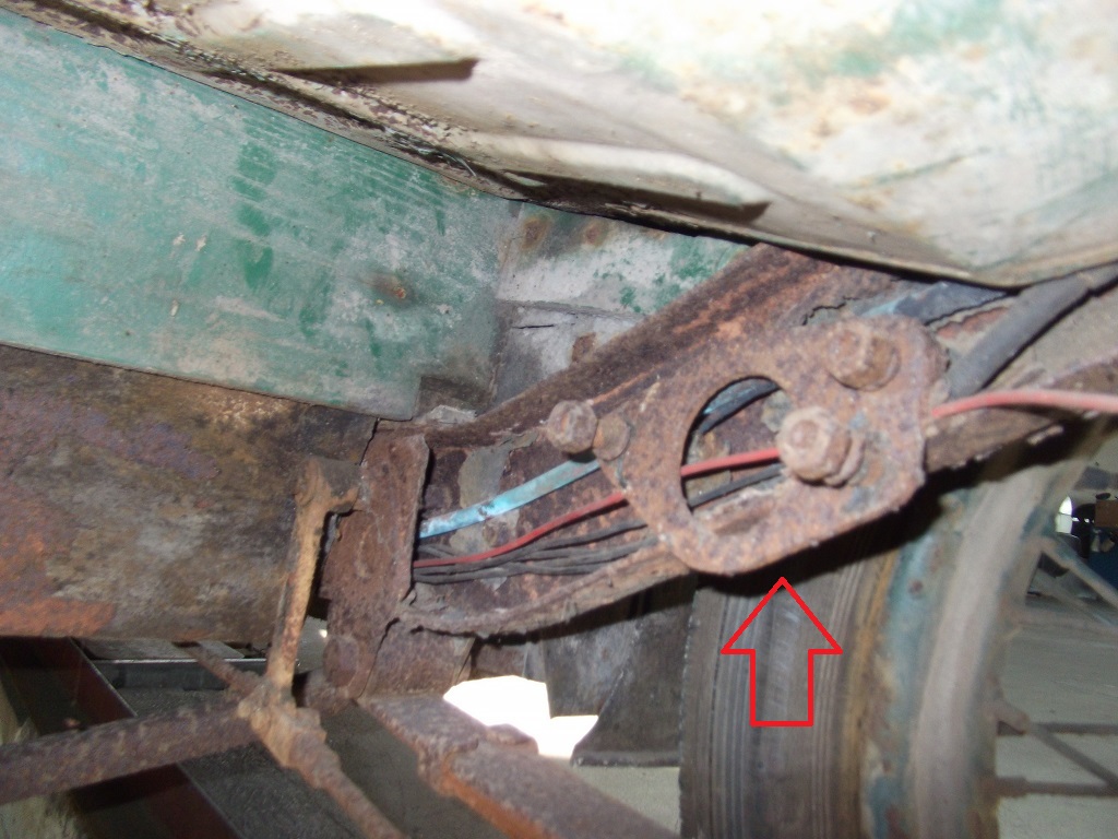

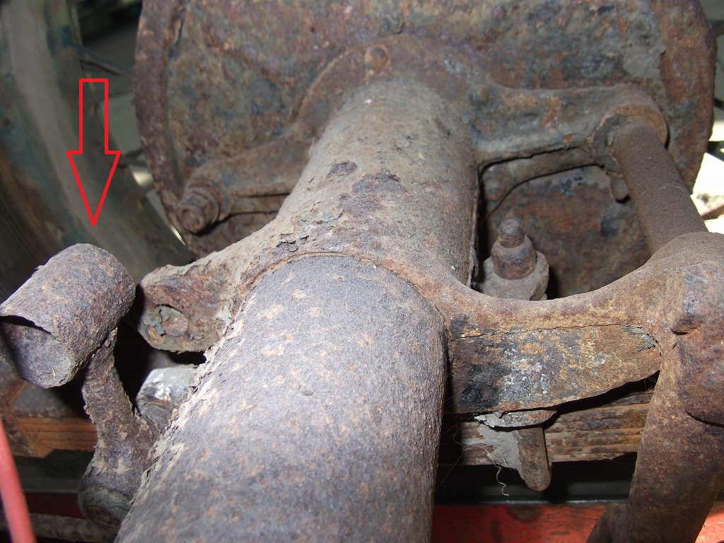

I don´t know, what diese components means. Is there a art shock Absorber?
Here you can see pictures about my frame.
Has anybody a picture from this area of Jowett who is complete?
Thany you,
Kind reguards
Thany you,
Kind reguards
- Posts: 480
- Location: Cornwall
You only have the remains of the shock absorber which should be bolted to the chassis and connect to the linkage in the second picture. These should be 'Luvax' type shocks - are any present on your car?
