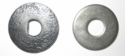

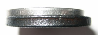

I had a good chat with Drummond on the phone who explained some of the finer points of the late type suspension.
He kindly offered to send me a set of secondhand anti rotation washers. Now I have them I can see that they're fairly substantial. I mananged to find some M10x30mm washers on eBay which are 2.5mm thick. Although they are a reasonable match for OD and hole diameter they look a little on the thin side.
I guess at a push they could be used to make new anti rotation washers but as Drummond has sent me a set I'll use the secondhand ones.
