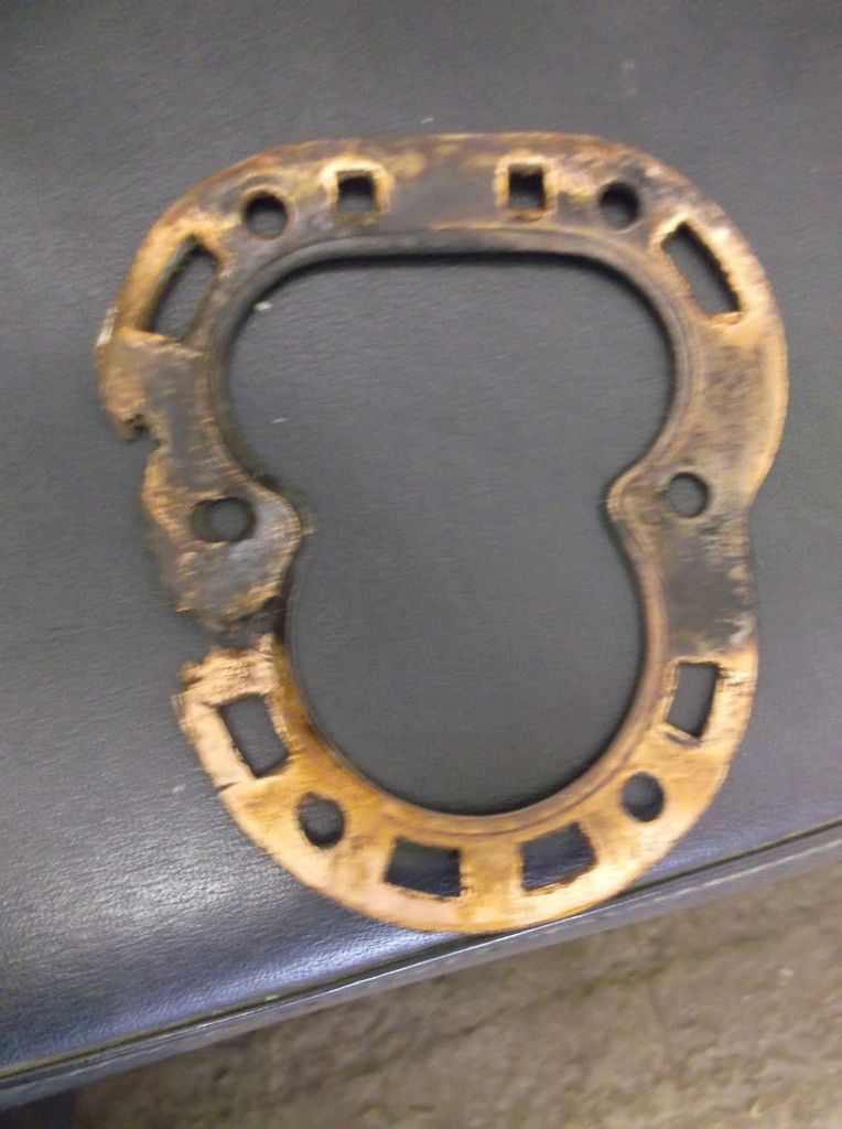

Hopefully two photos of the one of the gasket I changed last year on the same side, how it had been eaten away around the edges.

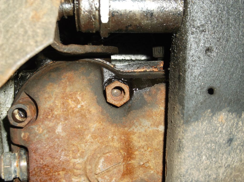

And one of the current gasket still in situ with the copper piece seemingly pushed out.

Yeah every time the gasket goes on this side it does go on the exhaust side. The top picture I posted is a bit back to front. Where it has been sort chewed away is on the exhaust side of the engine.
