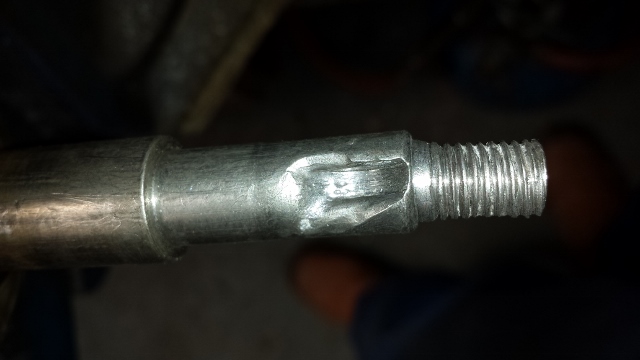

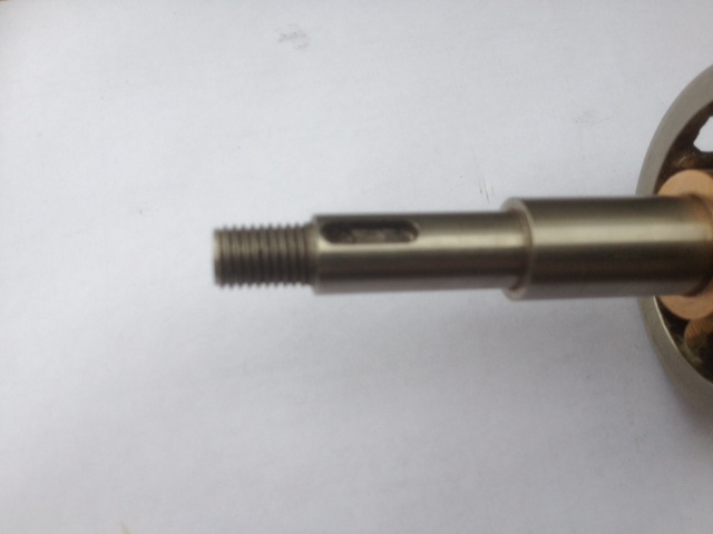

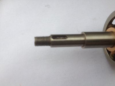

On Saturday I took out the water pump of the SC to repair the keyway that had worn. During removal I found the fan support was fractured and the thermostat had found its way up into the rubber pipe and was broken. Also the bearing had not been located with a circlip. OK the bearing had not moved and may have been as desired by the rebuilder, but I was not happy and have fitted a circlip. The casing also required a new helicoil as on removing the bolt the helicoil came out.

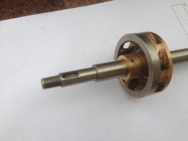

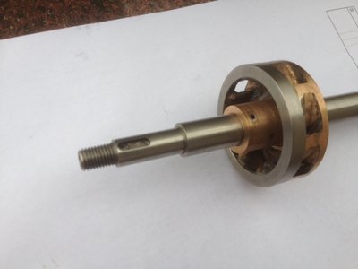

I first tried welding up the very worn slot, turned it down in the lathe and then tried milling out the slot. But the metal was too hard so I turned the shaft and milled out a new slot.
This pump had a sealed bearing and thus did not have the bearing cover or felt fitted. I am convinced the keyway issue was caused by the pulley not being tight on the bearing causing all the rotation force being taken by the keyway. Thus I am making sure the pulley clamps to the bearing and will add plastic metal to be absolutely sure the pulley and keyway cannot move. IMHO this should be a taper fit or at the very least the pulley should have a steel boss into which the keyway can locate. The small keyway face into aly is not enough to hold so much torque.

It is imperative that a spacer / modified washer if fitted when using a sealed bearing. The build dimensions are critical to ensure the pulley clamps tightly against the spacer and bearing inner race.
All my pumps now have a modified keyway which is a vast improvement over the woodruff key.
Re: Water pumps and pulleys
I also suspect the new shaft made during reconditioning was perhaps not hard enough to hold the keyway. Should the shaft be hardened ?

No need. Use a good quality Stainless Steel shaft. I would not use a woodruff cutter to form the keyway. Better to use a 3.5 mm ( or smaller ) End mill and form a 4mm wide slot 2 mm deep to accept a 4 mm square piece of key steel.. You then need to enlarge the slot in the pulley to take the 4 mm key. Do this in the lathe with the chuck locked and use a 4mm wide chisel tool.
Completed over 1 dozen now with no issues.

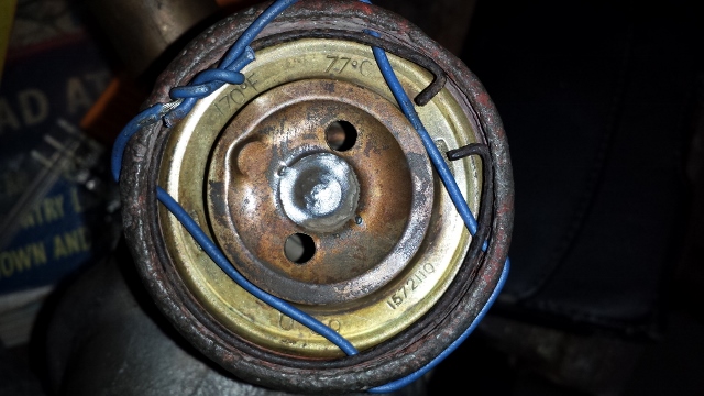

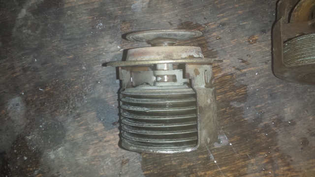

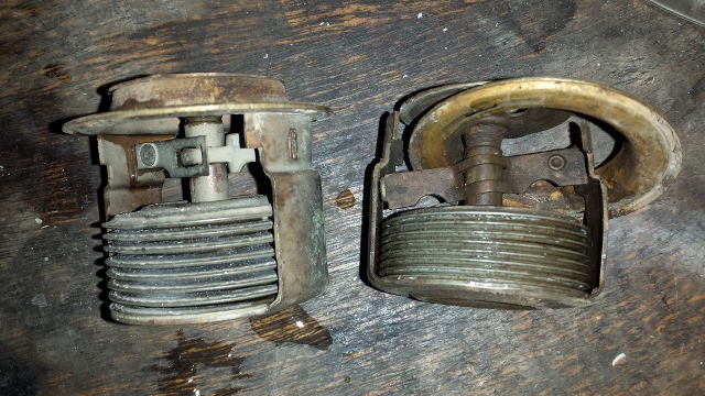

The SC also had a broken thermostat which is not something I have experienced before. Whether this was caused by the boiling water and water pump failure we will never know. The SC resolutely refuses to get hot normally. After installing this new stat a road test and the temperature measuring gun proved the stat remained closed even after a fairly spirited run on a warm day. The heads remain at about 70C with the header tank and rad sitting at 41C. Perhaps more investigation is needed....closing the heater valve off perhaps. :lol:

It had also found its way up the pipe so as well as the circlip I fitted a wire restrainer dispensing with the stainless steel washer.
Thermostats come in different temperatures, my collection has from 70 to 85 deg C. Ben Shaw use to prefer the higher value claiming it gave a more efficient engine. I chose the 77.
Note I checked it opened by putting in near boiling water.
