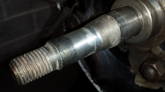

Inspection of the Jav front brakes showed oil/grease to have found its way to the shoes. The other side was fitted with sealed for life and hence no grease. I had done this as a test fitting new to both sides but one set sealed and one normal. I suspect the oil may have found its way through the corner spaceras the back of it was filled with oil and there was a dribble down the backplate. If I was going to use grease in the front again I would seal the corner spacer with silicone.
There was also some wear on the stub axle which will need some attention.

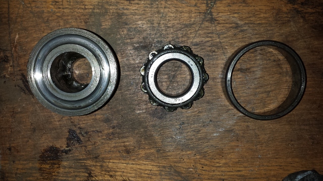

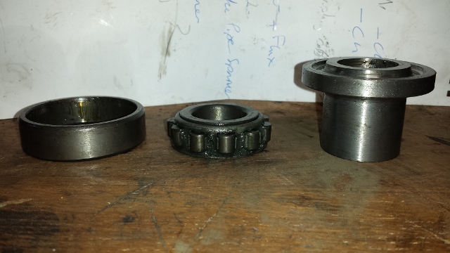

Well now I am confused. At some stage the drum on front wheel of the Jav must have been changed, as it contains a roller bearing that I have never (knowingly) put on the car. Indeed, on examination, it is a roller and not taper roller so I am worried that all the sideways forces have been taken by the outer bearing. See pictures below. The non standard spacer would bear down on both the inner and outer race, which would cause metal to metal contact with an outwards sideways force. If the sideways force was inwards, the outer race would bear on the oil seal which would then ride over the corner spacer. All the sideways force in both cases being borne by the outer bearing's cage.
I am extremely glad I noticed some lateral movement and chose to investigate. Where did this drum come from?
This also explains why the grease may have got to the shoes because the oil seal was hard. I am fairly sure the oil seals on this car were changed within the last 5 years.
I should have rotated the picture above 180deg so that the items were above each other.
Below the spacer is on the right , the outer race on the left and the inner race and cage of rollers in the centre. The picture below shows some silver solder applied to the worn shaft, perhaps caused by the roller mod but more likely the 500,000 miles this car has done?

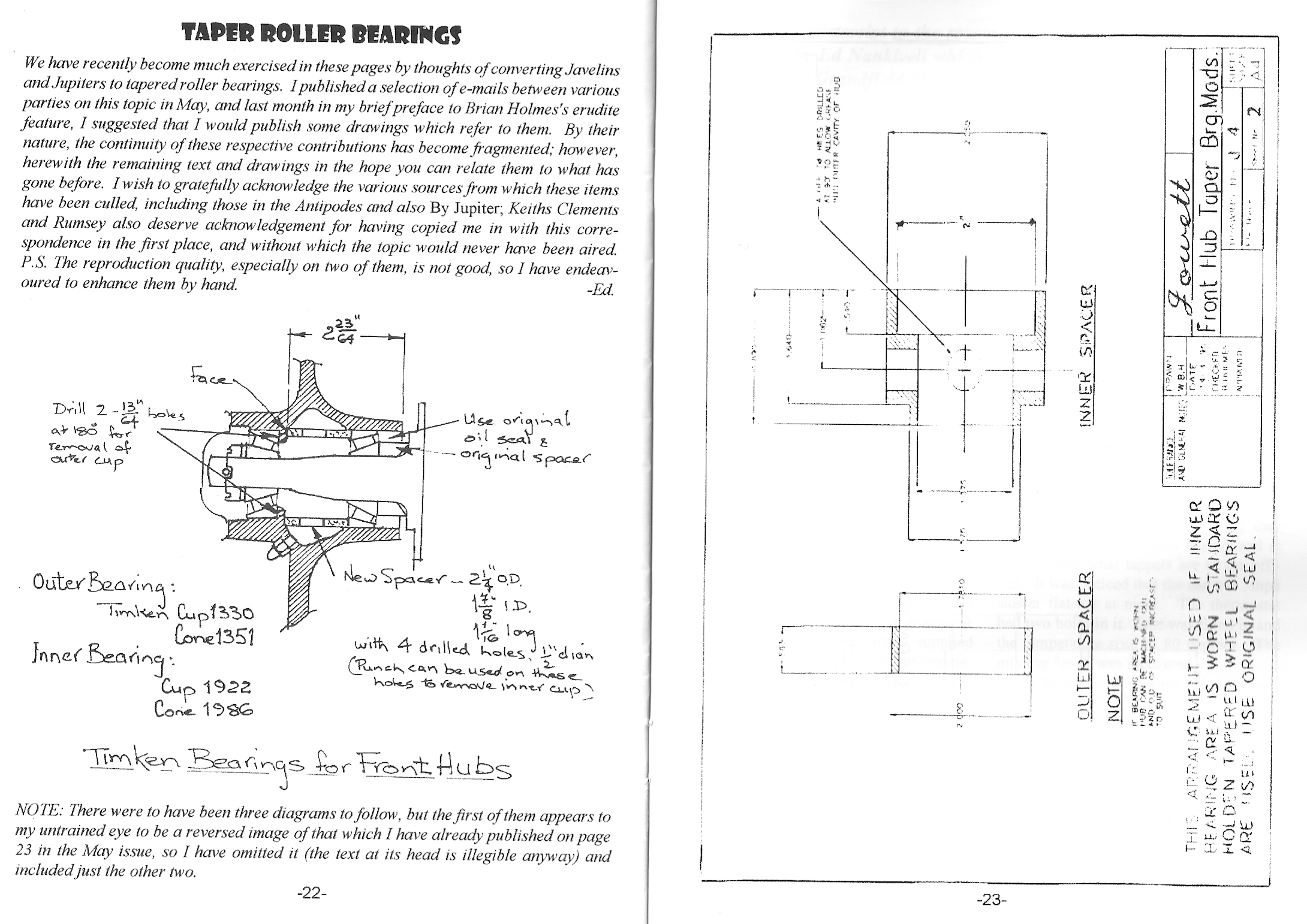

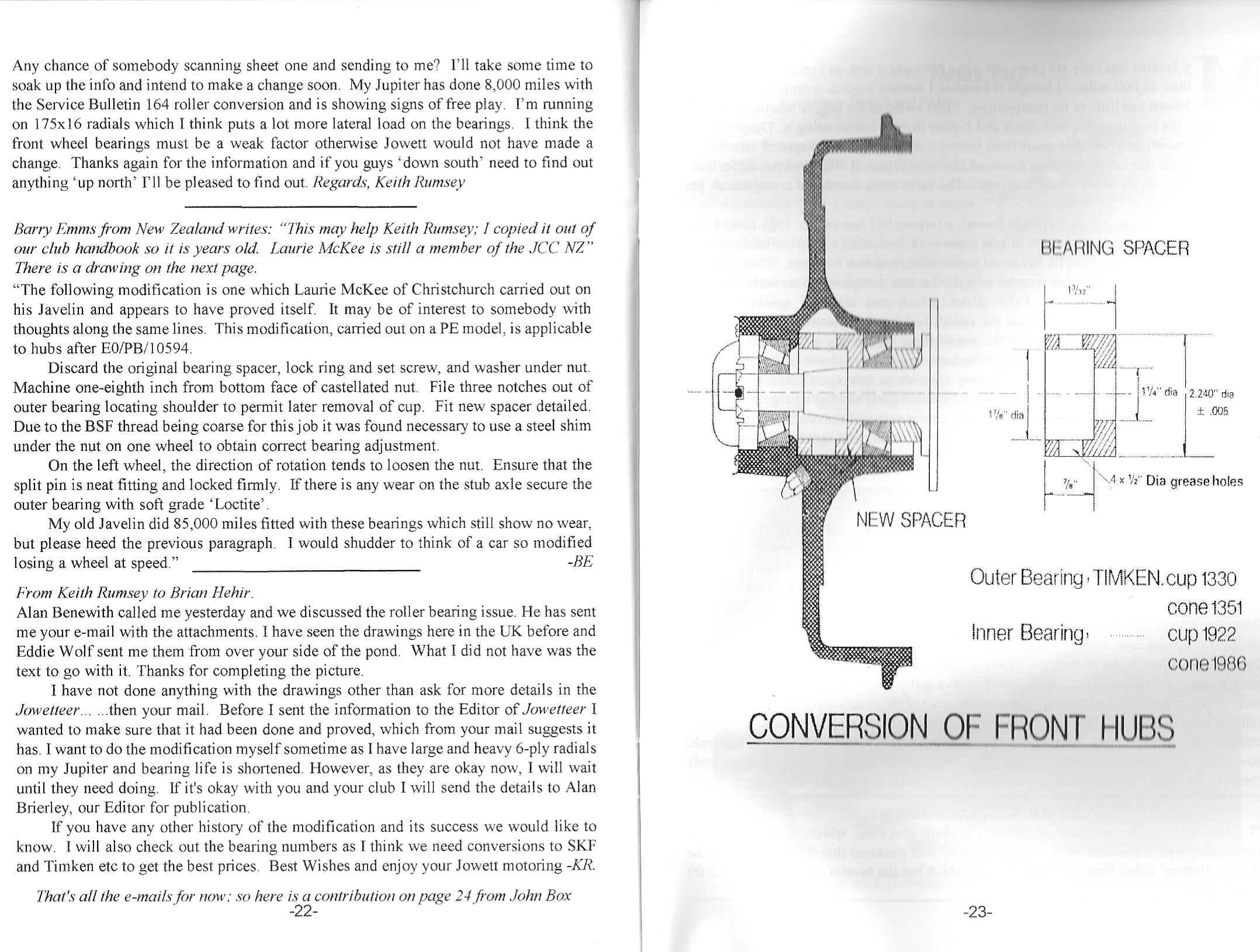

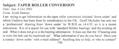

After examination of the drum I am fairly sure this was originally fitted to the car (as it has the same paint on it). So my assertion that the drum had been changed, and that I had fitted new bearings at some stage are both wrong. It must have been a mod that the previous owner, Ben Shaw, was trying out . It cannot have been that bad a mod as it has lasted at least 20 years. But I am still not happy with it, so the drum will be converted back with standard bearings (albeit sealed for life) and a standard spacer.
I would think if we went back through the 1960's Jowetteers we would find details on this mod written by Ben.
Here is the entry in the index for a later mod for a taper roller where I am acknowledged as contributing.
Taper Roller Bearings 2003 Sep Page 22 The scan is perfect, it is the original which is illegible. If anyone has the original technical drawing it would be great to get it into the Gallery.
Double click on image and expand to get great detail.
