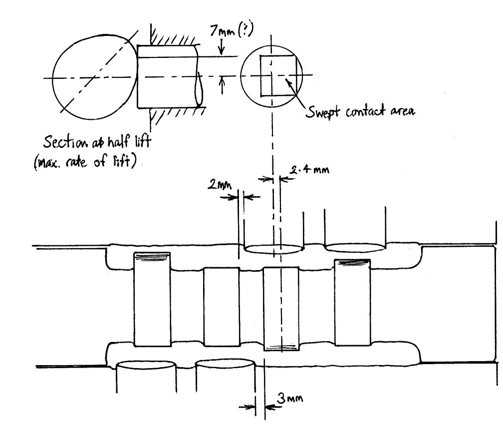

Diagram from Randal.
The 7mm dimension I think was meant to represent the maximum excursion of the cam on the follower.
But I think the diagram is incorrect as this will occur at the top of the cam when it first contacts the follower and will also be the farthest point when it eventually just leaves the follower.
As the point of the cam wears, less of the follower is swept. When round there is no sweeping except due to the offset between the centre lines and the turning of the follower.
The turning of the follower is induced by the sweeping of the cam being more across one half of the diameter of contact than the other. Thus causing a turning moment of force on the follower due to the friction between the surfaces. This would happen if both the surfaces were flat and parallel.
As can be seen from the diagram the swept area would contact the edges of the follower unless the follower was ground slightly convex . The convex grind leaves a gap at the circumference thus saving the edge from destruction. I think this convex grind will also create a curved motion at the contact patch as the swept arc rides up the convex shape and down the other side. But this would be in conjunction with the turning of the follower and slippage at the contact point, but the motion would be constrained by the camshaft end-float. The convex shape would also accelerate the tappet as the lobe rode up the convex hill.
I have been assuming here that the centre line of the follower does pass through the centre line of the cam. If not more geometry is called for!

Thanks for posting the diagram, Keith. It may have been my use of a degree symbol in the text that prevented me from posting it myself. As you suggested, the diagram would have helped a lot with the first post and it might have helped me avoid the error (subsequently corrected) where I claimed the camshaft lobes would need to be displaced axially by 7mm to hit the wrong tappet, rather than just 2mm. (I was looking at just one half of the crankcase.) But the essential point remains, i.e. that an overly wide lobe is likely to produce damage by running off the edge of its intended tappet rather than hitting the wrong one.
Yes, the 7mm in the diagram represents the maximum excursion of the contact line away from the plane of the tappet axes. (And yes, it is safe to assume that the camshaft axis also lies in that plane.) But I firmly believe that the contact line will only move progressively up from the middle of the tappet as it is accelerated, returning to the middle at full lift and then onto the lower half of the tappet as the valve is lowered. We are talking here about the tappets of the left bank, cylinders 1 and 3. The only mistake that I will admit to in the diagram is that I should have shown the cam rotated slightly further clockwise for the maximum rate of lift. (For a cam duration of 180 + 65 = 245 crankshaft degrees, the lifting of the valve takes place over 61 camshaft degrees and the maximum rate of lift would be when the cam lobe is only 30 degrees from horizontal in the diagram above.)
It is true that relieving the rim of the face of the tappet would protect it against damage, for a while at least; I will probably adopt this measure when I come to reassemble my engine. Doming the whole tappet is another matter: this would put the centre of pressure in the middle of the tappet (in the fore-and-aft direction, that is) and might prevent it from rotating. There would still be some viscous drag from the oil that might be sufficient to rotate the tappet, but I wouldn't want to rely on it.

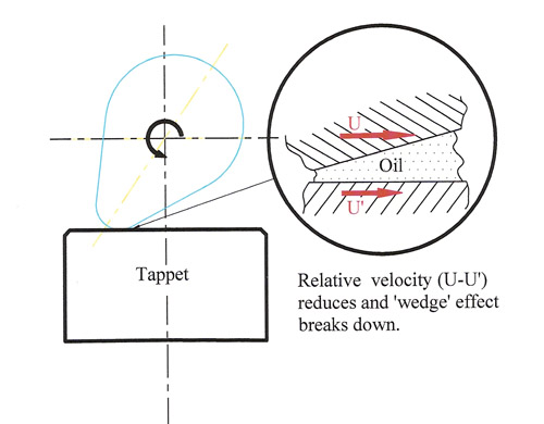

Another article explains how the critical time is where the cam lobe reverses relative direction as it goes over its high point thus loosing the wedge of oil lubricant. This is where ZDDP is so effective. But it also warns the oil temp needs to be above 60deg C to be effective.
Of all the components in an engine, the cam - flat tappet interface, whether in the form of the direct acting mechanical bucket in overhead cam engines or to a slightly lesser extent mushroom tappets in pushrod engines, is that most at risk. In these circumstances the oil entrainment velocity, the relative velocity of the cam-tappet contact point on the tappet with respect to the velocity of that point on the cam, drops to zero and then reverses at slow speed. If this relative velocity is insufficient to generate a ‘wedge’ of oil between the two, then these surfaces will rely on the presence of the highly polar ZDDP molecules to keep the surfaces apart and protect them.

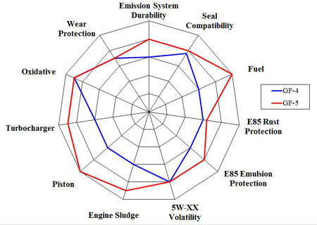

To carry the story on further this article explains some of the complexities of legislation and oil, summarized in this diagram.
