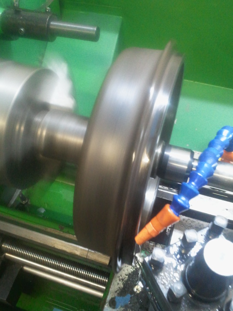

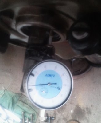

Anyhow, on loosening the other backplate I had some end float and found there were no shims on that side. So I set up a dial gauge on one side and added slivers of shim on the other side until the desired 3-6 thou movement was obtained. Then I cut out 4 shims (24 thou) from some sheet and fitted them with some sealer in between each. On refitting the hub it rubbed slightly on the back plate so I set up the lathe and took material off the edge. It now does not rub. It had been doing this prior to the shimming anyway. This rubbing I think is caused by wear on the taper through not having a grease free and very tight fit. It is possible that a replacement drum was fitted at some stage in the distant past. I did check the back plate for distortion and will perform further run out checks today. The manual does say to fit paper gaskets to stop oil leaks but I used sealer in this case on all joints. If the paper gaskets were before the thick bearing retainer then that might make a difference to the end float or, if between retainer and back plate, to the rubbing of the drum. But it should be neither and should be fitted between oil seal and back plate.

Before measuring the endfloat, tap the half-shaft inwards with a mallet - then pull it out again by hand and attach a dial test indicator (DTI) to measure the end float. Now do the same at the other side to double check (should give the same reading as before). The shim thicknesses should be as equal as possible from one side to the other, and chosen to give a total end-float reading of .006" to .008". Failing to use the 'mallet-method' may result in the end float on one side appearing to be different from the other.
