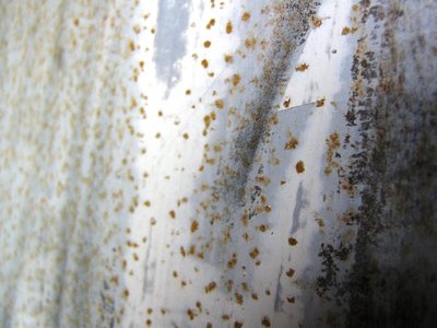

I'm in the middle of using Nitromors to remove the cellulose paint from the rear half of 'Mary Ellen'. She's suffering from micro-blistering of the paint work, both on the steel panels below the waistline, and the aluminium panels around the rear and back windows above the waistline.
I've only yet got down to the steel panels, but there are myriads of tiny rust spots showing up after removing the cellulose base coat. I realise that these will have to be sorted out, but perhaps Chris can reply with the best way to go on from now.
I have already bought etch primer, high-build cellulose undercoat and the top black cellulose finishing coat, but would rather know how to sort the rust problem out before I spend time spraying all this.
The last time I sprayed the car was in 1980, so the cellulose has lasted quite well over the last 30-odd years. Prior to that my mum and I hand painted it with Tekaloid enamel in the early 60's!!
I can take a photo of the problem if that will help Chris, (or anyone else that wishes to comment). I mention Chris because somewhere in the 'little grey cells' I remember he's been there, done that, and has offered his expertise within JowettTalk, which will benefit us all.
If the new paintwork lasts another 32 years, then I'll be getting a certificate from the Queen on March 11th of that year!!!

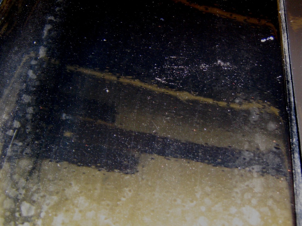

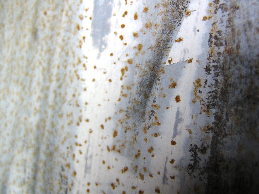

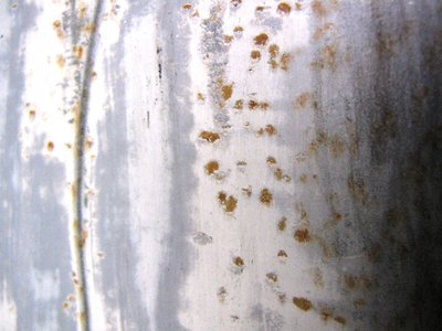

Hi Chris,
I've attached a rather indistinct photo of the scuttle paint (black cellulose, with fluorescent light reflections) which, with some imagination shows the micro-blistering. It feels like braille when you run your fingers over it.
The other photos are of panels stripped of the black cellulose and partially stripped of the primer/filler coats. Tony.

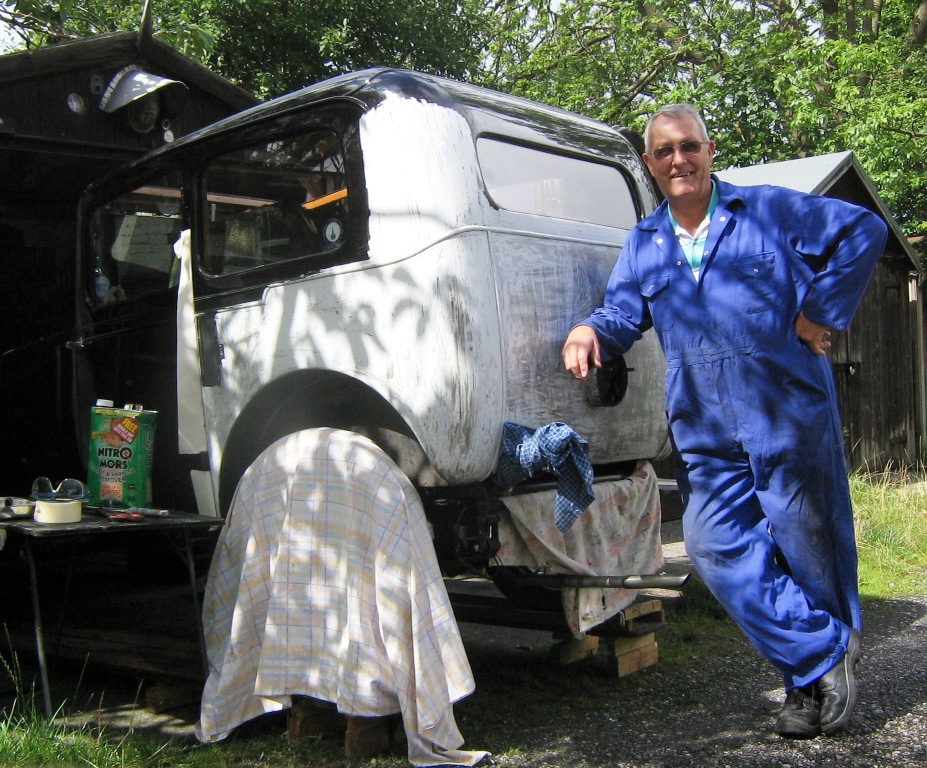

Thanks indeed Chris for the comprehensive and considered replies. Just what I needed.Chris wrote:The correct action has already commenced - although drastic - the only way to resolve the issue is to bare metal the surface.
As you can see below, I'm "drastically resolving the issue".
Just a thought Chris, the aluminium panel won't need the de-ruster will it?

Hello Chris,
I managed to get all the paint off the steel panels with Nitromors and a lot of elbow grease before I went on holiday to Majorca, on 4th Sept., and I brush-painted the panels twice with Hydrate 80 as you suggested. It would have given a better finish to spray the anti-rust agent, but because I never got a lovely dry and sunny day, I did it panel by panel.
Unfortunately there are brush marks over all the panels, but with a bit of dry-flatting and lots of high-build primer as the next job, I'm hoping to get a reasonable finish prior to applying the top coats.
I've only been back a week, and weather-wise it hasn't been fit to do any more, so I'm glad the Hydrate 80 sealant is on. I'll probably have to wait now until May or so next year to carry on, unless we get a week's worth of an Indian Summer.
I've left the original primer on the aluminium until work starts again, although if I take it back to the metal it shouldn't pose too much of a problem over the winter.
Re: Micro-blistering of 30 year old cellulose on 'Mary Ellen
Hello again Chris.
I managed a bit more paint removal on the aluminium rear/upper body on Thursday as it was a bright but cold day up here in Lancashire. I have the necessary to etch prime it, but as it's still only about 5 Centigrade, and I have to spray outside, I thought I'd wait to start the spraying until it gets a bit warmer.
What's the minimum outside temperature I'll need to get a good finish, maybe only with the etch primer and the cellulose base coat? I thought of warming the paint pots in hot water to facilitate spraying, but then the spray would be going on to a cold metal surface, so I'm hanging fire.
I'll do the final colour coats in the early summer, after the petals of the cherry tree have all fallen off!!
