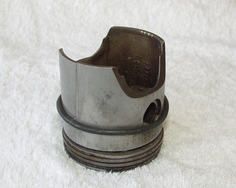

I thought I'd set the ball rolling with this tale of woe . . . or maybe it should be looked on as being a very lucky break* . . . .
The first image gives the impression of it merely being a picture of just a ordinary split skirt Javelin piston, without a oil ring and with a rubber "O" ring on the skirt . . . .
. . . and it is
Javelin piston with "O" ring

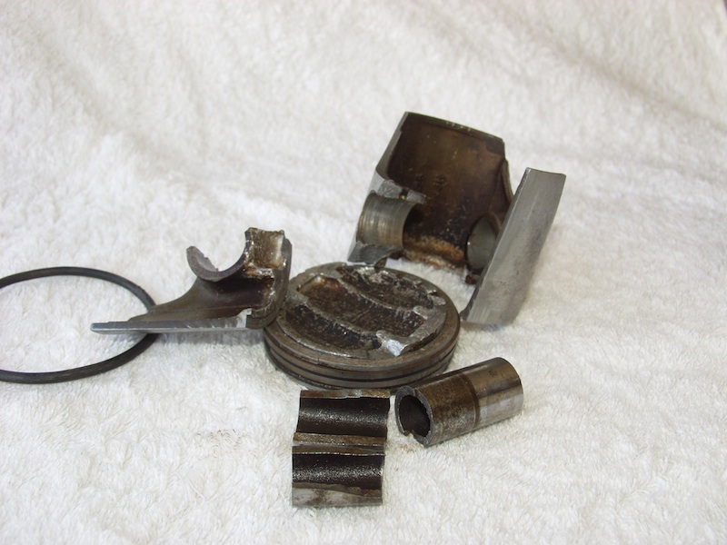

. . . . but take the "O" ring off, and . . . .
"Exploded" view.
"Exploded" view.

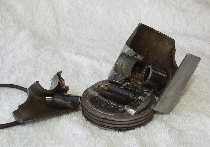

Piston broke and far from home . . .
* This happened to one of our family cars . . . . The driver will remain anonymous so as to protect the writer, but he/she told me that the car made a bit of a loud knocking sound, ran on 3 cylinders but kept running well enough to pull off the highway and into a lay-by a couple of hundred meters down the road. A phone call was made and the car was towed home. Miraculously, I found the head of the piston had proceeded to the top of the bore where it was pushed back a bit by the valve action, then shoved back again by the skirt. This must have happened several hundred times. The skirt, although broken in three, stayed together and attached to the gudgeon pin. The gudgeon pin in turn was in three pieces! The valves were not damaged, I seem to recollect. :o
