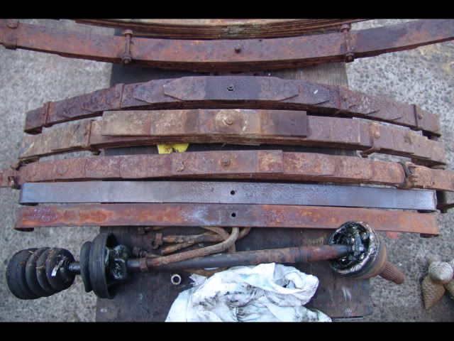

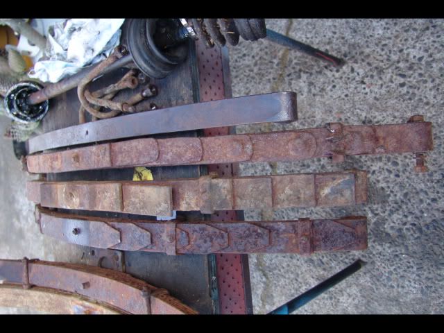

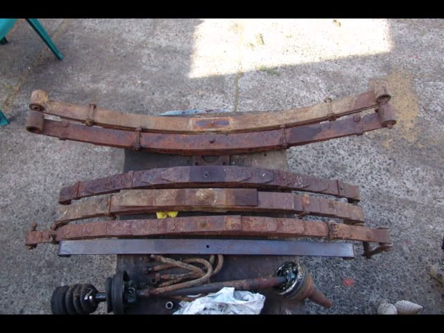

Well today I pulled some reasonal Rear Springs off a Bradford rear axle.
That I had planned to use to modify to work on the 7.
I had all the springs laid out on the table.
Interesting thing I noticed that both front and rear Bradford springs were in central positions.
The 7 springs were the almost identical exept for having a extra leaf and leafs being thinner
Also can some one tell me if the longest spring in the pic is a Jowett spring?
I thought it came off my 1935 chassie but when compairing it on it, its a tad big to work.
Its about 40 inch between the eyes
Thanks
