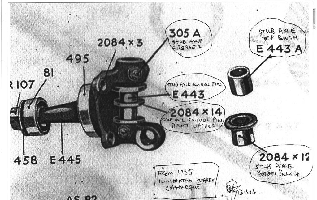

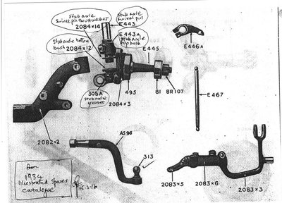

On servicing and inspection of the lady this evening I decided to have a check of the king pins, which I found to be quite a lot of play, rocking the wheel from top and bottom. You can see the stub axle moving quite a bit, Pushing grease in, is soon pushed out by the movement of the wheel. I've also noticed that on one side, the whole stub axle seems to move up and down on the pin itself. I'm pretty sure this isn't right at all??!! What am I missing? Has anyone got a diagram of the various bushes and washers in the right places, I've looked in the parts book but its not that clear. I have another set to put in, but want to make sure I have all the pieces of the puzzle.
Re: King pins
Alan wrote:Has anyone got a diagram of the various bushes and washers in the right places
Alan,
I'll have a look at my new set and get back to you. I've a feeling that there are two types of thrust washers, one type having a slight convex side.
Have you given the cotter pins holding the king pin in the axle beam a mild clout with drift and hammer. If these are slack the wiggle will be exaggerated. Don't strip the thread on the cotter pins when you do up the little nuts.
Re: King pins
Tony wrote: ....one type having a slight convex side.
This from the Jowett Manual up to and including 1936 for 7hp vehicles:
"Worn stub axle pin bushes cause steering troubles and are definitely dangerous. They are a press fit in the axle jaws, and can be pressed or knocked out with a mandrel. On models after 1929, a hardened thrust washer with a spherical underside was fitted on top of the bottom bush. This was pinned to the axle itself and a dust cover was added to give protection from grit and water. The king pin itself rarely needs renewal, being case-hardened, but it should be a good sliding fit in the bushes. On models after 1929, there is a flat on the king pin which locates with the cotter pin holding it in position.See that this flat coincides with the cotter hole in the axle before drawing home the cotter itself."
Posts: 753
Re: King pins
Hello Tony,
Thanks for the diagrams, the ones I took off were of the convex type bottom bush, with a convex washer running above it and a steel cover/cap over the top of that.
The new set were flat bushes with a flat washer, which I have fitted, which fitted well and have taken up all the play that was in the king pin, my only concern now is that I have fitted the washer ( looking at your diagram in the wrong place) Having fitted it to the bottom instead of the top of the stub axle.
