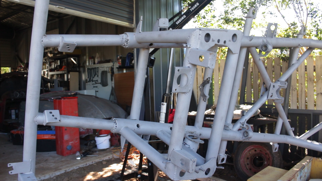

After Sandblasting

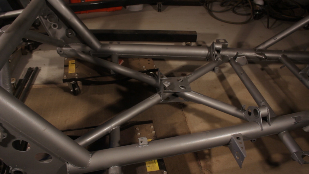

I am at the reassembly stage & repairing things as I go.
