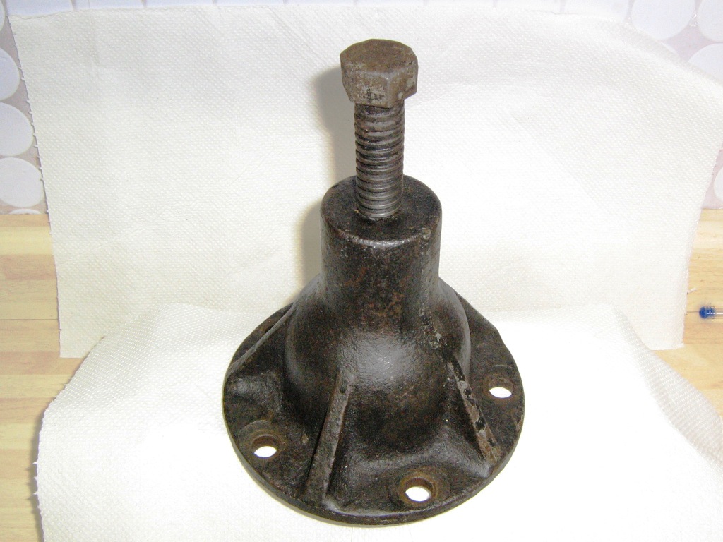

Barry, worth a call to JCS on a Monday to investigate a puller - they have some specific tools, and from memory have pullers that fit, but you'd have to call to see if they had the exact one you need.

So, to ameliorate the situation, I have in my possession a hub puller as you've mentioned in a recent post.
You are most welcome to borrow it to remove all the hubs on the '29. It works on front and rear hubs.
It's heavy and the postage is rather expensive, but if anyone from your section is coming up to the Ex-employees meeting in August, and is willing to take it and deliver it to you, then you'll only have to pay the return postage. My address is in the list.
I have lent it out to a number of Jowetteers over the years as there doesn't seem to be many pre-war pullers around.
Let me know how you want to proceed, by Private Message if you wish, or my telephone number is in the membership list, which might be better.

Many thanks for the offer of the loan. Have you found the hubs are normally very tight? Mulling the situation over last night, I was wondering if I could come up with a long-term solution by fabricating something using you drawings, possible as a small batch if there was demand. In all the excitement of ordering the oil seals last night, I forgot to ask the spares officer if they have anything!

Yes sometimes the hubs are tight, but the beauty of this hub-puller is that you put it over the studs and put all 5 wheelnuts back on tightly, so the pull is even all the way round, and the only way the hub can come off is towards you, with no side slippage. Then you wind the centre screw in as far as possible until there's tension on it and clout the screw head with a lump hammer. If it doesn't come off the first time, then you'll probably be able to put a bit more turn on the screw and clout it again. It hasn't failed yet, but keep the blowtorch handy just in case. Tony.

Thanks for the kind offer which I might still take you up on! I'm hoping I can find or make something to provide a permanent solution which can stay with the car. The problem with the 2 pullers I have tried is that the centre protruding part of the hub won't fit in the relatively shallow and cone shaped part.
