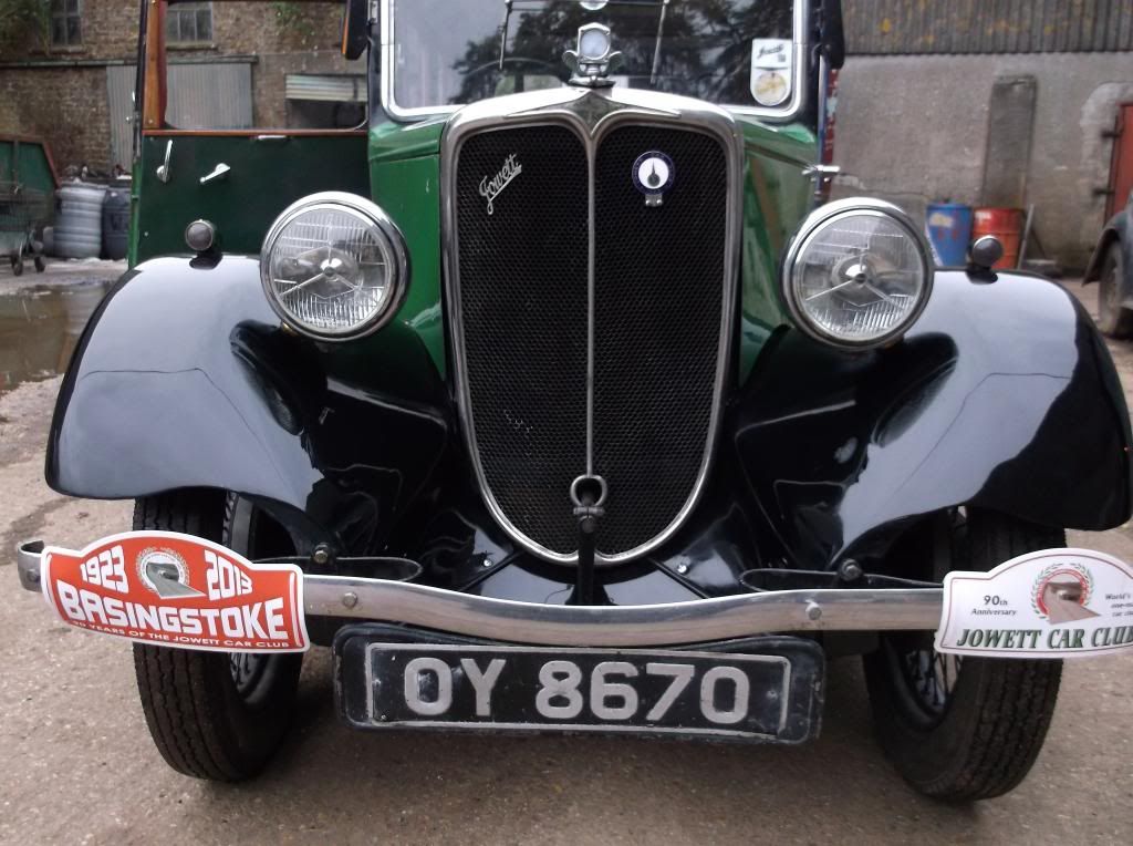

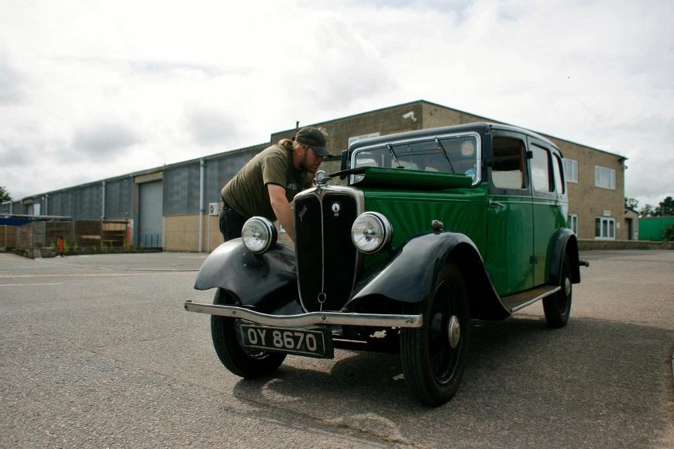

Well Ive now covered a little over 120 miles now, have done a few runs with the sat nav and the speedo is fairly accurate, surpsingly. Am also now reaching into the 35 40s along straight flats which is seemingly going well. With the last couple runs requiring no maintence. Its seemingly becoming more and more reliable with every run. Have a few shows during september then after that will be going through a list i have of things I'd like to improve.
A few pics out and about a friend of mine conviently brought along his camera.
P.s i hope the images are not too big

Well Alan,
She looks a treat, and a credit to your persistence to get the car back to the state it was in when your Pa was running her. The colour scheme is spot on.
Regular maintenance is the order of the day from now on. Don't shirk this responsibility, so that when you go out in her, you'll be able to get back.
I'm looking forward to seeing you all at Basingstoke. I sent the deposit off to Julie Blow, (for Hilary and me), a couple of days ago.
