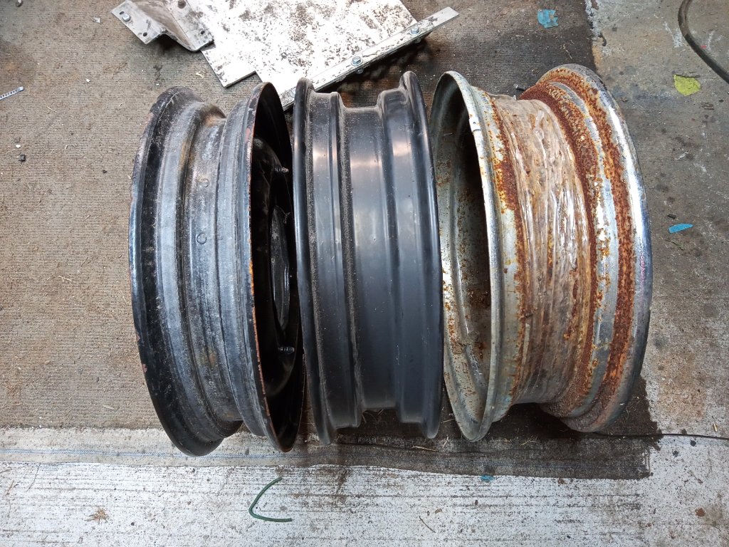

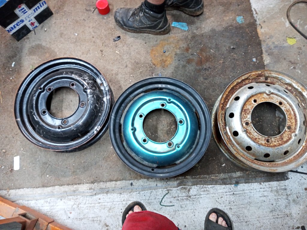

Got curious and looked up Ford Transit. Be careful, the offset on that wheel would put the tire outside the edge of the wing. Also can add that Honda Accord space saver spares are 16" x 4", but the centers would not work. One could cut the centers out and swap in the Jowett center, but that's the part that develops cracks.
- Posts: 552

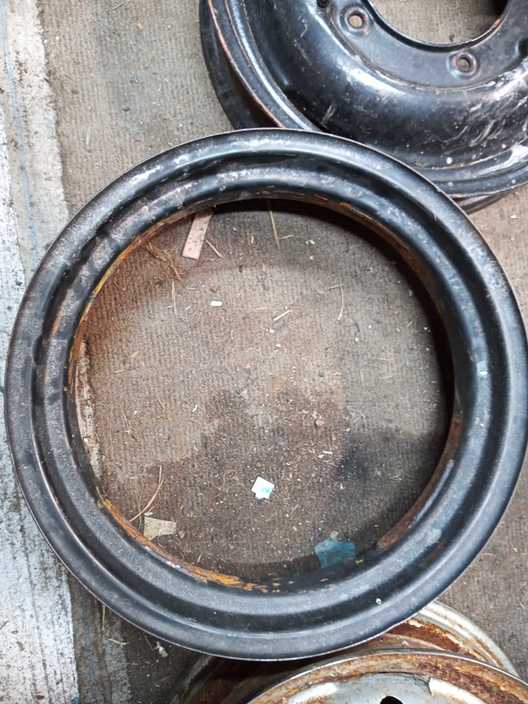

There seems to be confusion.
I dont want complete wheels as i know nothing has the same pcd.
I just require a modern wheel I can salvage the outer rim/ barrel
Be careful fitting wider rims to Jowett centres as they are potentially dangerous. The centres will need a lot of strengthing with weld around all holes and hub cap pins. Then they should be heat treat destressed and probably straightened and balanced prior to tyre fitting.

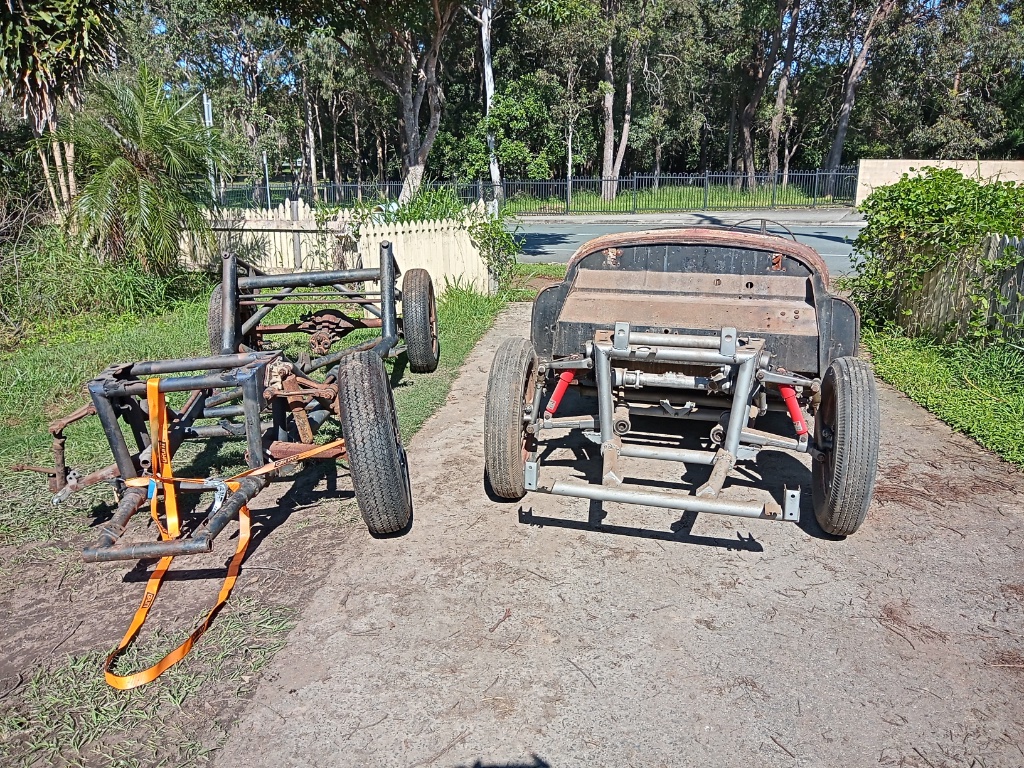

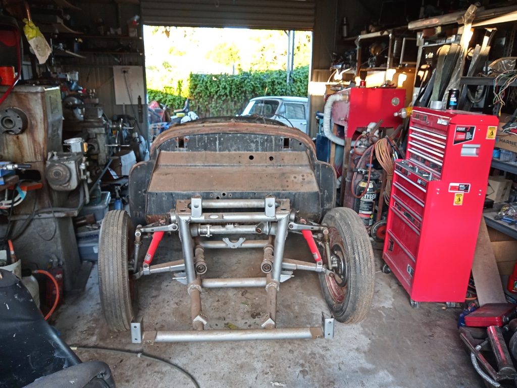

Update on where I am at, I have evicted my son's mini from the shed. My Jupiter is now in it and ready to have the engine and gearbox installed. I hope to have it running by Christmas, my second chassis is more mobile than it has been but a long way from getting anywhere.

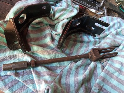

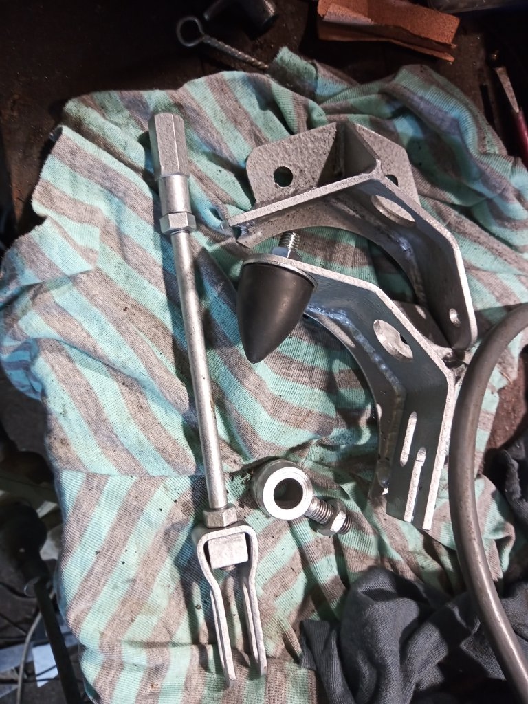

Hi folks I need a hand, can someone please post a picture of the clutch & brake linkage set up.
I have pedals The master cylinder however no fork ends or link rods.
Next question is are they the same as a Javelin?
If not what is the difference?
The parts list mentions a special spacer for the Jupiter master cylinder,which is not pictured.What does it look like?
Have a look at the Best Bits SA and SC rebuilds, there should be a suitable picture. Will take more pics when I get car on lift next week.

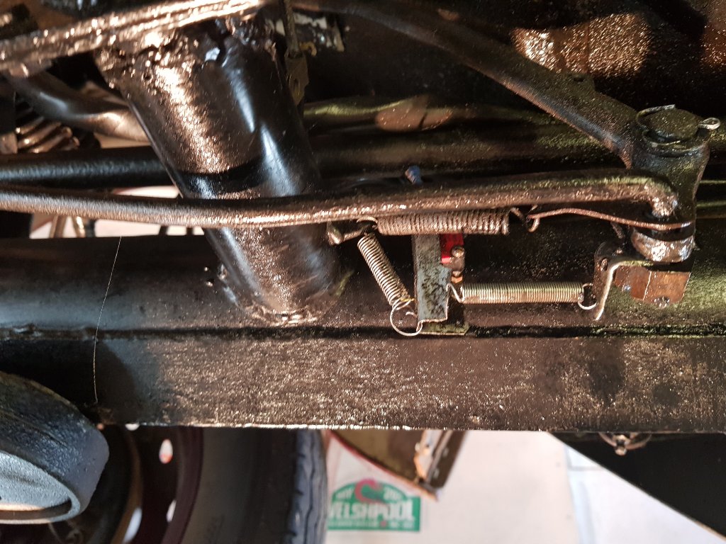

- Posts: 552
- Posts: 552

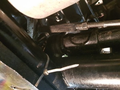

note clutch engagement micro switch for overdrive latch mechanism

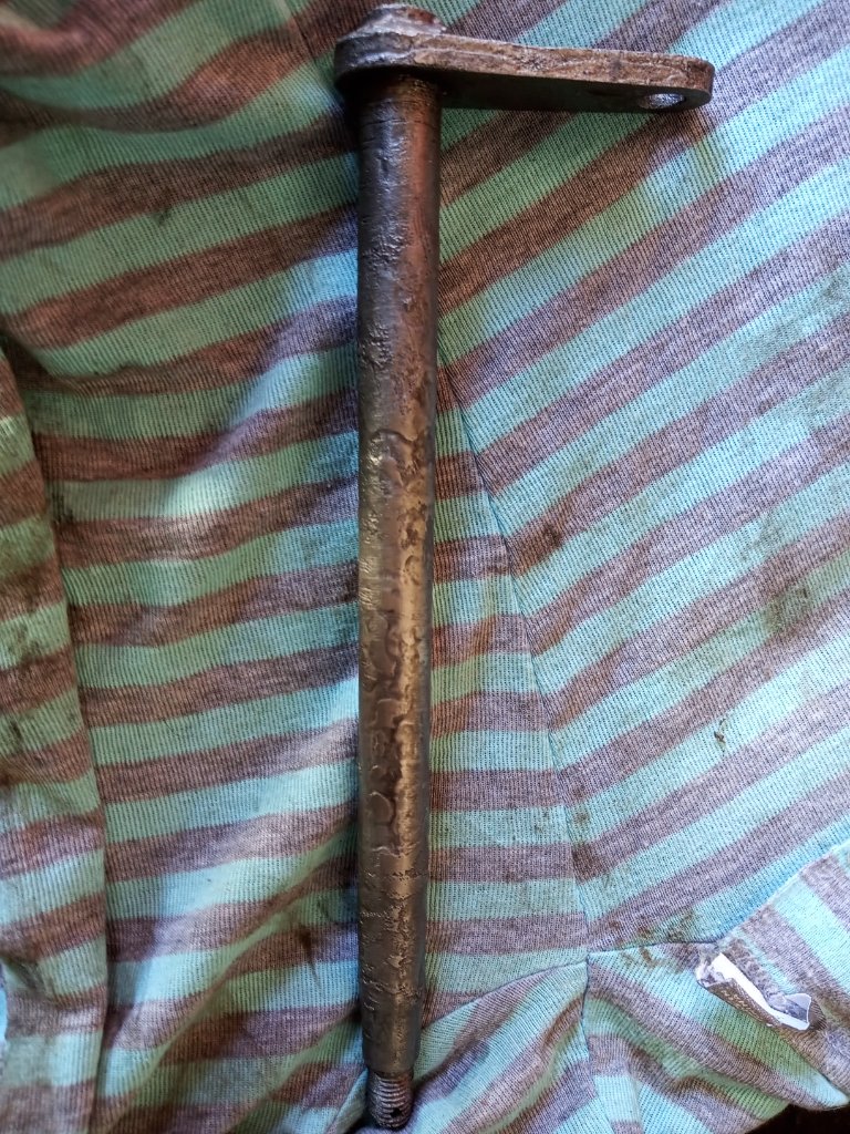

- Posts: 552
Thanks for the photo.
Is the brake & clutch pedal shaft the same as a Javelin?
Are left hand drive jupiters different?
Mine is very chewed up, before I make another one is it possible to use a javelin one?
Jav is different I think.
I would think left and right would be different but there is a slim chance they might not be, if Jowetts had their act together.
First check the parts book.
Also the answer may be different for and SA and an SC. I could check this on the three in my stable, but would require a lot of measuring.
You may need to rebush and ream the hole in the chassis.
It is worth strengthening the gearbox mounting shrouds especially if there has been any rusting. They can sheer around the mounting holes. make sure the gearbox just turns in the rubber after set up with washers.

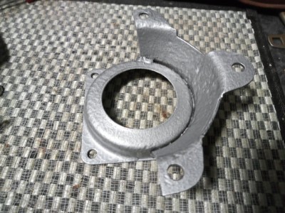

Hi everyone, I have a couple of questions.
1st is what does a Jupiter fuel pump block off plate look like? I have made one but am curious what the original is like.

Spin off oil filter conversions are available, so may not need to move the filter. No idea why you want to move it as it would need a lot of pipe work to get the oil to and from the crankcase.
