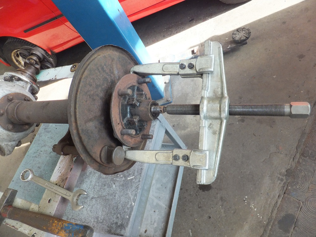

Hello,
The Motor screws and Oilfilter are checked!
The next step is to change the ball bearings. In the picture you can see my attemp... the wheel boss isn´t going away from the axle Is that way right or wrong?
Kind Regards
Kind Regards

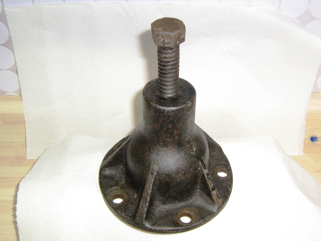

Re: 1936 Jowett in Germany restore
Hello Marcel,
I think that you should be able to remove the hub with the puller that you show in the photo.
The screw needs to be very tight against the axle end and then hit it hard with a hammer.
If it will not come off the first time, try to tighten the screw again and hit with the hammer.
Perhaps a little heat using a blowtorch (lotlampe) on the hub will help.
Stand at the side and not in front of the puller when you hit it. It may come off very quickly.
The photo below shows an original Jowett puller. Best wishes,
Before attempting the removal, replace hub nut and screw onto a number of threads. This will preserve the thread and prevent the possibility of serious injury.
Regards Rich

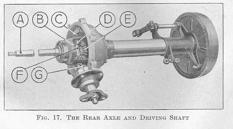

To replace the bearings I think the axle has to be split. Remove the pinion unit and then the half shafts are retained by a circlip/pin in the crown wheel. All this from memory and so quite happy to be corrected! Rich
Hello Marcel.
Removal of the outer bearing from the half shaft in the back axle can be difficult. Because of this you must change the bearing only if it is very necessary.
The inner ring of the bearing where it fits onto the half shaft is the place that will give most trouble. It will be very tight.
I have never dismantled a back axle, but looking at the photo in the Pitman’ s ‘Book of the Jowett’ here’s my suggestion for what it’s worth.
You have already removed the wheel hub and the key in the end of the shaft, so the end of the half shaft and the bearing are visible.
The half shaft runs through a tube. This tube is fastened to the differential housing (the aluminium ball) in the centre of the axle by six nuts on a flange.
Remove these six nuts and the whole tube assembly with the brake back-plate should slide off the differential housing in an ideal world.
The difficulty will come if the wheel bearing is tight on the end of the half shaft, and it probably will be.
Using a heavy hammer, and a strong piece of hard wood, or even a large copper hammer, hit the solid metal area around the back-plate (not the back-plate itself as it is very thin metal) to try to force the tube and the bearing off the end of the half shaft.

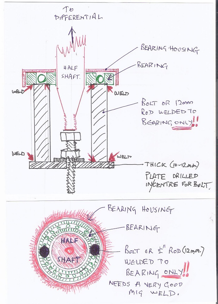

Another method that I have heard of does not need the removal of the axle tube, or if the tube does not come off because the bearing is tight, this method might work.
This method needs a MIG welder, and you will need to make some pieces. The welds will have to be VERY strong and ONLY THE BEARING should be welded to the rods, NOT the bearing housing or the axle shaft.
My drawing should be enough to show you how to do this method, but another word of warning: - before welding the thick plate to the rods (or bolts) you must position the centre bolt as it is shown in the drawing. You will not be able to fit it if you weld the plate on first.
The bolt AND the nut and flat washer should be on the inside of the thick plate so that when you unscrew the nut it will bear on the plate and and the bolt head will bear on the end of the half-shaft.
If the welds are strong and the plate is thick enough, the bearing should pull out of the housing.
I hope George or others will correct me if they can see any problems in my suggestions.
okay,
Thank you Tony, also for drawing.
The drawing shows the function of change the bearings.
Thank you!
There are problems to get the bearings?
Kind Regards
Thank you!
