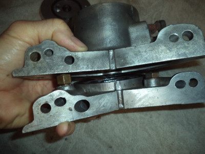

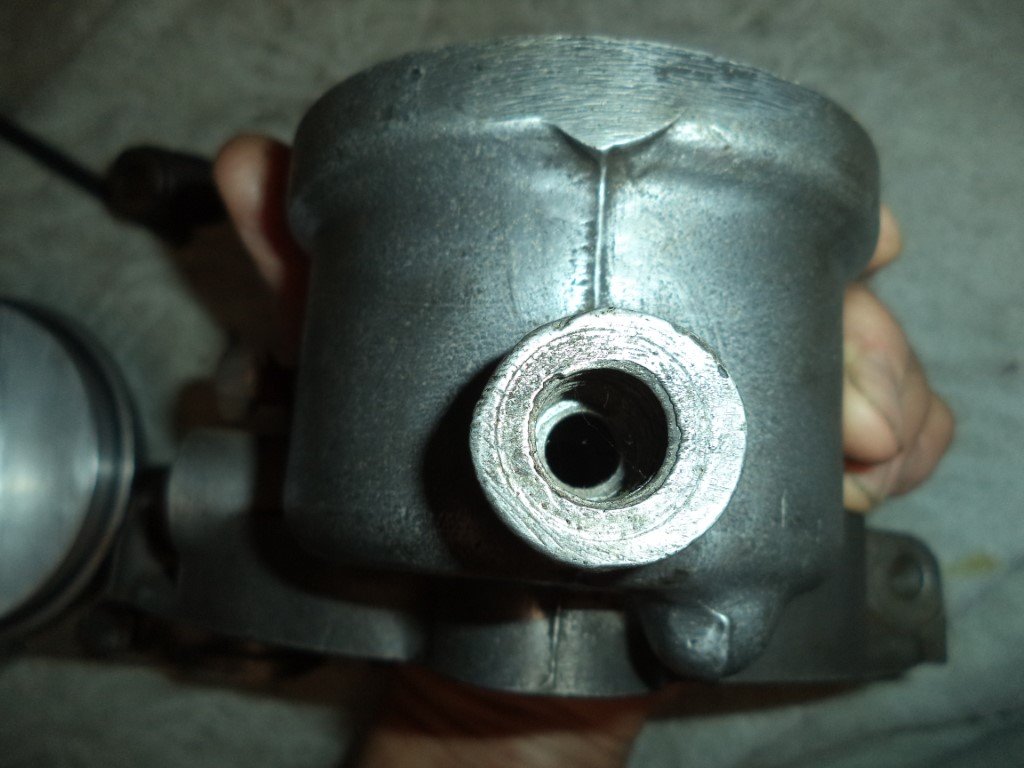

I discovered while assembling my motor I had a series two oil filter holder not a series three.
Some one in the past has also hacked mine about, though repairable, I am looking now for a series three holder.
The photos below show the difference.
JT has a few topics on the filter housing, so use the search facility. Many blocks and housings have had their galleries modified to improve oil flow.
Good luck in finding a suitable housing but make sure all holes and faces mate. Perhaps do the O ring mod

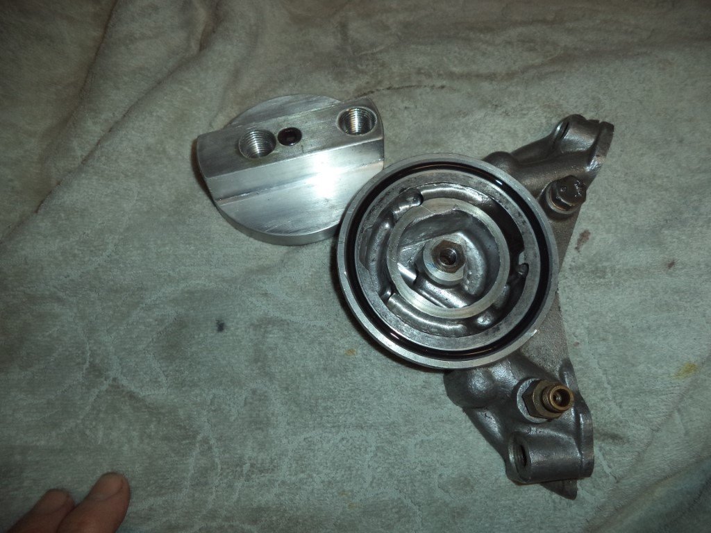

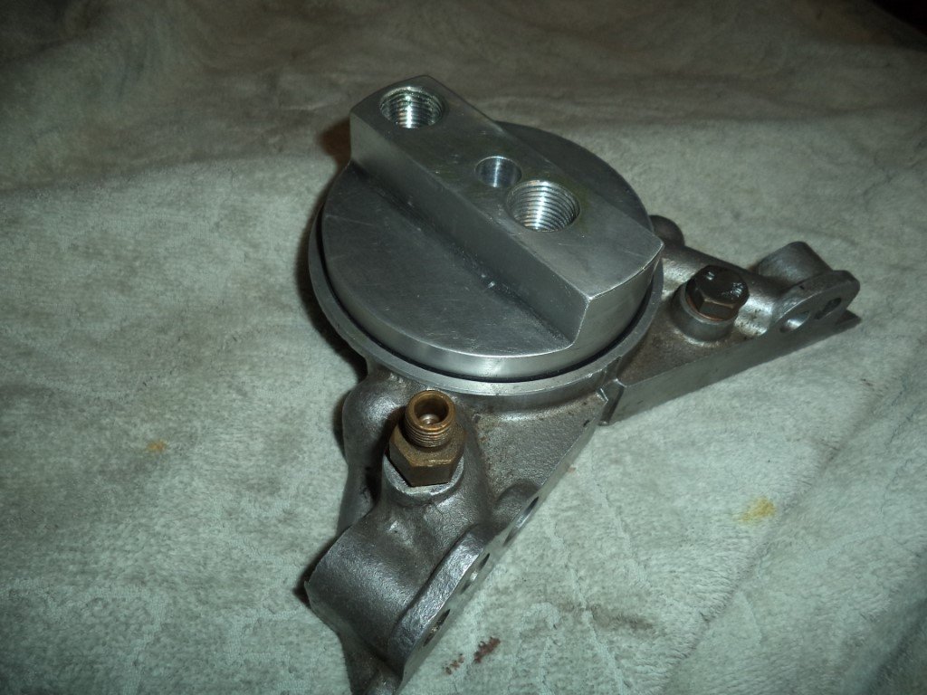

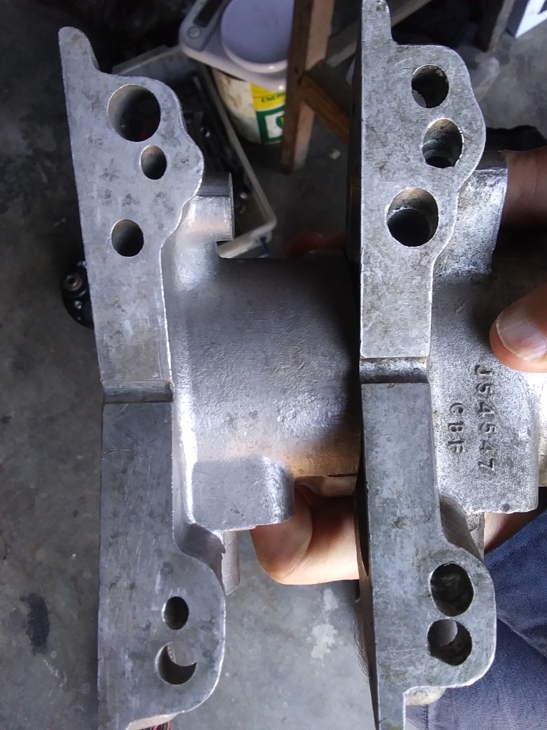

Pictures of a modified early flat base and an unmodified small banjo bolt one.

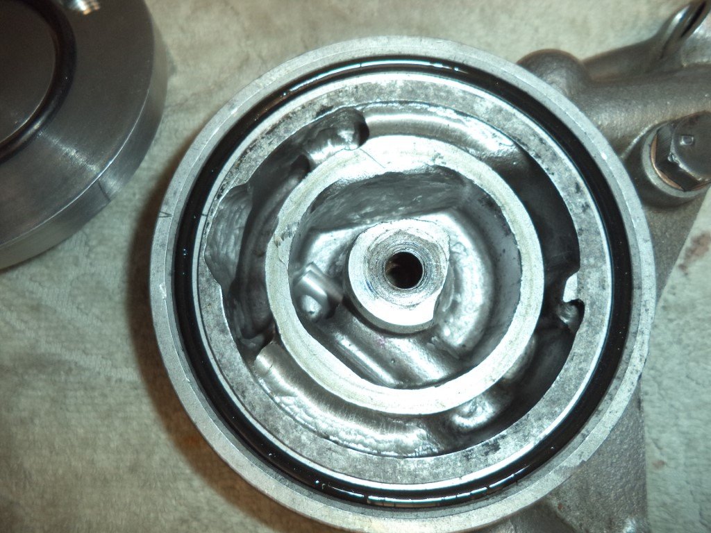

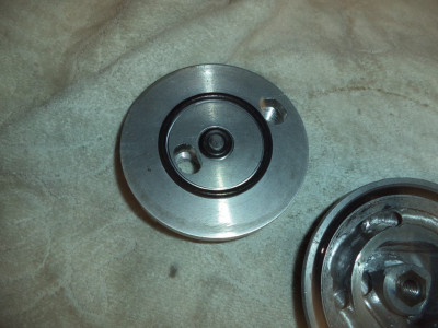

Machined a cover plate held in place by socket head screw. Two ports located to maximize the internal configuration of the base. Tapped for 1/4" NPT x -8AN oil fitting. Internal passages modified to increase cross sectional areas. O-ring grooves machined into sealing side of plate to seal "in" from "out". Used the original groove to seal the plate to the base. Drilled passage from oil pump to match Series 3. Contrary to my previous post, I did enlarge the feeds to the block to larger Series 3 size. Yet to be installed.

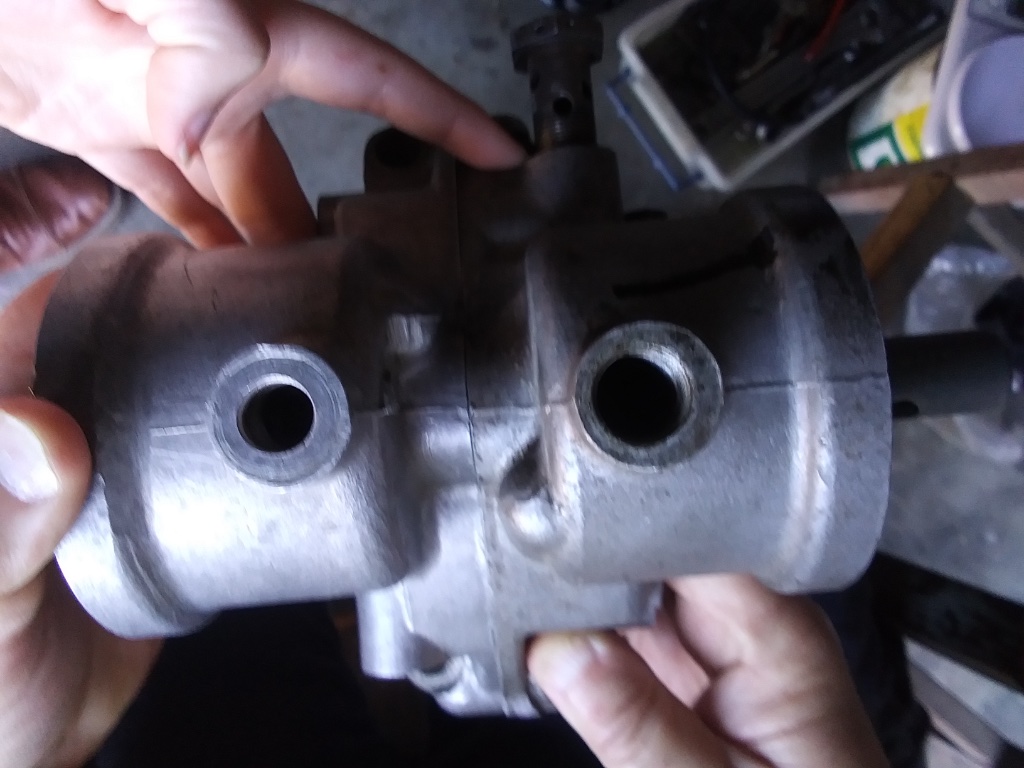

Small banjo bolt base. As seen in the flat base, there is room to enlarge all the ports without breaking through the mating face. The small inlet hole in the cavity needs to be opened up.

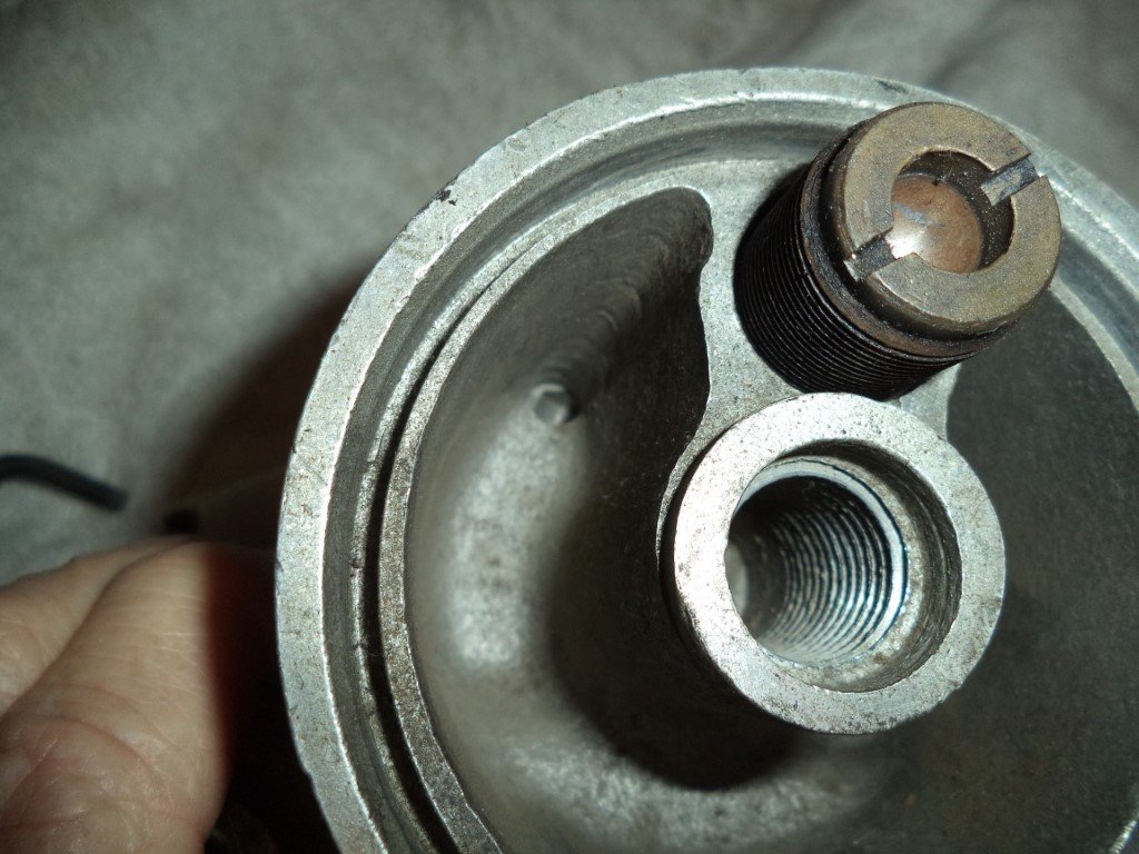

With the pressure relief valve removed, it's easy to see the passage from the top bolt to the cavity is choked off by a fairly small drilling. Both the banjo location and the floor of the pressure relief chamber need to be enlarged. The hard part is reaching deep enough on the transverse passage at the bottom of the base to get it opened up. One might argue that after getting past the right side hole (2,4 cylinders), the restriction is simply the same as that directing oil to the block.
Easier to buy a Series 3 from JCS!
Forgot to mention that after all the internal work, drill and tap the ports for modern fittings. I'm now thinking that up-sized metric banjos might be a good solution as it would look somewhat original.
