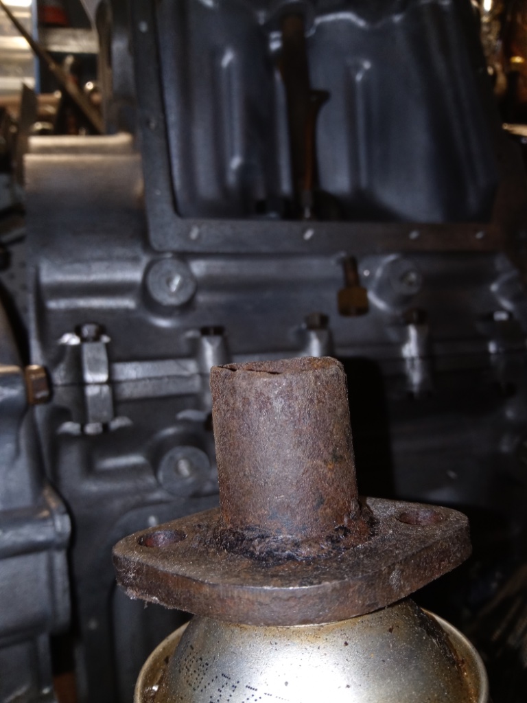

How long is the water pipe meant to be?
The long ones are way to measure however the short one is very corroded,

Inlet pipes. Not critical. I made ones that allowed me to have straight pipe everywhere so that spares in far off countries would always be available.
See SA rebuild in best bits.
https://jowett.net/forum/viewtopic.php? ... ght#p23951

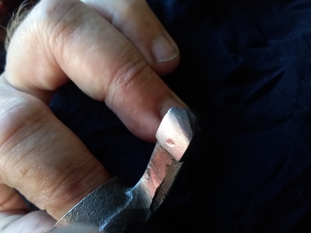

However my main problem is the rockers all show signs of wear with the one on the photo being the worst.
do I do as someone else seems to have done and grind down till they are not pitted?
Go to my spares who supplied them & ask for better ones?
Or go to a machine shop and get them all profiled the same.
As I have new pistons , Lifters, camshaft, new valves & ground crank I don't want to do a bodgy job.
All thoughts , even if bodgy are appreciated.
I would leave as is since you may find you end up with removing a lot of metal to get rid of the pit.
You will be removing the hardened surface which you could replace with Stellite or other metal replacement process.
For racing I lightened the rockers considerably.
If you are swapping components then use a grindstone to reprofile the curve but without removing any metal from the worn part.
Also check the spring retaining cover is not worn as this may break and drop the valve.

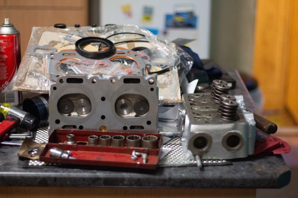

Here is an update on where I am at.
I have moved my engine into my kitchen, as my son has been sand blasting in my shed.
Setting the liner height, meant multiple attempts , with advice from Brian Holmes all is now good.
Next step was bolting on the heads, unfortunately the last cylinder stud ,on the last torque setting stripped .
I have ordered new gaskets & a helicoil kit which should arrive by this coming week end.
Some people would be very upset , however ,I feel all up, one stripped nut & one stripped crankcase thread is pretty good.
The engine is 70 years old & basically was in the scrap pile.
