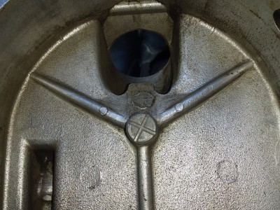

I have acquired a series three timing cover . however the cam stop is not adjustable, as I thought series three were.
Is this some last factory attempt to control cam float? or someones fix from bygone eras?

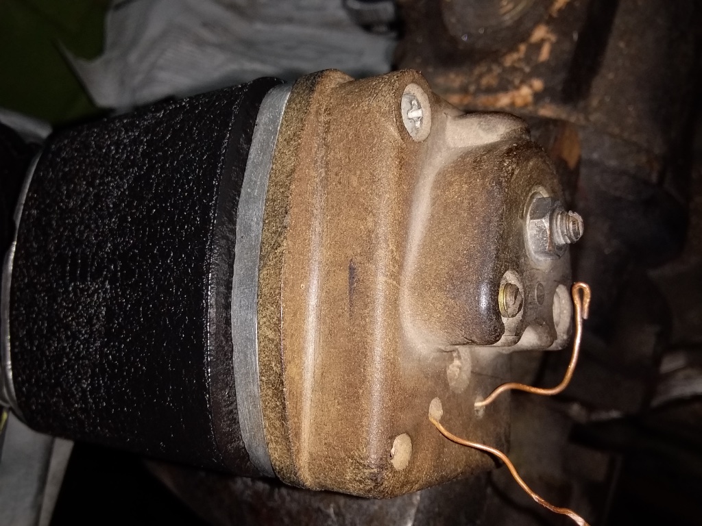

I have cleaned up my wiper motor, and used the boot polish to brighten the plastic.
This works well on old plastic & extremely well on Bakelite.

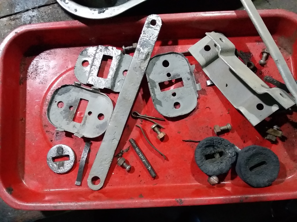

the mechanism for the door strap is rather intricate & very corroded, does any one know of another car that shared the mechanism? I doubt Jowett alone made this part.
Also the back tail lights are Lucas st461-1 , from what I can find out are shared by Rolls Royce , Bently & AC, des any one know of another less bespoke manufacture that used them & a source (other than wrecking another jowett).

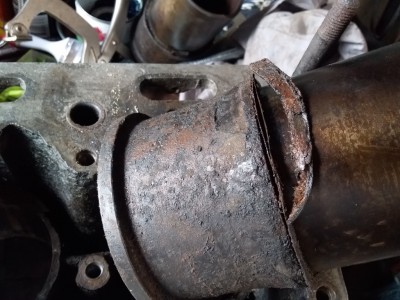

Folks a made a liner puller with my new toy a vintage lathe.
After pulling the liners can anyone tell me if the mess on the liner is the latter O ring type or someones
attempt to increase the liner lift. It appears to be made of rotten card board or leather . with copper shims.
Also the seat in block they sit on looks cruddy, is this normal before clean up?
- Posts: 3970
The original seal was a fibre ring with copper shims. Latterly the fibre gasket was replaced with a solid annealed copper ring with copper shims. This helped reduce liner sinkage.

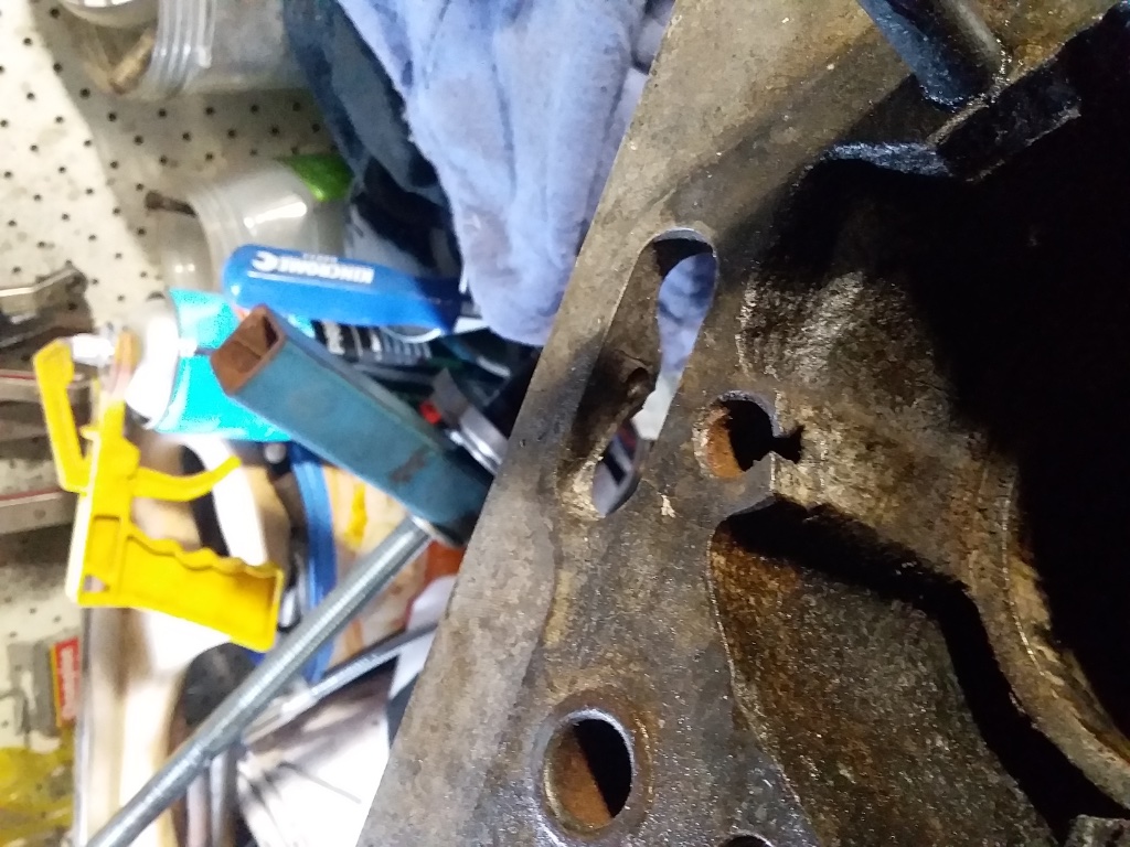

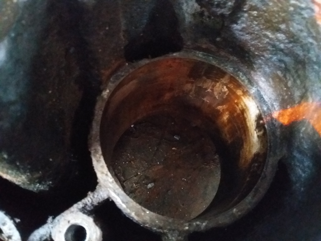

I have all the liners out, & noticed this stud hole.
It appears to have a gap made by machining.
Is this within Jowett tolerance? Or has someone cleaned up in the past & gone a bit too far?
Should I try to weld it up?

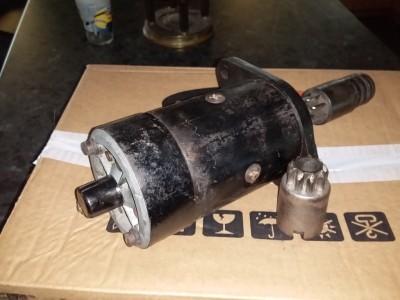

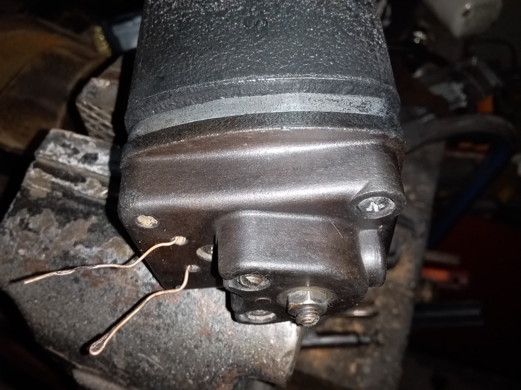

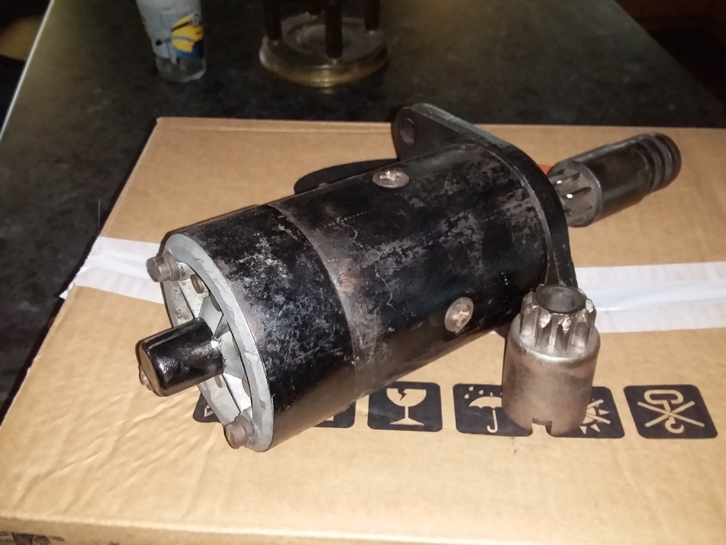

A bit of an update, my local auto electrician has rebuilt the starter motor. he did his apprenticeship in 1970, when lucas parts were common. He loves their simplicity & availability of parts. total cost $110.00.
This is new bearings, brush's, spring, good used drive pinion , armature skim & all wiring tested & rebound.
I doubt I could buy the parts for that.
One weird thing in all his years he can't recall ever doing a lucas starter of this type with reverse rotation.
Jowetts must be the only car, or is there another Marque?
