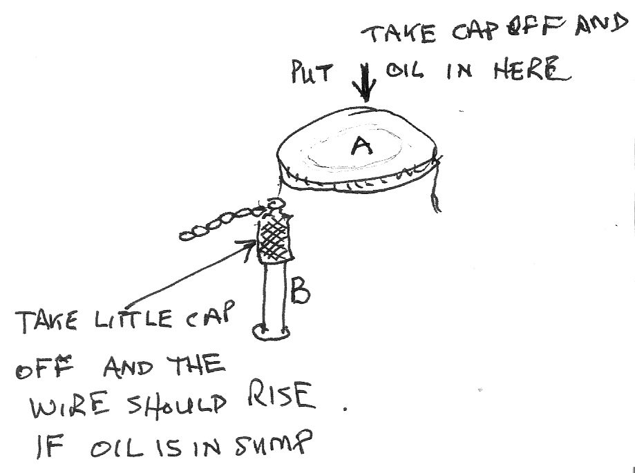

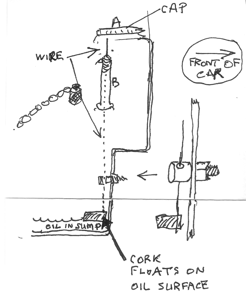

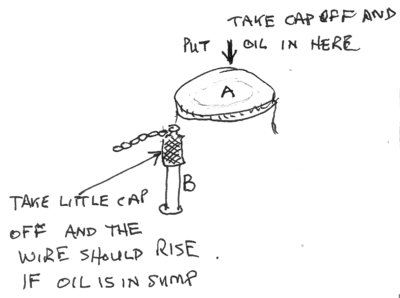

Re: 1936 Jowett in Germany restore
If using the wire indicator on top of the engine the summp is 'up to correct full level when the wire stops rising. If you also have a dipstick and it is not calibrated the only way to be certain is to drain the oil - pour in 2 pints of oil and mark this as ''LOW'' then put in another 2 pints and mark the dipstick reading as ''FULL''
What is the engine number ( on the brass plate on timing case) as this will establish the year of the engine or at leasst of the crankcase anda atherefore of the capacity. However both 907cc (as up to 1936) and 946cc ( 1937 - 1940 ) have the same output of 17bhp. at 3250 rpm. It is also possible that it has 1946 + Bradford CA cylinders which give a capacity of 1005cc . If it also has a Bradford camshaft it may develop19bhp @3500 rpm and a bit more torque 43ftlb at 1400rpm. .
Marcel,
Some time ago in this '1936 Jowett in Germany restore' discussion, there was a photograph of an engine showing the filler cap and the oil level tube.
Look at the post by Peter Holden on Wednesday July 18 2012.
When you have emptied the oil from the sump, take off the little cap from tube 'B' in the drawing. The end of the wire should just be seen inside at the top of the tube.
Inside the engine the other end of the wire is firmly attached to a block of cork in the sump.
As you add oil through the filler hole (at 'A'), the cork will float on the surface of the oil and so the wire will start to rise out of the top of tube 'B'.
When the wire showing is about 1.5 cm long, this will be the minimum amount.
When you add more oil the cork float rises and the wire showing will become longer.
If you look at the second drawing you will see that the wire passes through a special fixing to keep it straight. This also limits how high the wire can rise because the float will stop rising when it touches the fixing. This will be the maximum amount.
You will see from the drawing that if you add even more oil, the float will not be able to rise further, so the sump will have too much oil in it.

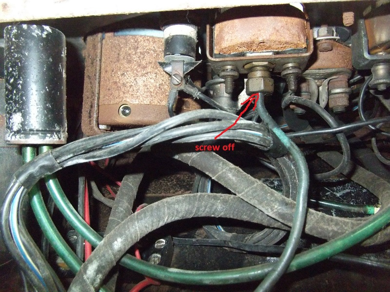

I want to know, if I can screw the pressure line from the temperature display off?
Thank you for giving Informations from my engine!
Hello Georg,
okay, now i know a litte bit the meaning of the engine numer, thank you.
What a pitty, that it is not the original engine, but at least it runs! that is also important!
Hello Tony,
Yes, I hava a industruction book for my 1936 Jowett!
Here a picture:
Hello Marcel.
Thank you for the photo. The gauge that you have marked as 'screw off' in red is the oil pressure gauge. This is not a temperature gauge, it reads the engine oil pressure in pounds per square inch, and the pipe that comes out from the back is connected to the pressure release valve (PRV) at the back of the engine. We have talked about this PRV before in a previous post with a pencil drawing of the valve itself.

Hi Marcel,
As Tony says, the connection is for oil pressure. So you can disconnect this provided the engine is NOT RUNNING. So stop the engine before disconnecting.
Als Tony sagt, ist der Anschluss für Öldruck. So können Sie dies sofern der Motor nicht läuft trennen. So stoppen Sie den Motor vor dem Abschalten.
