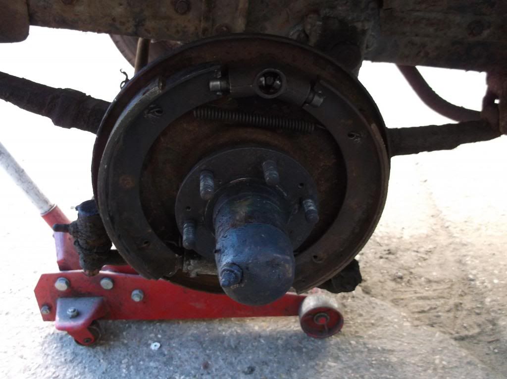

Well today I have been continuing with free off the brake adjusters. The tool turned up on friday just in time for the weekend, also got re acquainted with these to help me along the way!

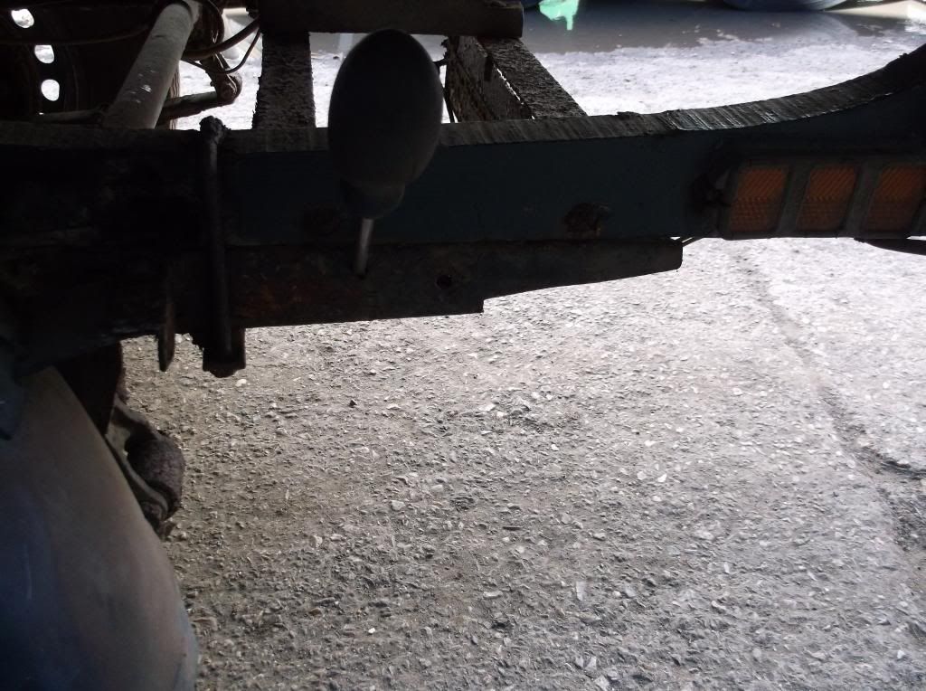

Everything is crusty, but looks serviceable. Although a bit more of a poke around toward the back revealed some grot on the chassis, so once Ive sorted out the cab, I think I will be getting the chassis apart from the bed and cab and for my own piece of mind getting it sorted and repaired.
Makes a good screwdriver holder though! It looks to have been repaired before too.

Alan, a vital part of setting up the girling brakes is that the expander unit MUST be free to slide on the backplate. This not happening is the biggest cause of uneven braking, pulling to one side or just poor efficiency due to only one shoe being pushed against the drim. Lightly grease backplate/expander unit, tighten retaining nuts ( use new self locking nuts)full and then back off until expander moves freely on backplate

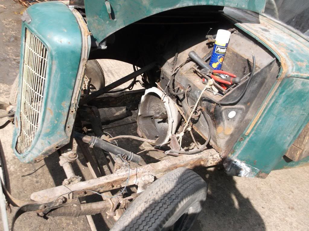

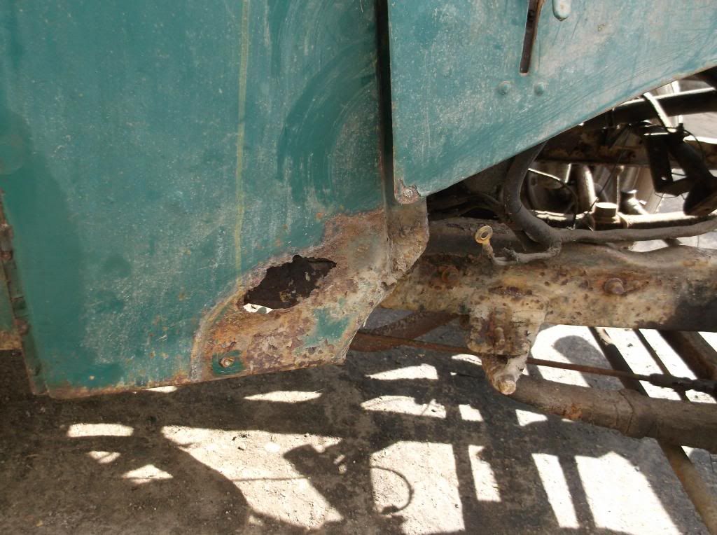

Well I spent yesterday evening stripping off the front wings to see and get to things a bit easier and so I could start cleaning things up. And made a few discoveries of holes, and riveted on patches on either side of the scuttle. Along with the a small patch of the wing mounting needing to be repaired and remade. So time to get re learning on the welding haven't done it in a while and wasn't brilliant when I tried, so hopefully this will give me the motivation to give it another go again!

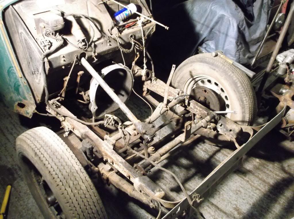

Alan - when it comes to putting the engine back in the front ( engine mounting) crossmember gets in the way as does the steering column. unbolt steering box and drag link an pull column up into the cab. The simplest way to deal with the crossmember is to remove all but the lower front bolts i.e remove 3 per side. The lower front ones should be loosened but left in place so that the crossmember can pivot forwards and downwards on them. Doing it this way rather than removing vrossmember completely saves the thing going out of alignment.

Re: Bradford CC Lorry (The Tramp)

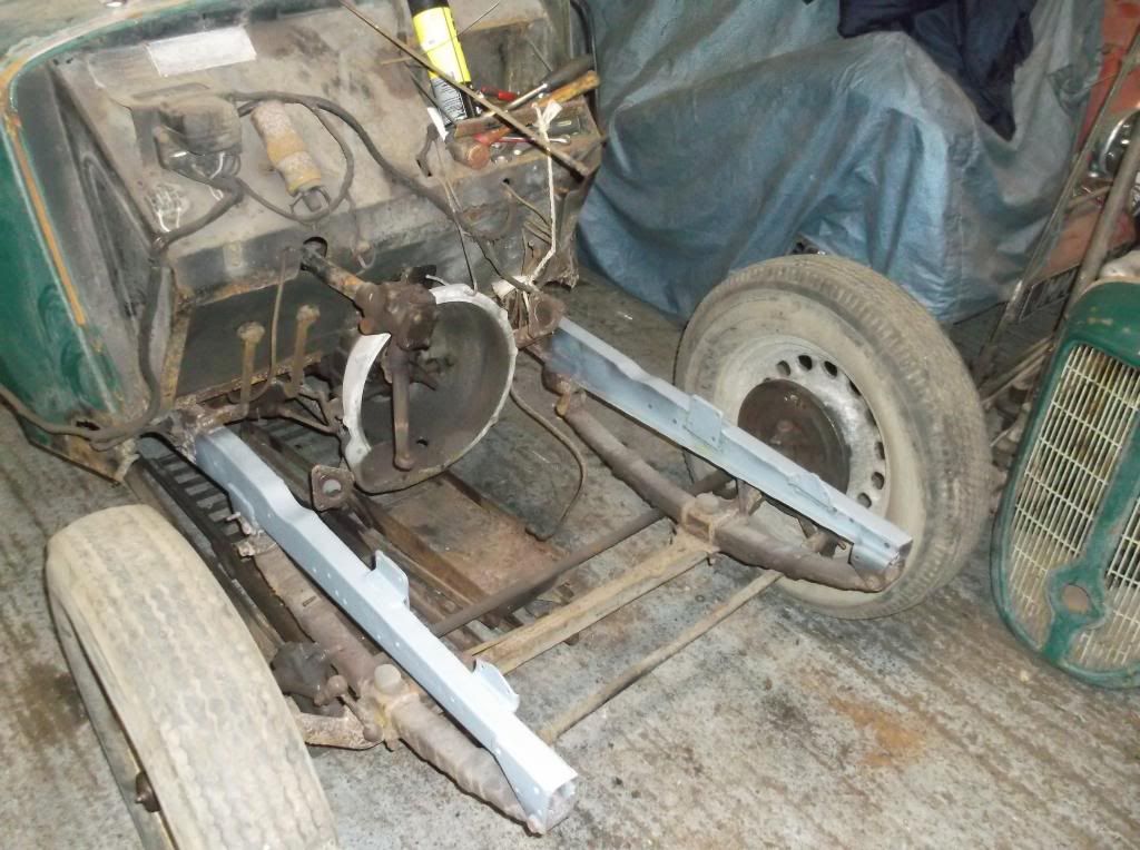

Well a bit more progress made at the weekend. Wirebrushing the crusty rust off the front chassis rails. And getting it in a coat of primer. Working my way backwards. Am I right in thinking although it looks to be all the chassis cross members are just bolted to the chassis rails? Not what i expected, expected them to be pressed in. Also took off the front hubs to check the bearings which are surprisingly look all new, clean and well greased. Quite a surprised from how long the car has been stood.

yes all cross members are bolted to chassis rails but I would not remove more than one at a time !

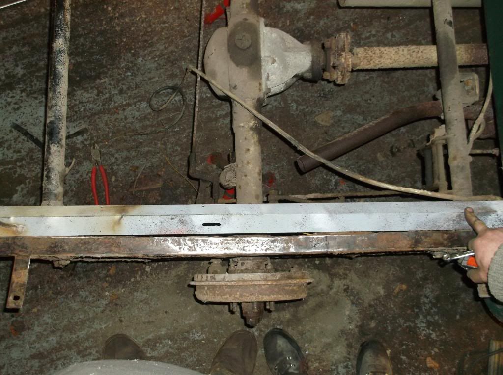

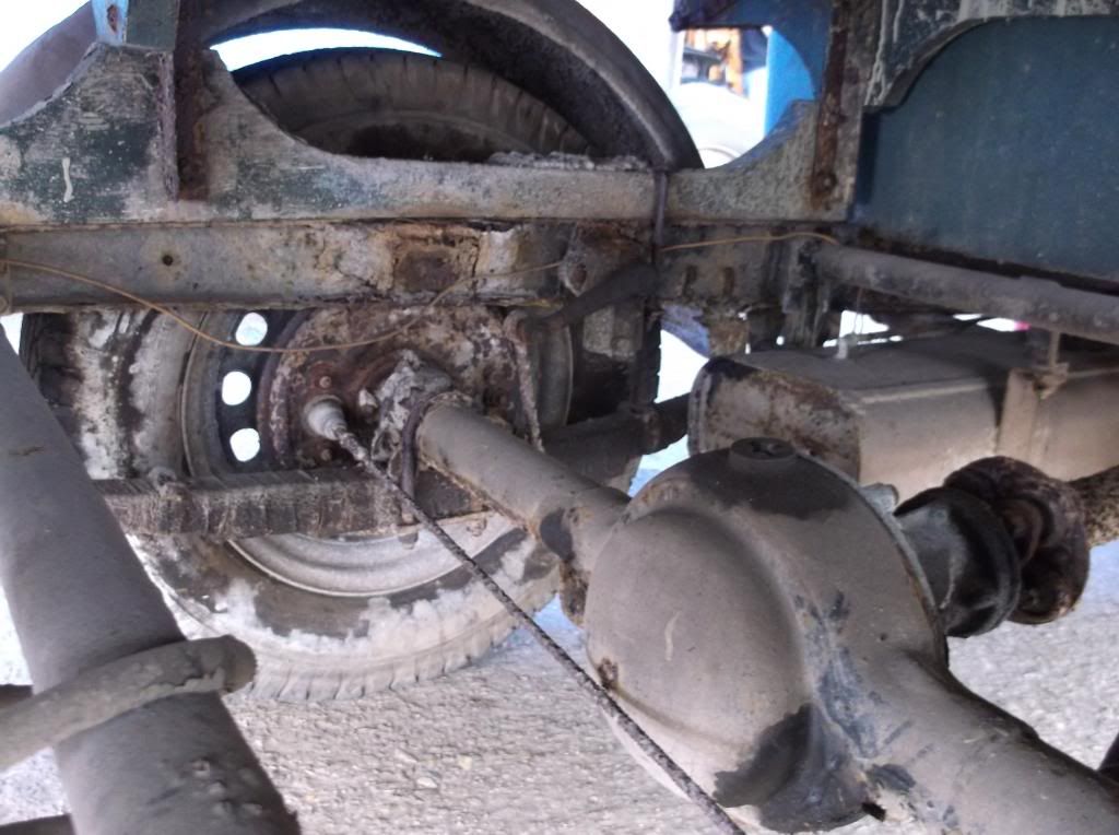

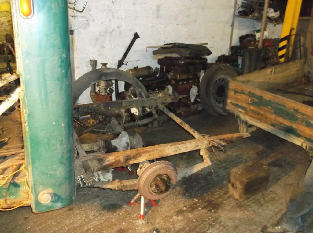

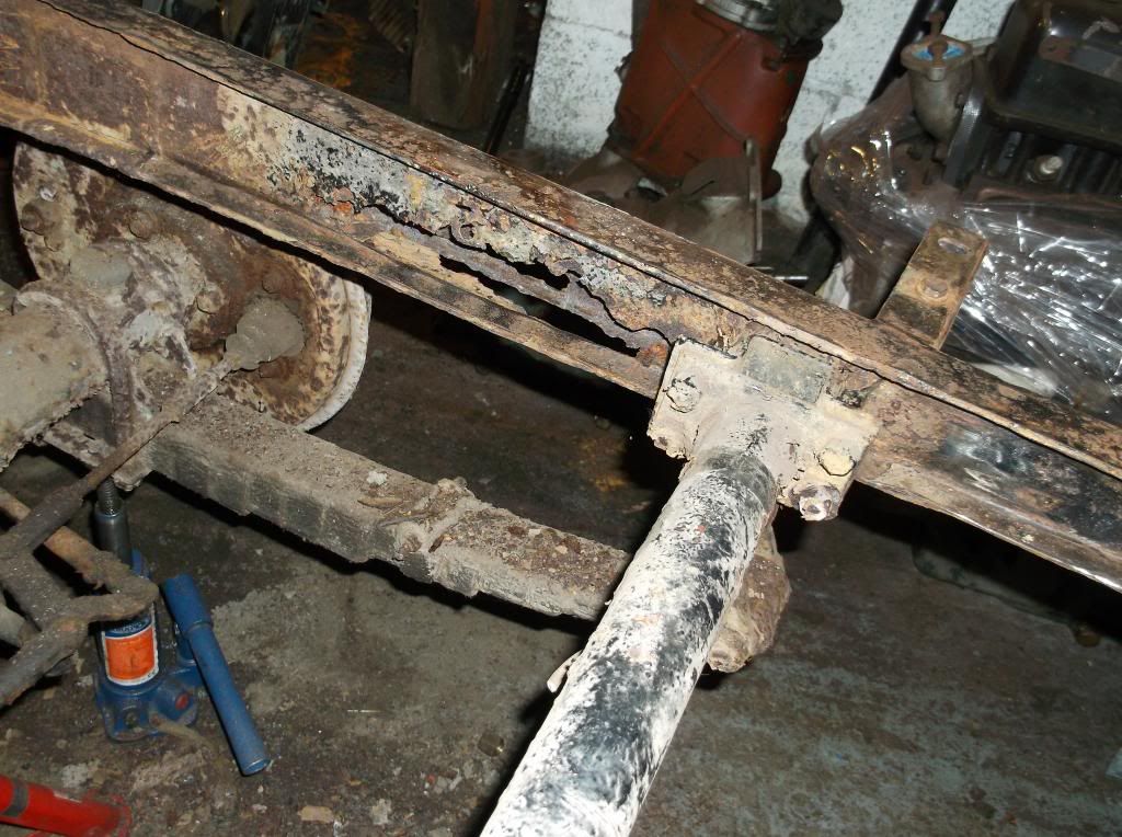

So spent the day taking a bit more apart to get cleaned up took the bed off to check out the holey chassis, and its quite holy! Also the rear of the chassis is ever so slightly bowed! Having measured up everything appears to be square, it just looks to bow out from the middle of the back of the chassis. Very odd! Our only thoughts as its been bolted up from the factory like that, as the nuts and bolts at the rear holding the cross members appear to be original and undisturbed.
Putting the rail against a straight edge you can see how its moved out slightly
