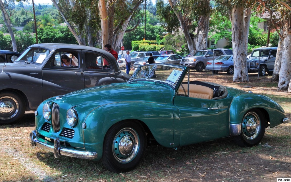

- Posts: 642
Does anyone know what colour this Jupiter is?
There is also a light metallic blue I have seen Jupiters in, does anyone have the paint code or equivalent?

To my best knowledge Jowett never issued a manufactures paint code and just simply used a name for colour - any surviving original paint formulas are of no use with todays paint mixing systems has the entire tinting banks are several generations onwards from what the original tinting banks were - therefore the original formulas tinting products are no longer available - I use historical colour records then a combination of mass spectrometer / colour chips along with sprayed test cards of the proposed colour to achieve the final result - but you need a good dedicated automotive paint factor that understands your requirements to start with
- Posts: 557
The car in the picture is Metallic Turquoise, the most popular color sold in the US. That car is currently in Ohio.
Chris is correct that paint formulations have changed massively since the 50's and even more so over the last few years with moves to water-based color coats and catalyzed clears.
A few years back, I sent a Metal Turquoise panel to this place http://www.autocolorlibrary.com/antique.html. After I explained it was original paint, the fellow told me THEY would determine if it were an original paint!
We used their formulation to paint Roger Steven's car.

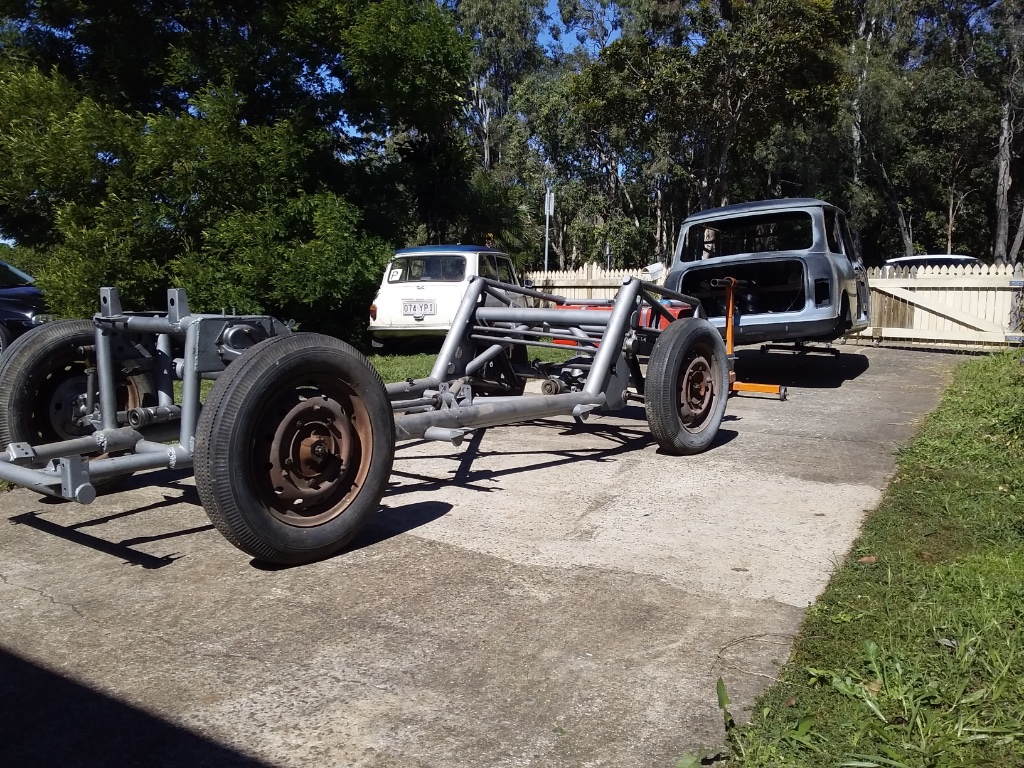

- Posts: 642
My baby is back on four wheels, with new bearings & bush's she rolls beautifully.
I have temporally put the body back on to concentrate on the engine. Though I hope to have a colour test shortly.

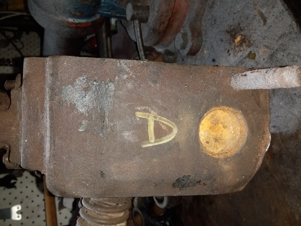

- Posts: 642
This is one of the odd heads I have, note the lack of frost/welch/core plugs.
What is it ? A PA?
What is it ? A PA?
