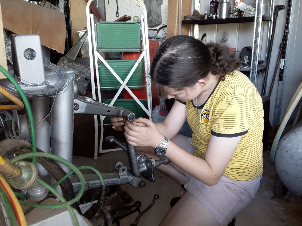

Have had time off between Easter & ANZAC day, my daughter has the same time off from university,
so she has graciously helped me shim the front end, ready to put the front wheels back on.

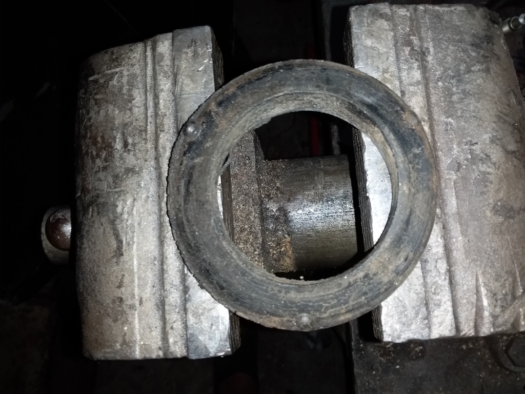

Does anyone know where I can get new Jupiter steering rack rubber cushions? as pictured?

Hello David,
Quite simple really.
Go to a Bearing Service Company shop or similar. Purchase a length of 'O' ring cord to suit, along with a small bottle of Loctite 406 adhesive. Use the steering rack housing end diameter for the inside diameter of your 'O' ring. Cut the cord cleanly for a snug fit over the rack housing. Clean the butt joint ends with Loctite 7471 cleaner/primer, apply a couple of drops of the Loctite 406 to one end and accurately align the ends to make the join. Methylated spirits (unsoiled) can be used for cleaning the surfaces, but the cure time will be longer.
Remember to keep the Loctite 406 in your refrigerator - Sue tolerates my bottle!
Such a procedure means that 'O' rings can be formed from cord that can hold securely in the majority of hydraulic systems.
Maybe, make a few extras and send them to Jim Scott?

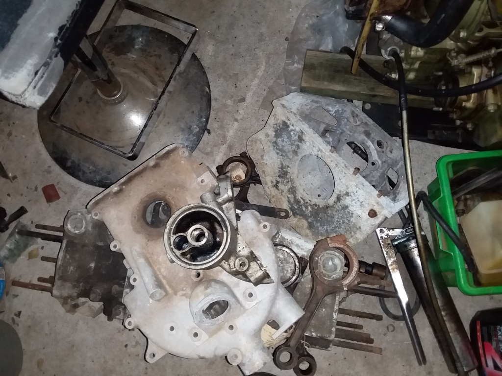

My hoard of rocking horse poo. Series three crankcases, oval crank & serrated conrods.
Thanks to all the club members involved, people from all over the country & globe contributed

Hello David,
Is that the Series III crankcase? If so, the front timing cover is not the correct version to match.
Make sure that the rear timing cover is a good match as well.
