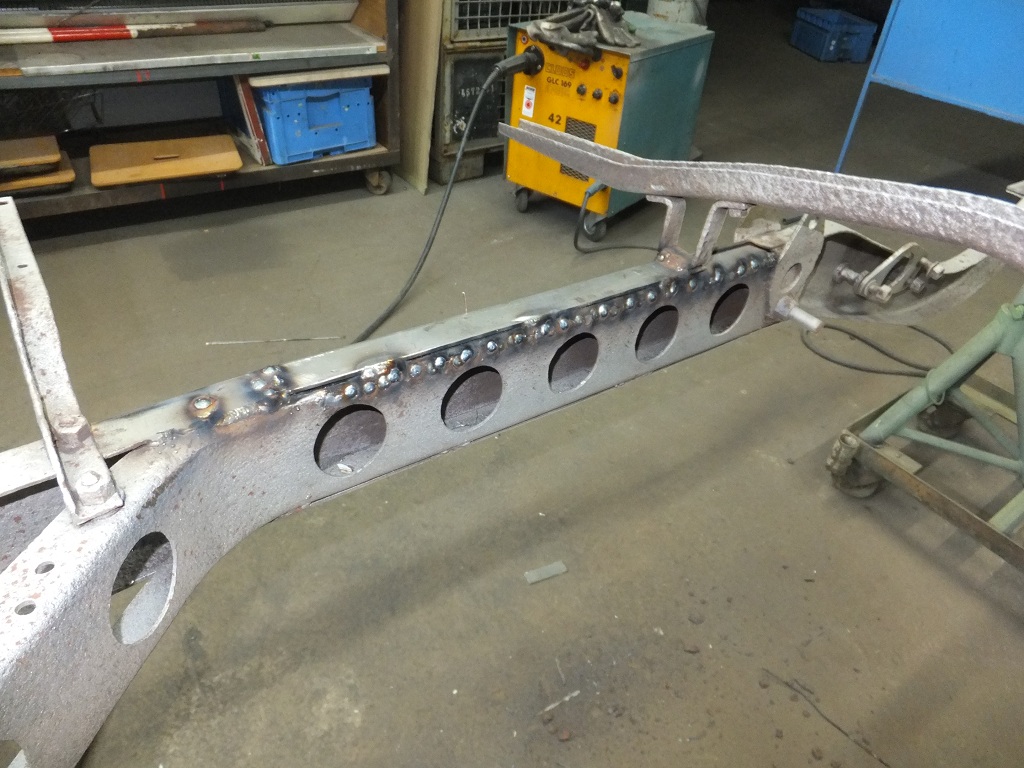

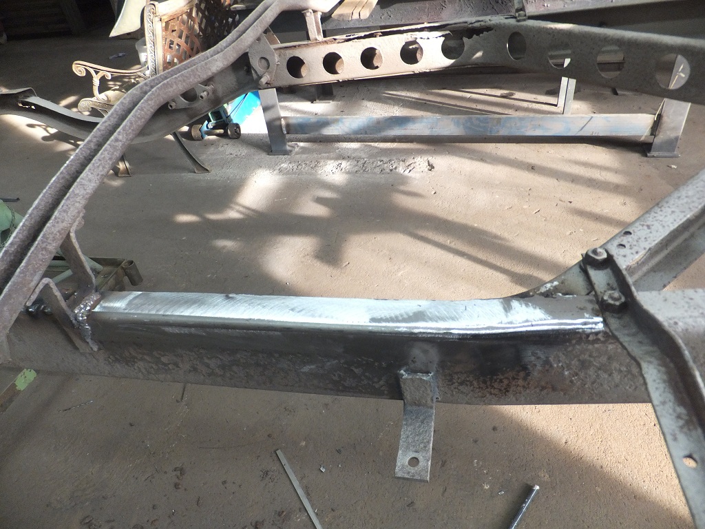

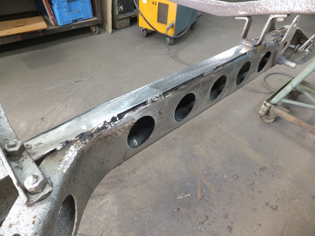

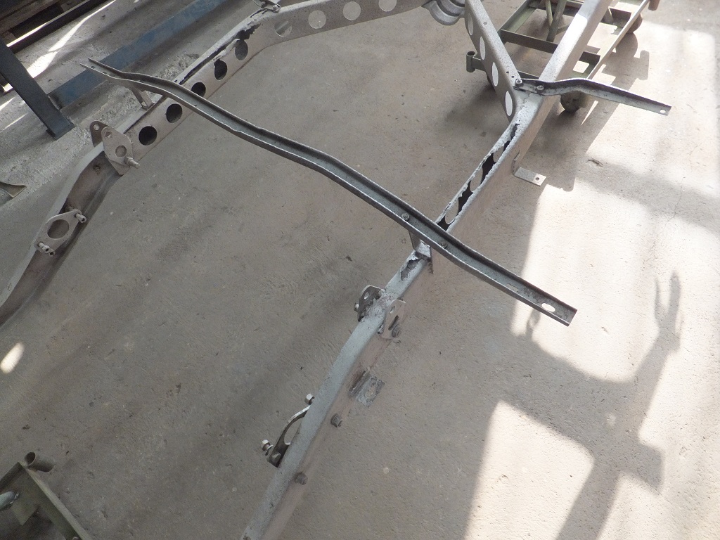

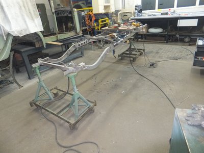

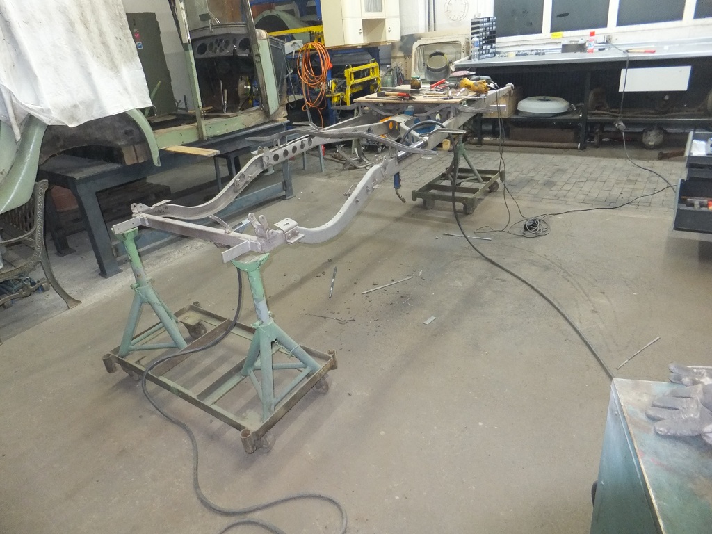

A few pictures for you, i´m game to weld the frame:

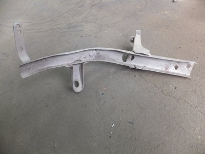

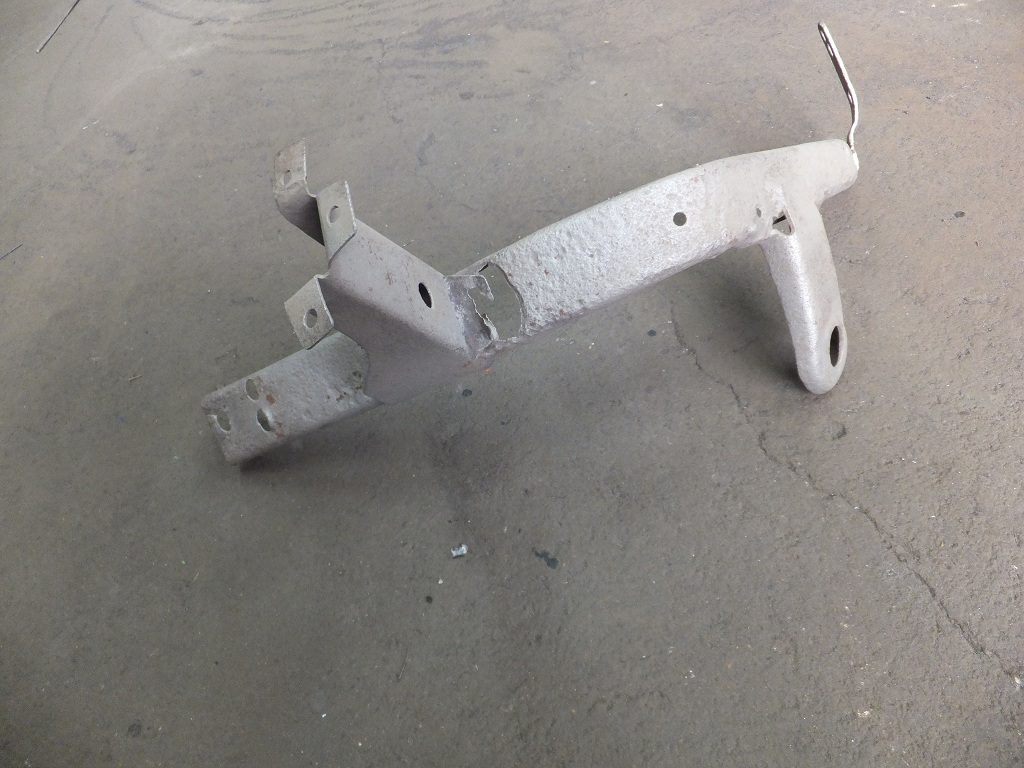

Here i need a spare, have anybody so a fender holder left side? My is really irreparable... :?
Here a picture:
Posts: 1745
Re: 1936 Jowett in Germany restore
Hello Marcel,
The fender holder (or mudguard stay) looks to be rotten only on the vertical part. The attached pressings for the sidelight, headlamp and cross-piece stay, and the upper bent part seem to be good metal (from the photo you posted).
Perhaps you could make a channel section out of the sheet metal you are using for the chassis.
If you bend it to fit tightly inside the damaged channel, and spot-welded or MIG-welded it to the original, you will have a useful article. Make sure all the paint is removed and the original metal properly wire-brushed before you attempt the spot-weld.
The repair will not be too obvious when its painted and you have the wheel and tyre on the axle.
Let us know what you think.

you are right, on the photo the rest seem to be good metal, but in real it isn`t so. still more perforation corrosions, and the material on the all round the mudguard stay is very thin, because the rost was to bad. Also that thing was several times welded, and it is general bent.
You see it, if you boost the pictures.
Here an other photo:
What are the odds that I can get a good mudguard stay (only left side)?
Yes, thats right, bevore I spot-weld, the frame and other things will be sandblasted.
Do you mean, if the Jowett is ready, you don´t see the repair?
Marcel.

Marcel - Very nice work to the chassis - it's looking very good - Ian Priestly would be the best point of contact for the bracket that you require - did you manage to obtain the replacement road spring and engine mountings ?

That looks very 'rust-worm-eaten'.

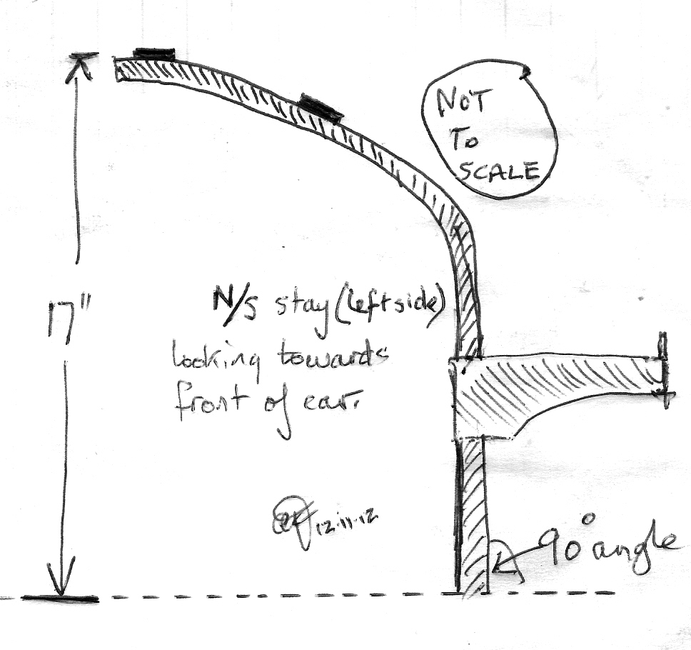

I've attached a scan. What does your good off-side (right) bracket measure from end to floor as in the picture if held vertical?
P.S. 17 inches is about 432 mm.

Good drawing, tomorrow i will send you that degree!

the dergee is 472mm. are there several mudguard stay?
Marcel.
