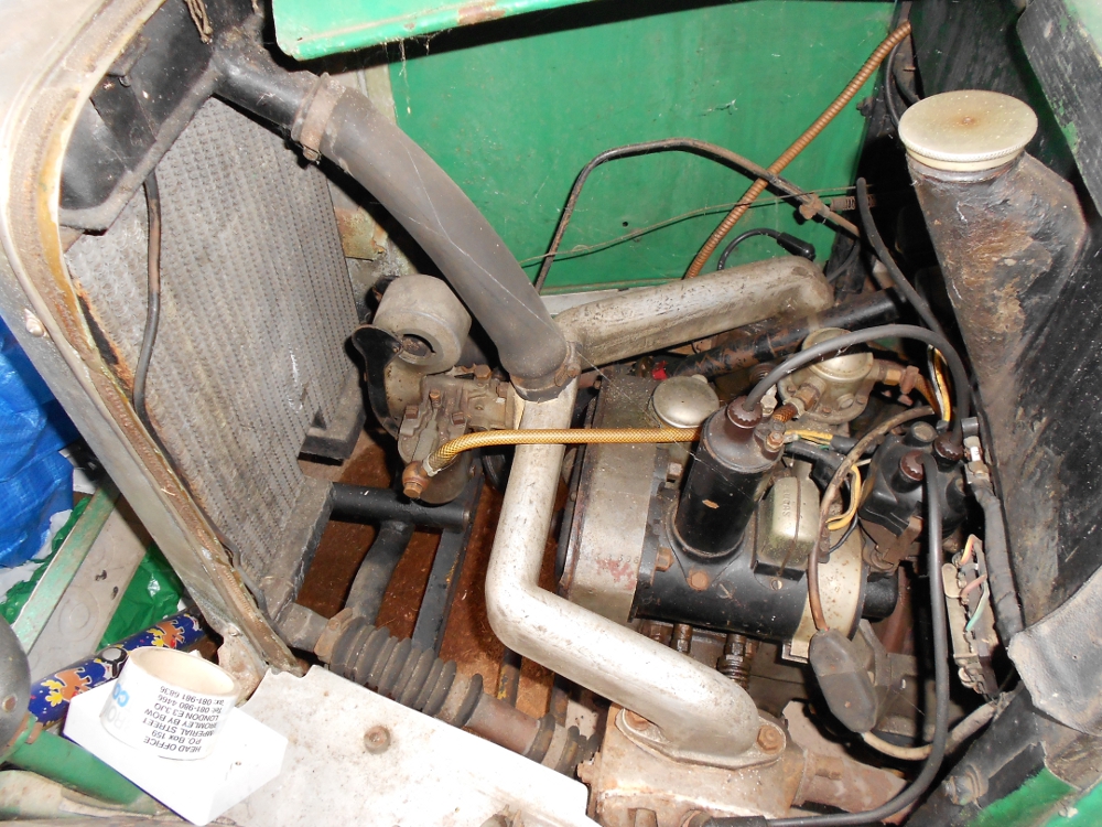

The throttle linkage has a brazed joint in it and then a large hump about 4 inches above the carb. Very odd looking and flapping around. The pivot through the carb lever is a threaded part of the rod, forming the bearing. I have found some nice brass ball joints online which I can use at the carb end. The pedal itself is a lot lower than the clutch. Is this right, or should they be level?

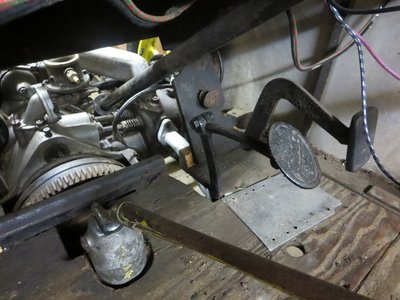

The accelerator isn't connected in this picture of the old floor (now replaced) which had slots crudely cut to bring the pedals back further. The brake was impossible to get a foot on and the lever had gone over centre. I have had to cut a short slot in the new floor for the clutch to get enough travel, but it is still comfortable and lower than the brake, which now sits vertical.
I notice on the parts list the clutch pedal is bolted straight to the shaft at the bell housing, but this car has a cross shaft running under the floor with linkage to the bell housing shaft.

the vintage cars did indeed have the clutch pedal attached to the clutch shaft in the bellhousing but the 30's models had the shaft as you describe. It looks as if a lot of work went into the 'conversion'

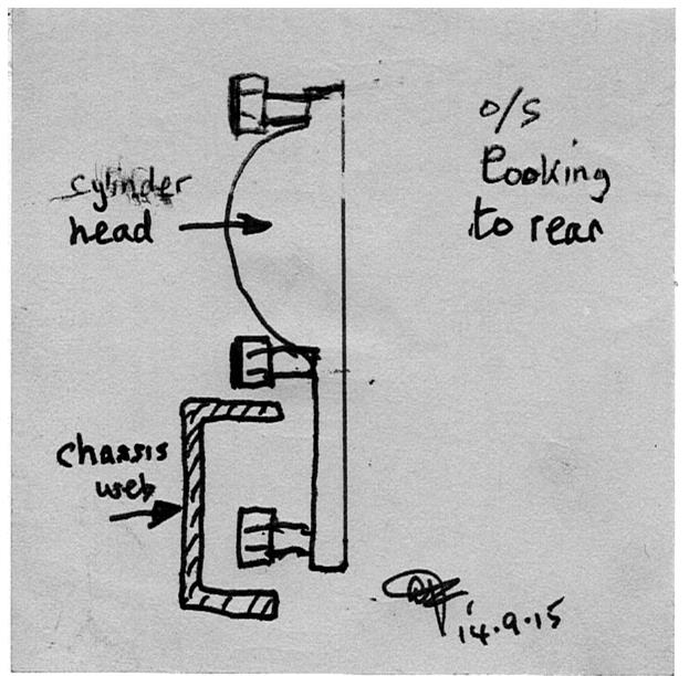

- Posts: 1743
Hi Barry.
I've just been to the garage to check the cylinder head on 'Mary Ellen' (1934), and I've made a rough sketch of the position of the head relative to the chassis web cross-section. You will see that there should be enough room to take off the head if the studs are of original length. I presume the front wings are still off the car.
The cylinder mounting bracket look a bit odd.

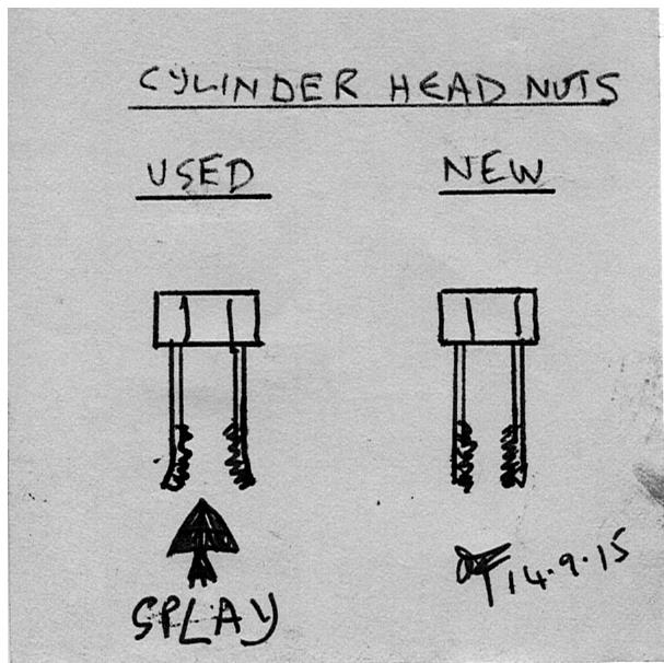

It pays to use new cylinder-head nuts if the old ones are splayed by being used time and time again. There won't be enough grip in the threads to really tighten them down. Tony.

I'll see if Jowett Spares have the head nuts, so thanks for the tip. I missed calling them tonight to ask about track rods.

I assumed I had half a 1930s throttle rod connected to half a 1929 one. Looking at it now, I think it's just a shortened 1929 rod, but the large raised hump causes the whole thing to flap about and this has damaged the lever on the carb already. Thanks for pointing out the picture of the kestrel. I will fabricate one along those lines.

Tony, is your accelerator level with the clutch for more comfortable driving, or did the later cars have the throttle to the right?

it looks as if you just need to make up a more or less straight rod with a bend at the carb end to line up with the throttle arm aand a thread at the other end for the pedal. Have never seen one with a hump an can't see why it is required so suspect the hump was simply an cack handed attempt at shortening the rod!
Accelerator moved to right for 1935 model cars , not sure when on commercials but probably 1936 models

On my 1930 engine the throttle rod is as George describes but it has a bend in the middle so that in part it lays along the top of the inlet/cooling manifold.
This did show some signs of slight chafing on the manifold so I have put a bit of rubber tube over it at this point.
So -straight through the floorboards, bend along the manifold (with a rubber sleeve), bend back to align with the throttle arm where it is simply bent over for about 1" and drilled, with a split pin to keep it in place. Just like the brake rods.

Yes the accelerator pedal, between the clutch and the brake pedals is at the same height on my '34.
I will try to photograph the rod from the side and the top in the next couple of days and post it here.
As I said at the beginning of this saga all those months ago, the 'alterations' seem to be a right mishmash.
The brake pedal looks vintage whilst the clutch pedal seems to be pre-war as you've mentioned.
The lever to the gearbox on the latter, on my '34 lies against the footboard on the engine side, and this helps in the adjustment of the clutch toggles.
The brake lever may be just a tight fit at the bottom end, so keep the bolt tight after you've adjusted the brakes.
