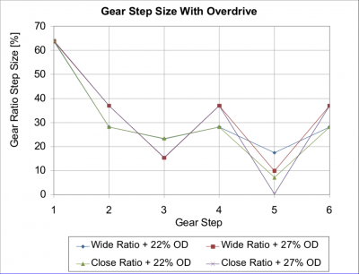

I too am interested in overdrive conversions for my Jupiter [877], and if as you say the LH version fits without chassis modifications, then that sounds like the optimum way to go. Presently, I have a GKN J-Type overdrive which was intended to be used with the modified gearbox mainsheet and adapter plate from a batch that, I believe it was Ken West if memory serves, had made many years ago. I have not actually built this up into a gearbox, as you can see from this photo, but that was the intent:

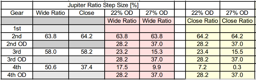

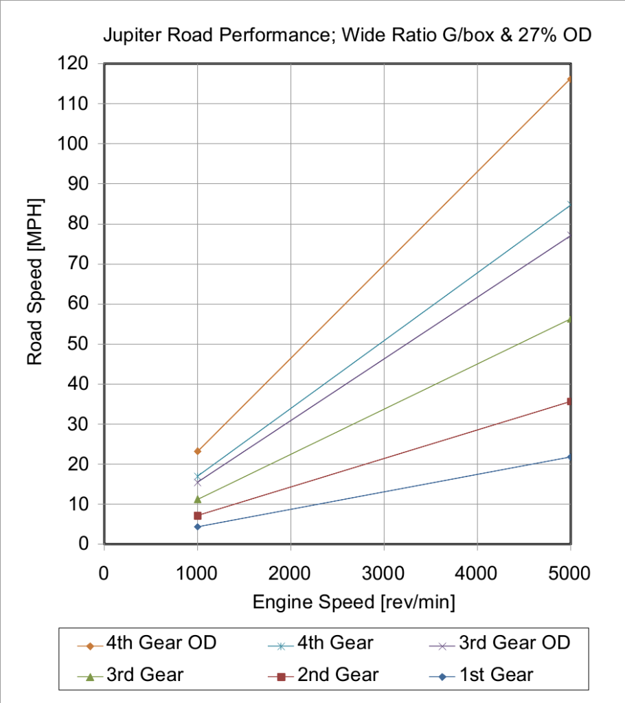

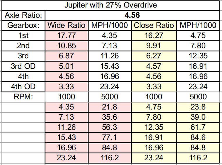

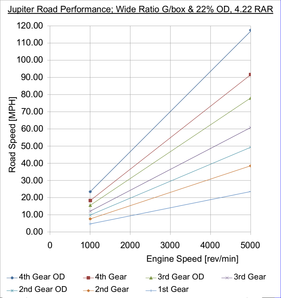

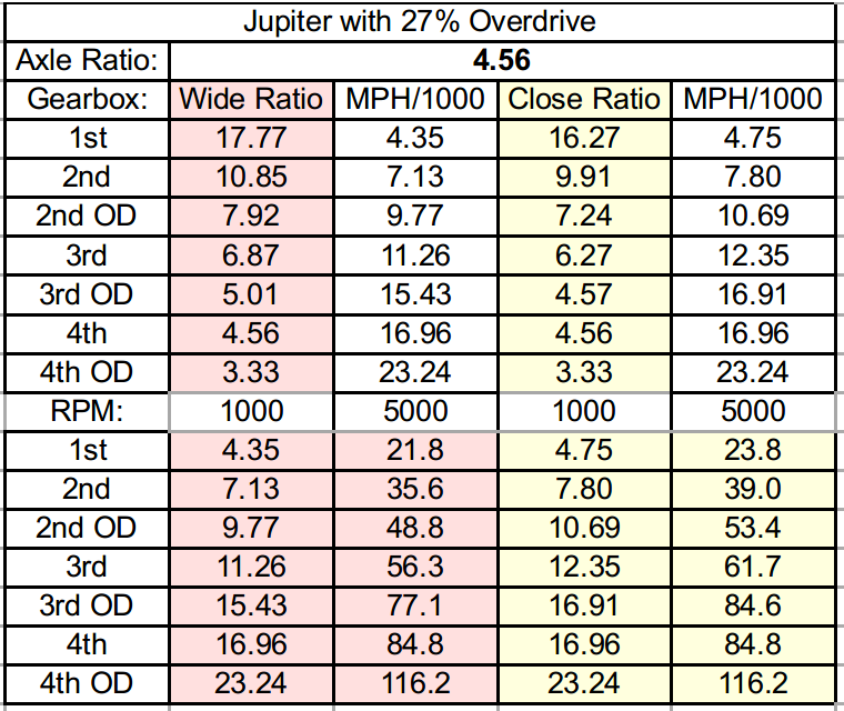

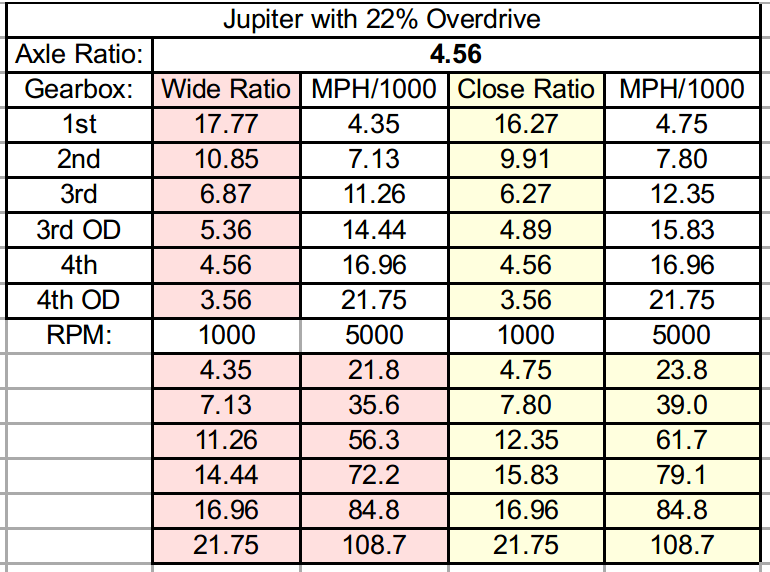

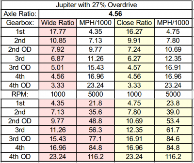

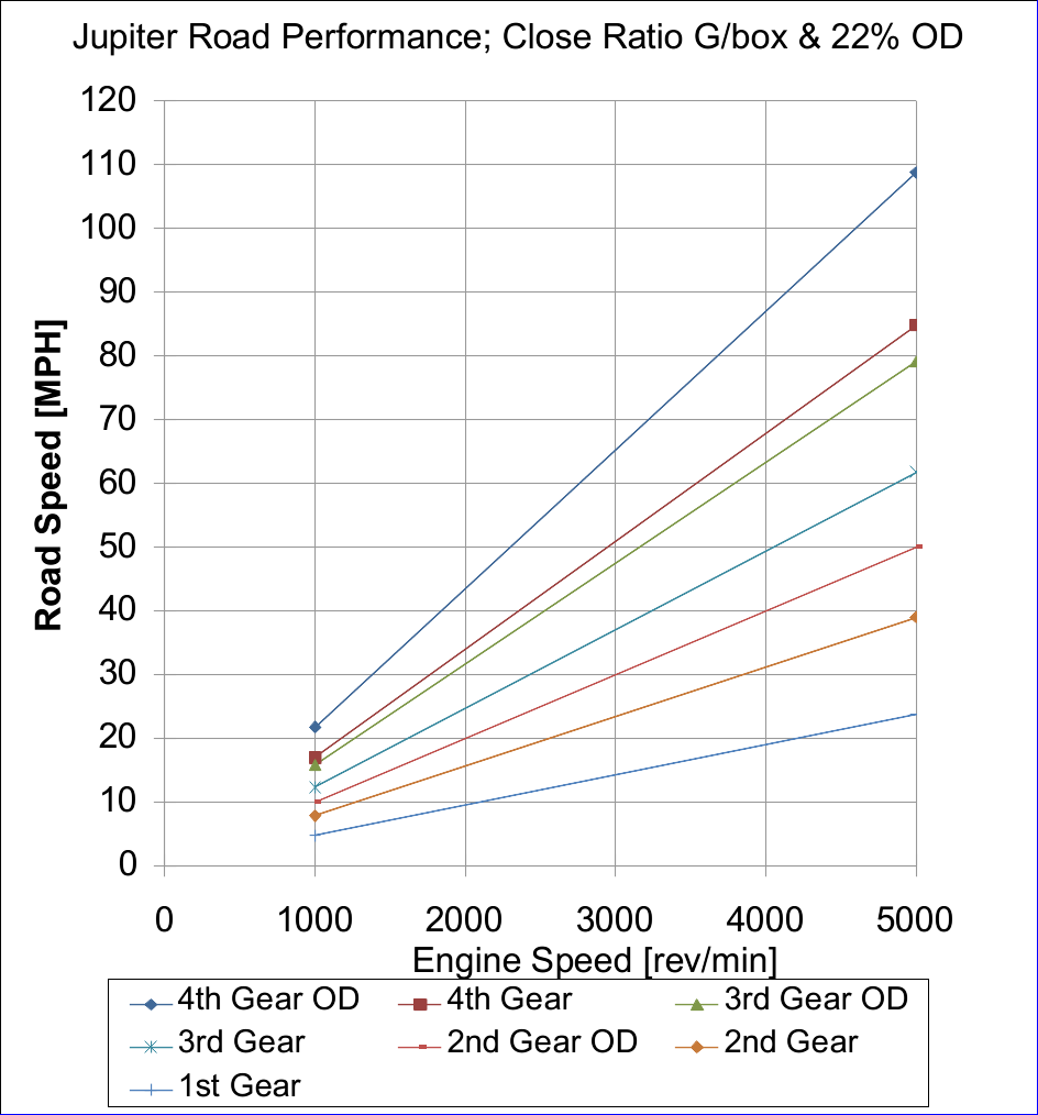

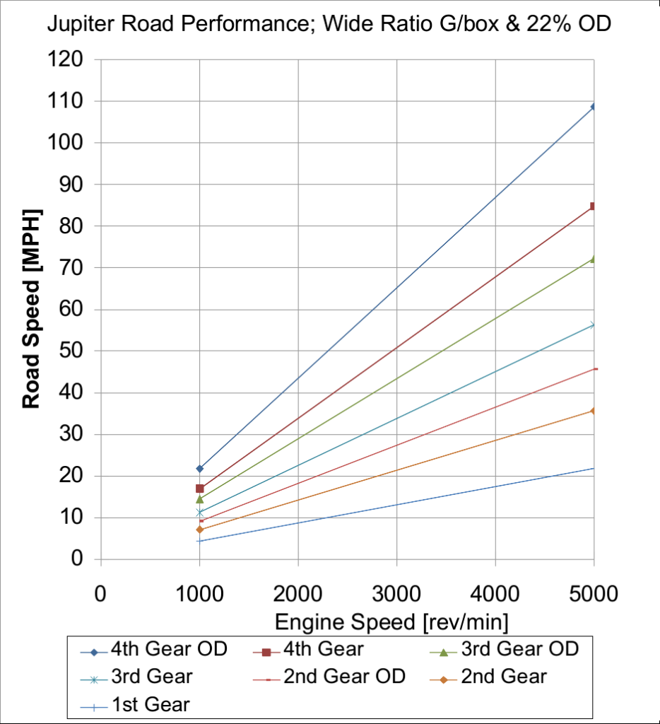

One of the things that I have done is to look at whether the overdrive goes best with a wide ratio or a close ratio gearbox and to that end I have assembled the basic data and plotted the ratios for both gearboxes. This compilation assumes the standard Jupiter axle ratio and tire size; I can adjust the input data to address non-standard ratios:

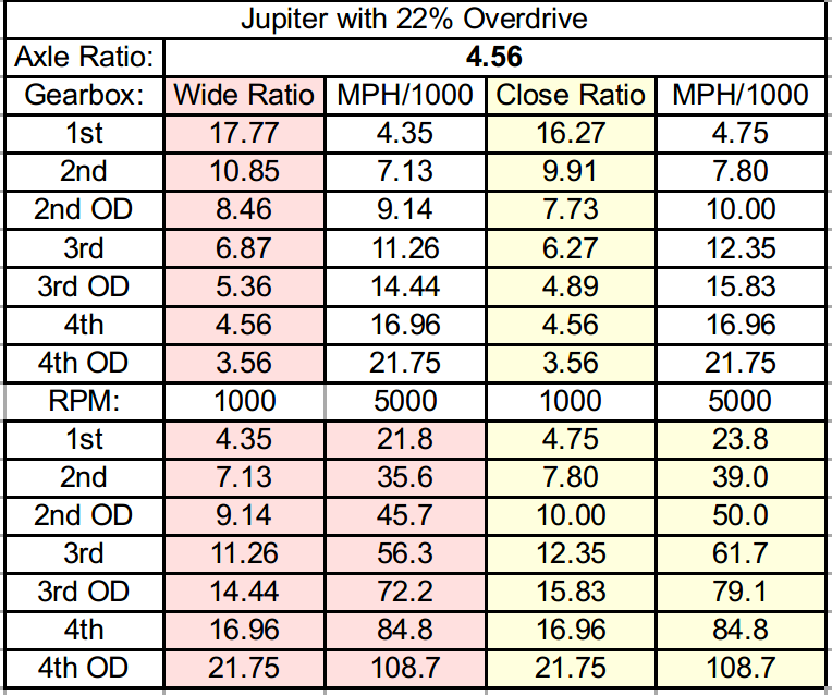

The gear ratio step size graph needs some explanation: It is plotting the step size from 1st gear to the next higher gear, and then the next gear, etc. including the overdrive ratios expressed as a percentage. Usually, in the normal driving range, a step size around 30% is a good target. In this case, I have plotted two overdrive ratios: 27% which is available from some J-Type OD's, and 22% which I think the LH-Type unit has, based on what I have read here: https://www.v8register.net/subpages/tec ... rdrive.htm Is this your understanding of what the LH ratio is?
What this graph shows is that the 22% OD when mated with the wide ratio gearbox (i.e. Meadows box or very late LCL box) looks like the best combination to shoot for. It also shows that the worst combination would be the close ratio box with the 27% OD since 3rd OD and 4th gear direct are essentially identical ratios so that OD on top gear is the only benefit.

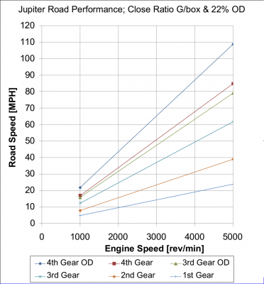

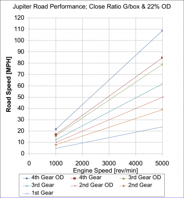

I then plotted the ratio combinations out individually:
Looking at these graphs, you can see that there is a nice spread between the ratios in the case with the wide ratio and 22% OD, while the others and particularly the close ratio and 27% OD are less favorable. Without groveling under the car, I can't remember what box is in my Jupiter at present, but fortunately, I have three wide ratio layshaft gear clusters here that are NOS from either Barnet & Small at Farnham, or Clarkes of Pirbright when I bought up much of their remaining stock in circa 1970.

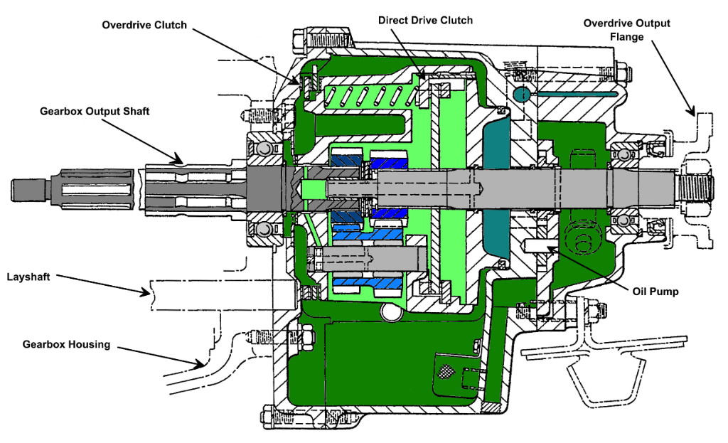

Changing tack slightly, the De Normanville type overdrive as manufactured by Laycock GKN is quite a nice unit, but may not be the only OD available. I am aware that Self-Changing Gears Ltd. of Coventry, who were a respected manufacturer of epicyclic [or planetary if you prefer] gearboxes for buses and military vehicles such as tanks, also designed an overdrive unit as shown in the attached figure. I have no idea if it was ever in production or who used it, but it also looks to be reasonably compact, and one would assume well made. Does anyone know if this unit is available or any details on it?
When your conversion scheme is further along, I would like to get more details on it.

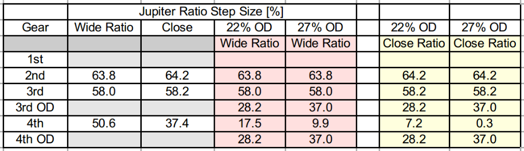

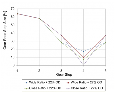

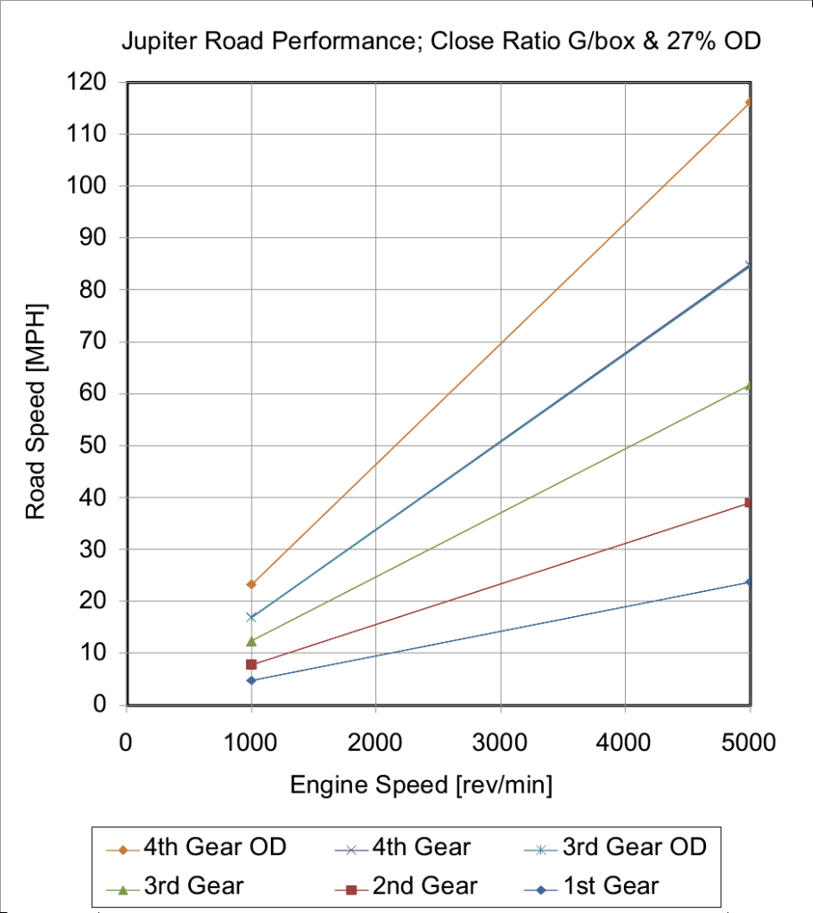

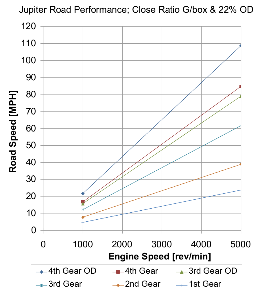

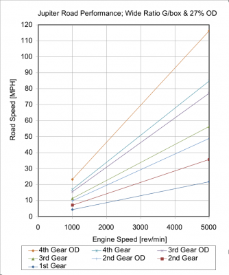

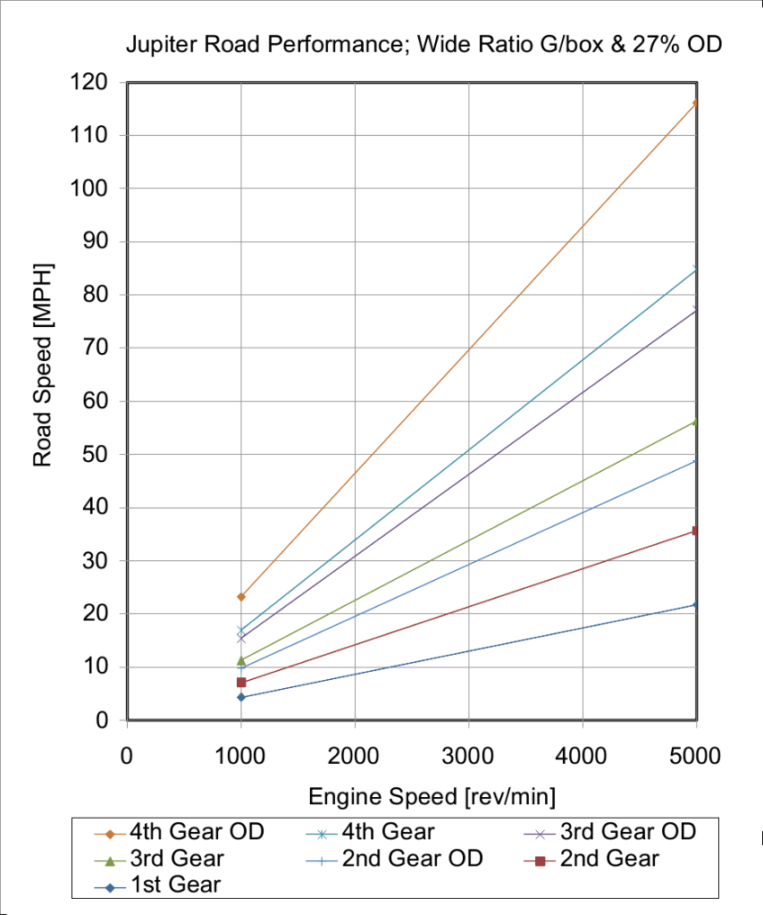

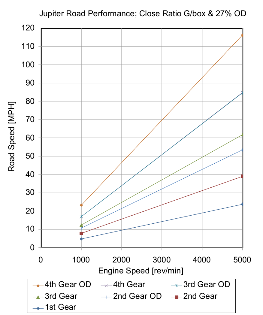

Taking your comments to heart, I have re-plotted my graphs to show the impact on overall ratios of overdrive OD on 2nd gear. Again, as you would expect, the wide ratio with the 22% OD ratio gives very nicely spaced ratios and would be the combination to go for.

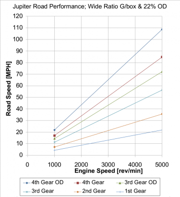

All of these graphs have been plotted using the standard 4.56:1 rear axle ratio, and with the 22% OD this indicates an engine speed of about 3,250 rev/min at 70 mph road speed. This is OK, but better still would be to have the 70 mph motorway cruising speed coincide with peak torque since that is where engine are typically at their most fuel efficient. From the standard Jupiter engine performance curve below, peak torque is at 3,000 rev/min and so to get the desired relationship a change in rear axle ratio is required. Looking at the possibilities with the current 9-tooth pinion, indicates that a 4.22:1 ratio is possible with a 38 tooth crown wheel; slightly different ratios are available using the 8-tooth pinion of the Javelin.
Of course, changing the axle ratio assumes the availability of alternate crown wheel & pinions, but I believe that the Javelin uses a 38-tooth crown wheel, so possibly a Jupiter pinion with a Javelin crown wheel would give you the ideal 4.22:1 ratio. That might be pushing things a bit since I see that the R4 which was a lighter car used a 4.44:1 RAR.
I also recall that in an earlier discussion on JT about overdrives that someone noted that with the potential increase in vehicle speed plus the reduced engine braking effect, they recommended the fitment of a brake booster which sounds sensible.

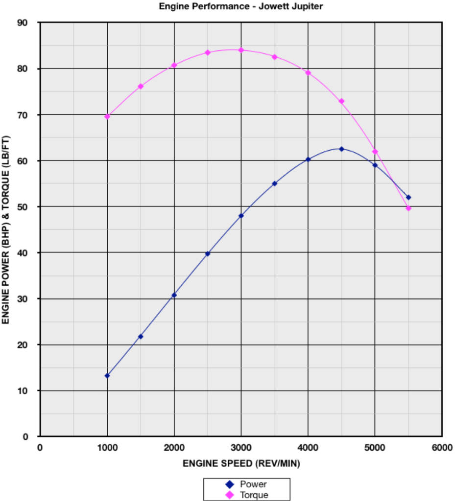

My curves are all based on the original Jowett engine performance data and that forms a good baseline. However it is easy enough to plot a new set that is based on more up-to-date information, such as the rolling road data generated on your car that you have posted previously. This at least appeared to be corrected for temperature and humidity whereas Harry's dyno graph is not corrected information, so I would be loath to trust it.

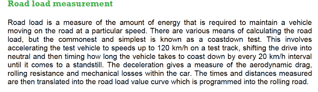

In the absence of a reliable Cd value for the Jupiter, the other useful data would be to develop a Coastdown curve as discussed below, and elsewhere:
This takes account of wind resistance as well as all the rolling resistance factors.

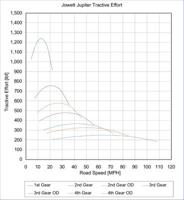

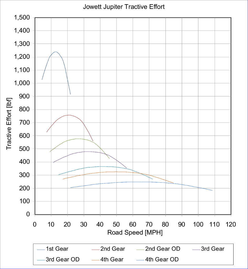

This next curve that I have plotted is the available tractive effort for the standard Jupiter assuming the preferred wide ratio gearbox and the 22% OD on 2nd, 3rd, and top gears. This shows the force available at the road wheel to actually propel the car against the resistances:

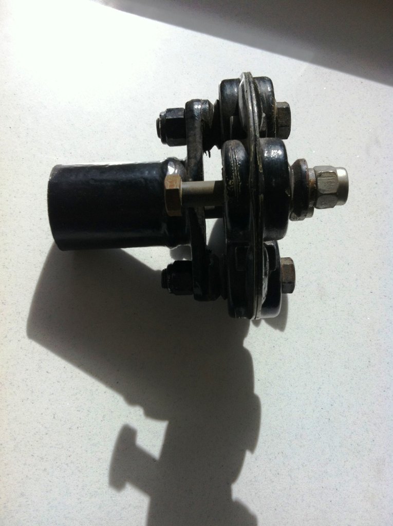

Hi I have fitted a D type overdrive to my jupiter while restoration was in progress. The joac club sells the adaptor plate to mount to the gearbox. Using a Spitfire overdrive rear mounting fixing to a 40mm box cross tube to flanges. Got proshaft modified, now with hardy spline & using spitfire drive flange. Gearbox was rebuilt using correct gear ratios & a remachined drive shaft. All fitted together very easily. Photos aplenty
Chris taylor
D type
D type

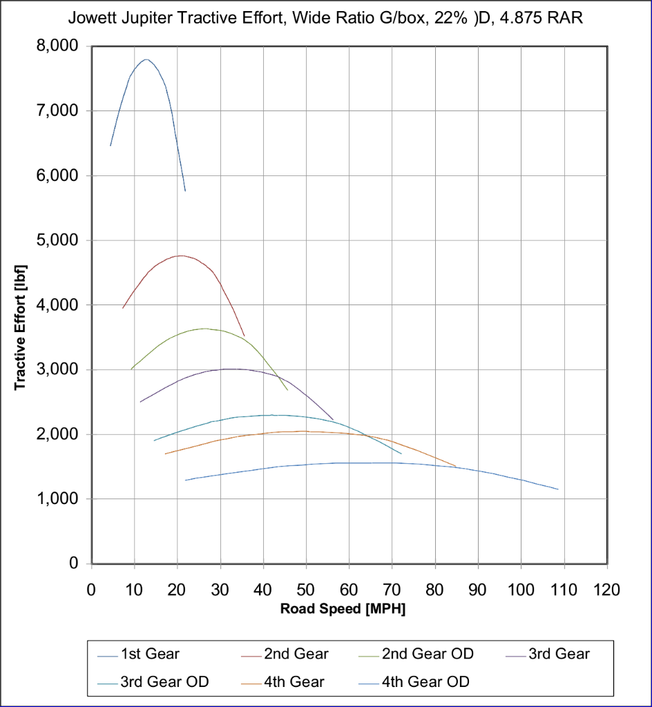

I need to make a correction to my post #272 above with the Jupiter tractive effort curve. I got the rolling radius wrong [by a lot]; the correct curve is here:
Fortunately, tractive effort is relatively abstract, but we want to propagate correct information!

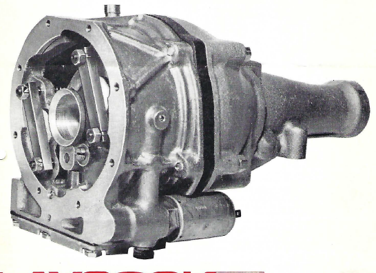

FYI, here is a Laycock-GKN Overdrive brochure that I picked up circa 1970 probably at one of the London motor shows.
This brochure was obviously intended for the sort of motorist who might be interested in improved fuel efficiency, quieter cruising and more gears, nevertheless I find the explanation of how the device works far from easy to understand. The list of cars that were available with the OD is quite extensive.

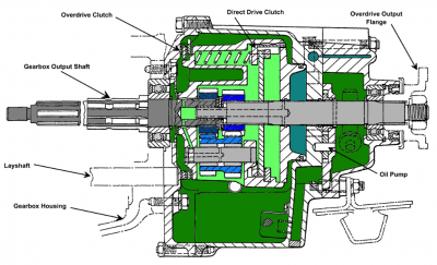

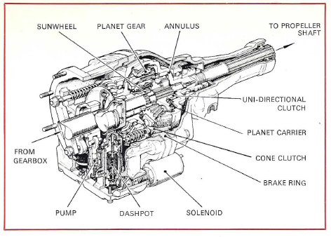

The Laycock unit
I think the diagram should show how drive is transmitted in reverse and overrun in both in and out of overdrive. The operation of the roller clutch and cone clutch are interesting. An explanation of what happens in reverse in overdrive would help understand why not to use it. Only useful when retreating from a charging elephant!

The overdrive gears are epicyclic and consist of a central sunwheel meshing with three planet gears, which, in turn, mesh with an internally toothed annulus.
All gears are in constant mesh. The planet carrier is splined to the input shaft and the annulus is integral with the output shaft.
The extension of the gearbox main shaft forms the overdrive input shaft and power is transmitted by this to the inner member of the uni-directional clutch through a series of rollers which are driven up inclined faces and wedged between the inner member and annulus.
A coned clutch is mounted on the externally splined extension of the sunwheel and is loaded on to the annulus by a number of springs which have their reaction against the casing of the overdrive unit.
The spring load is transmitted to the clutch member through a thrust ring and ball bearing. This arrangement causes the inner friction lining of the cone clutch to contact the cone of the annulus and rotate w ith it whilst the springs and thrust ring remain stationary.
Since the sunwheel is splined to the clutch member, the whole gear train is locked, permitting over-run and reverse torque to be transmitted. Due to the design of the sunwheel teeth, additional load is transmitted to the clutch member during over-run and reverse.
IN OVERDRIVE
On operation of the overdrive switch, the resulting build-up of hydraulic pressure causes the sliding cone clutch to move forward so that the outer friction lining is in contact with the brake ring. The sunwheel to which the clutch is attached is therefore held stationary.
The planet carrier rotates with the input shaft and the planet wheels are caused to rotate around the sunwheel and drive the annulus at a faster speed than the input shaft. The rollers of the uni - directional clutch are now driven down their inclined faces and are free to rotate.
THE HYDRAUliC SYSTEM
Hydraulic pressure is developed by a plunger type pump operated by a cam on the input shaft.
The pump draws oil from an air-cooled sump through a suction filter and delivers it via a non-return valve through a pressure filter to the operating pistons, solenoid valve and relief valve. Incorporated in the relief valve is a spring dashpot which ensures smooth overdrive engagement and disengagement under varying conditions. In direct drive a residual pressure of approximately 40 p.s.i. is maintained within the system and is controlled by a relief valve. When overdrive is engaged this is increased to a predetermined operating pressure.
Engaging Overdrive
When the solenoid is energised its valve opens and oil which is at residual pressure is directed to the bottom of the dash pot piston. This causes the dash pot piston to rise and compress the springs, causing a gradual increase in hydraulic pressure until the piston reaches its limit, by which time the relief valve spring has been compressed to its working length, thus giving full operating pressure. This pressure causes the operating piston to move forward overcoming the clutch return spring and engages the cone clutch with the brake ring.
Engaging Direct Drive
When the solenoid is de-energised, its valve is closed by a spring, cutting off the oil supply from the pump to the dashpot. Oil is now exhausted via the control orifice which allows the relief valve spring to relax to its direct drive condition. The dashpot springs continue to move the dashpot piston to its stop, allowing the system pressure to progressively drop which enables the clutch return springs to move the cone clutch gently into contact with the annulus.
