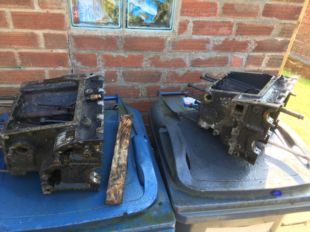

Victory!
Definitely the rustiest engine I have ever dealt with. The crankcases need cleaning properly but, provides the head faces can be cleaned up sufficiently they should be serviceable.

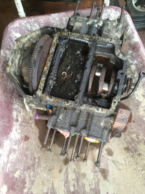

Post by jonathanrippon »
This is the camshaft which shows how bad it was. The followers are still seized in the crankcases!
