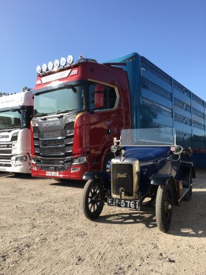

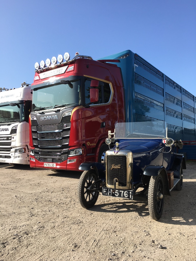

On such a nice weekend, time had to be made for a short run out. Stopped to meet a new Scania 50th anniversary model, quite a comparison. How many days this year will we get out!?
This gave me the chance to drain off the gearbox oil when back in the garage. I will refill with fresh oil in due course, the engine oil being changed when i got the car.
No matter how carefully driven, the gear change gives a slight crunch. Having now driven it several times, i feel it is the operation rather than the driver. So, opinions welcome - fresh oil will help? Clutch needs adjustment- is this easy?

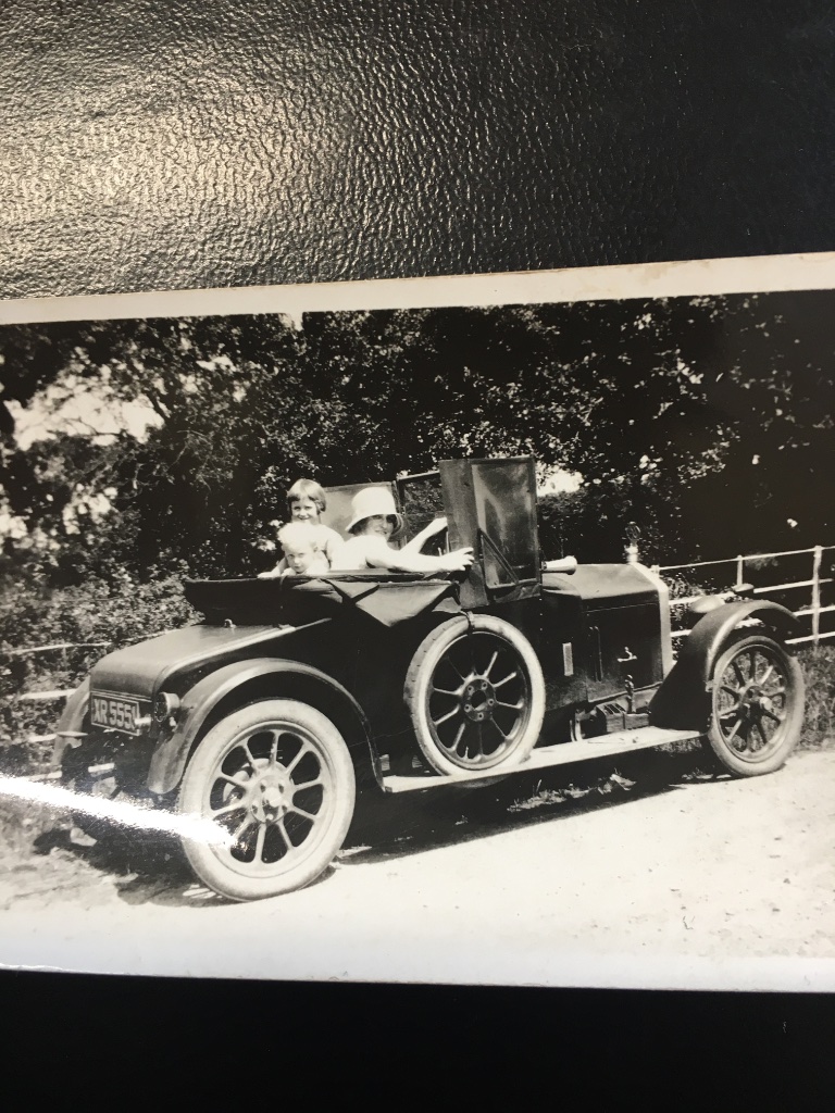

A colleague gave me the period photo, as the car is similar to the Short 2. Can anyone identify the maker?

The car in the period picture is a Wolseley 10 from around 1923.
