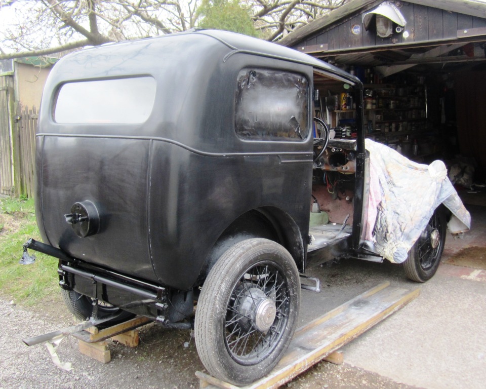

I've managed to spray three coats of the black cellulose over the primer now, and have flatted it back with 1200 and then 1500 grade wet and dry paper.

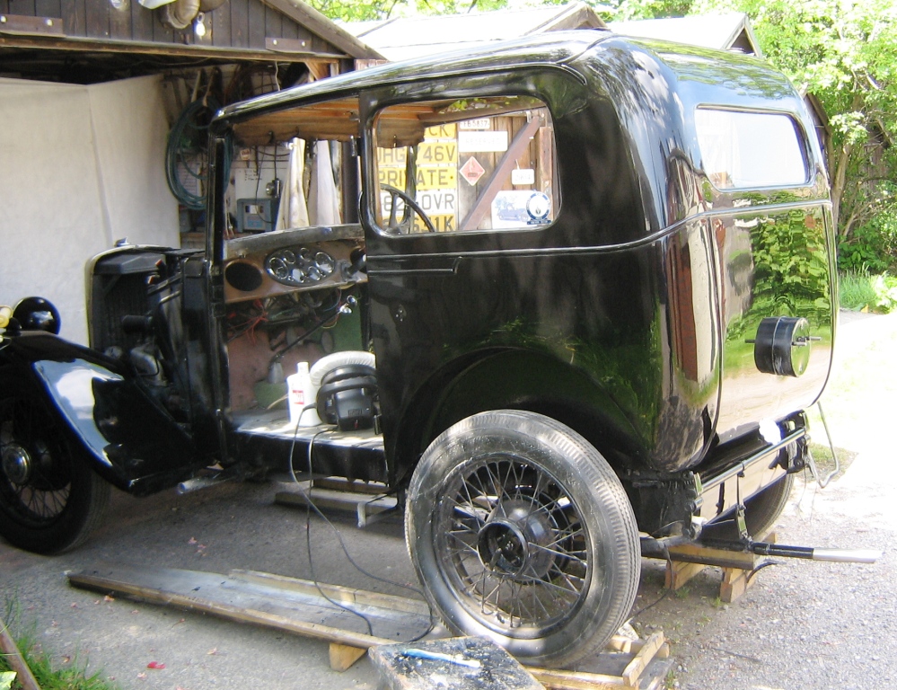

It's Saturday the 8th June 2013 and I've just finished painting and polishing 'Mary Ellen', so I attach a similar photo to one below which shows the not-inconsiderable amount of elbow grease that's been expounded.

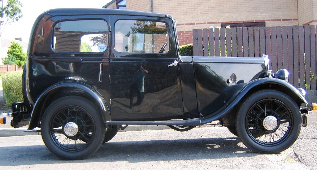

I've found a sign-writer, he hasn't come yet, but I thought I'd just post a photo of 'Mary Ellen' looking all shiny.
