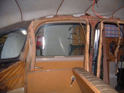

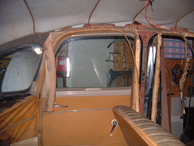

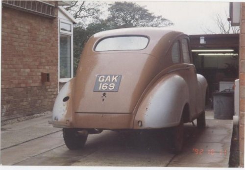

Inspired by Chris Spencers great looking documentation of the early restoration, I am hoping to document my own,. Thankfully there wont be any cutting and grinding as I bought this partway through its restoration already having had the bodywork done, I hope to post requests for comments as I proceed when it comes to some jobs that I am undecided on.The car originally was Brown but has had a Black paint respray in the past which is now in need of being redone so have decided to paint it in a black/cream colour scheme, the interior is brown/tan and needsto be completely replaced so am planning to redo in black and grey and it is here I plan to start first with the roof lining and door cards.I also plan to cover the dashboard in a wood veneer.

The interior does seem to be the first thing people think about. WARNING we have just had to take out all the freshly done interior and all the glass on Peter's car because welding, grinding, sand and soda blasting, spraying and sealing would all risk spoiling the new bits. Add to that the need to take out the floor and boot and all the mechanicals just to get at some of the cracks and bodges for welding. The previous bodge to the rear shock absorber mounting set alight the sound deadening felt, so be warned.
The second thing people do is the paintwork which is then scratched when mechanical or electrical bits have to be taken out again to fix some annoying problem. Best to take the car on a good test drive with an experienced person to identify all the issues, noises and rumblings, smells and non-original bits. Also look at everything very carefully to identify leaks (oil, grease, water , brake fluid), wear, chaffing and electrical issues. Make sure these are fixed before final paint and interior fitting, or even better fix them before you take the car apart.
As I have said many times on the forum, no end of faults can be found (that otherwise would not be) when the car is up on a lift.
I have spent 40 years doing it the other way and wish I had had the sense to do it the way I am now suggesting. But then I was enjoying my car all the time, even during the many problems it gave me through not doing it properly when I first got the car.

Always nice to start with a solid shell - just post any issues that you may have and someone will be along with the answer soon enough - I have a source for headlinings if you are planning on doing it yourself, I also have a contact for recovering seats / door cards and producing carpet sets should you need it.
