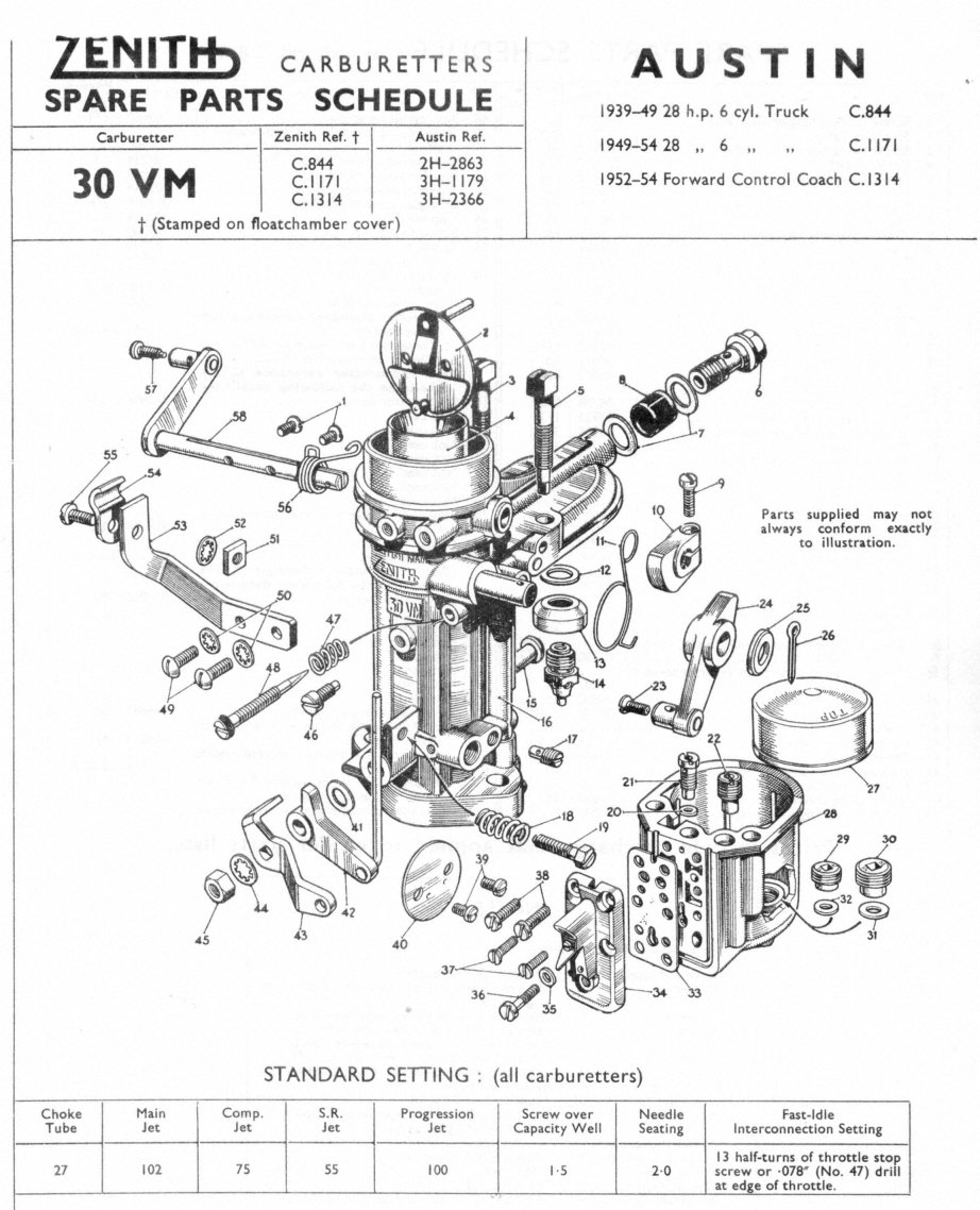

A number of people, including Jaak Jacobs in Belgium, have been suffering carb problems, so I sorted through my 50 spare (scrap) carbs at the weekend. I was surprised to find so many supposedly non Jowett carbs in the hoard. (C1074,C1344, C1343 , C855A, C1461, CS 1194.) They all did come off Jowetts so I guess they all must have worked.
I would be interested to know if anybody else has Zenith carbs with 'C' numbers diiferent from this official list.
Javelin Zenith Contract Sheet Number C1084 30VM-4, C1130 30VM-5, C1161 30VM-5, C1316 30VM.
Jupiter Zenith Contract Sheet Number C1245 30VIG-5, C1316 30VM.
Are any of the non-Jowett bodies and float chambers suitable in a Jowett? Or indeed would any actually be better with modern petrol and tuning?
Whilst doing this survey it would also help if you checked the jets in the carbs as they may have also changed over the years (they will have worn as well of course!)
See http://jowett.net/Parts/TechNotes-Part18-Zenith.htm for details of how they left the factory.
You may also like to see other Zenith carbs here. http://www.stationary-engine.co.uk/Zeni ... thCarb.htm and tell me if you find and equivalent.

I have just looked up on http://zenithcarb.co.uk/cf/vehicle/list ... le=Jupiter
Jowett Jupiter 1950 to 1951 C1245
Jowett Jupiter 1950 to 1953 C1343
Jowett Javelin 1948 to 1954 C1334
So I guess that explains some of the ones I have in stock.
I have not found what jet sizes these variants had though!

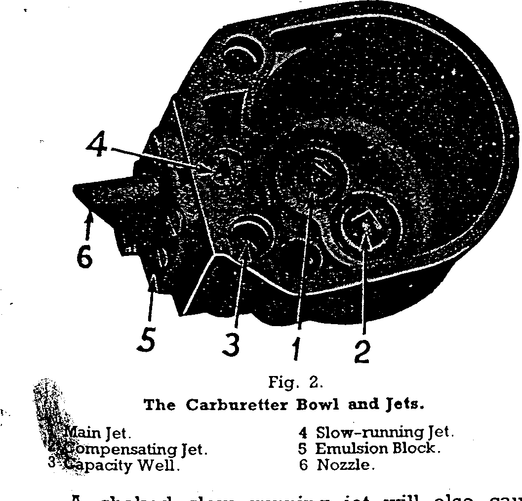

In the Tech Notes Mike Allfrey says this.
I need to make 120 jets and 65 jets to match up with the Jup carbs I am now renovating.
Answered my own question here
jetsize thou.ins. nearest drill sizes
40 016 1/64 or 0.40mm
45 018 77 or 0.45mm
50 020 76 or 0.50mm
55 022 74 or 0.55mm
60 024 73 or 0.60mm
65 026 71 or 0.65mm
70 028 70 or 0.70mm
75 030 69 or 0.75mm
80 032 67 or 0.80mm
85 034 77 or 0.85mm
90 036 64 or 0.90mm
95 038 62 or 0.95mm
100 040 60 or 1.00mm
105 042 58 or 1.05mm
110 044 57 or 1.10mm
115 046 56 or 1.15mm
120 048 3/64 or 1.20mm
Does anybody know the corresponding drill sizes for jet 65?A dramatic improvement was found to be achieved by replacing progression jet, Item 24, with a smaller one. If no smaller jet is available try filling the original hole with solder or 'Easyfile) and redrilling with a 1 mm drill. This gives a jet orifice of 0.040" as compared with genuine jets – Number 110 1.15 mm (0.045"), Number 120 1.19 mm (0. 047").
