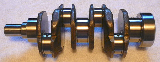

Reading what Edmund Nankivell has written about the saga of broken crankshafts it seems that no one could quite put their finger on why they were so vulnerable to flexure in the flying webs (i.e. the ones with the "missing" main bearing), but evolution certainly beefed up crankshafts in this area. Here is an early Subaru:

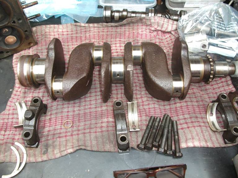

And BMC were taking no chances with the A-series:

The observant may note the undercut radii on the Subaru crank. Many cars adopted this. The fillets are rolled, greatly increasing fatigue resistance. And normally safe from slovenly regrinders who have tightened the radii and ruined so many Javelin cranks.The A series crank is a very late one, but all were a bit like that. Would tend to think that very rigid webs would concentrate deflection adjacent to the centre main. Many modern cars have the crank so well suported that the webs are just thin discs. If anyone has stumbled across textbooks on the subject I would be interested in the reference please.
