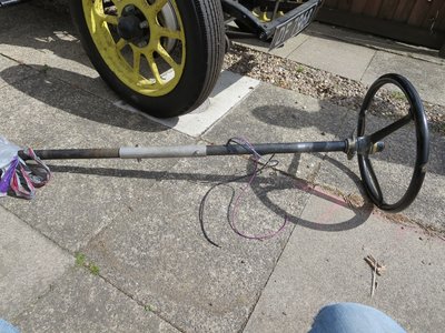

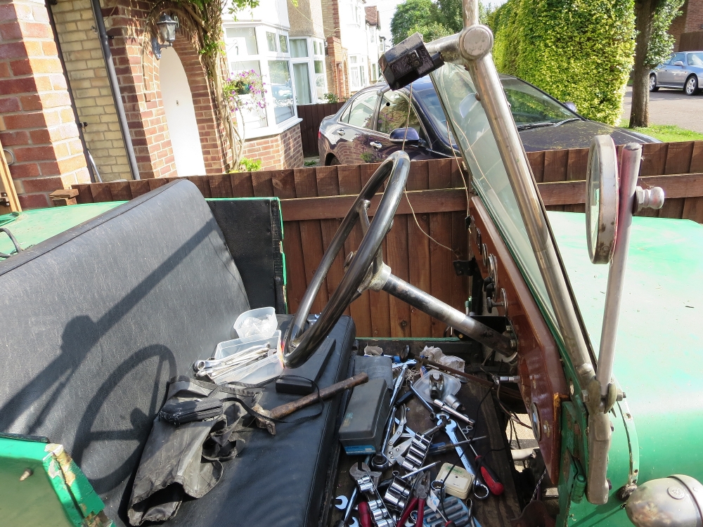

Well the project has taken a quantum leap forward! After a year abandonment due to chronic sleep deprivation, my youngest has not only been sleeping through, but has started preschool meaning I can actually find time to start again, without trying to cope with looking after the kids
As a result, we are now moments away from a test drive ............. I hope. The main thing has been sorting the steering column, which now means I can sit with my legs straight out and get my feet on the pedals. The wheel was so low before, even if you could get your foot on the clutch, your thigh was over the gear lever, meaning it was physically impossible to engage 3rd or 4th gear.
I cut the column and machined a sleeve to extend it by 5 inches, with enough material to give the option of another inch if needed. As the shaft is near 45 degrees, this has also raised it about 5 inches too. The gap between the wheel and steering wheel now looks similar to the 1929 brochure and photos in books, etc.

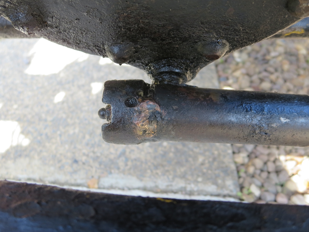

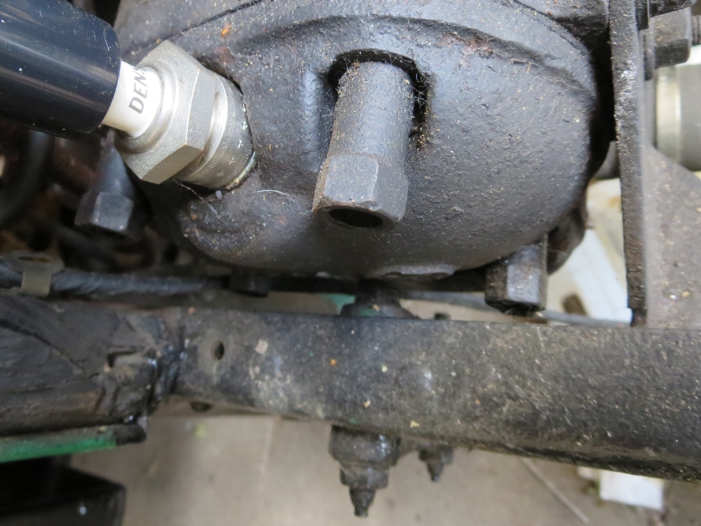

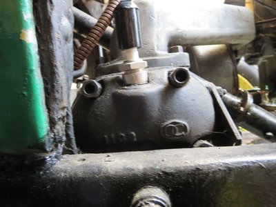

There really is a good 6 inches of slack on the wheel, so I'd like to sort it. I'm not going to be able to get this off without ruining what is left of the joint, so if anyone has a spare rod I could either buy, or at least borrow while I fabricate a new end, I would be very grateful!
I'll also try Jowett Spares on Monday, but I would be grateful for some help identifying what I'm actually looking for. I have a 1935 parts list which shows this type of steering box, but I'm not sure if the 1929 car had the same? Could it be the box was swapped from the 1934 car that donated the engine, gearbox and steering column?
The steering box on your car is definitely the third type which was introduced ?1931 and was used throughout the thirties. The drag link to box joint was the same to 1939 but the shape of the drag link will be different . I have a feeling that the drag link socket may have been the same on the Braadfords as Jowetts tended to not change things that didn't need changing even though the Bradford steering box is different.
Options could possibly be to weld on end from later drag link or use later drag ling rebent/lengthened /shortened as required.
The vintage steering box was bolted rigidly to the chassis ross member but the later silentblock mounted ( as yours appears to be had a threaded rod from the bottom of the box to ?? to limit side movement. When this broke you immediately got 6'' of play at the steering wheel before anything happened. It may be worth checking for movement of the box on its mounting when turning the steering wheel if you have not already done so

Thanks George, that's very useful. I think grafting a joint from another link will be the most straightforward if finding the correct shape and length of rod is going to be difficult. If someone has one with a damaged joint one end, it will be the perfect solution! If the Bradford joints are the same, it will at least widen the search.
You are correct to say the box is held steady with an adjustable rod which in this case is bolted through the chassis rail the other end. It's all very ridged and I can find no play at all anywhere apart from the brazed joint.
