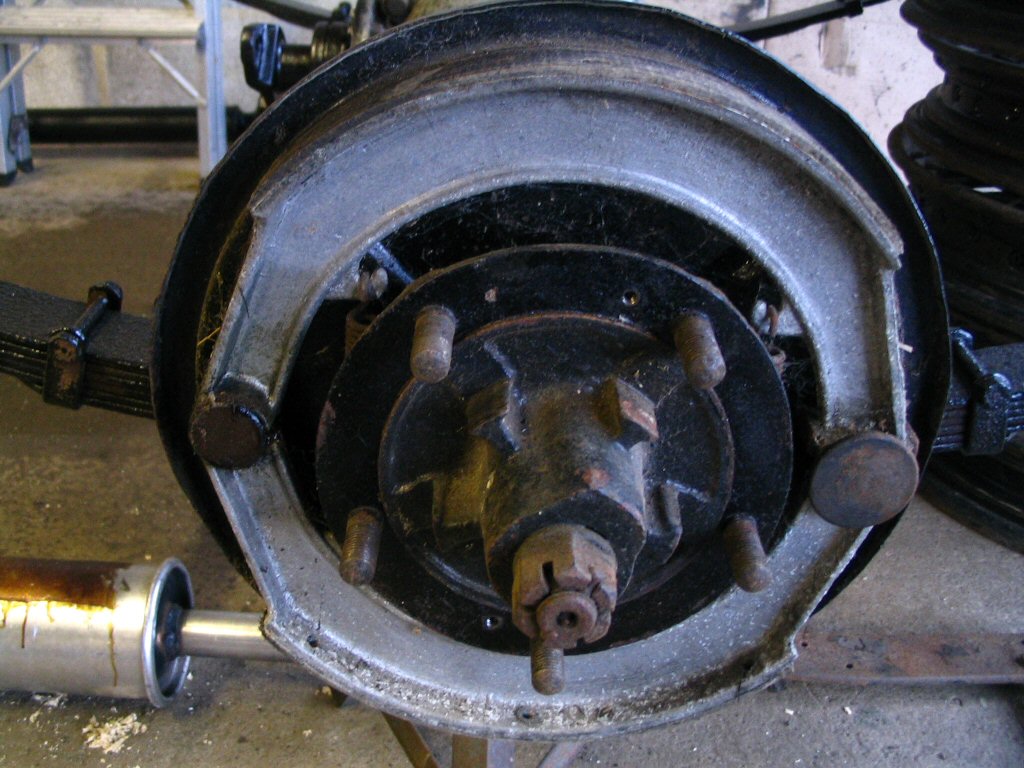

Dismantling, cleaning & painting rear brake components - brake shoes currently being re-lined

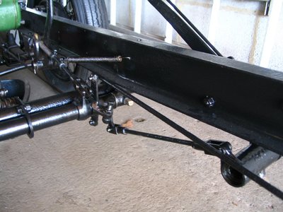

Reassembling brake cross shaft and all rear brake linkages

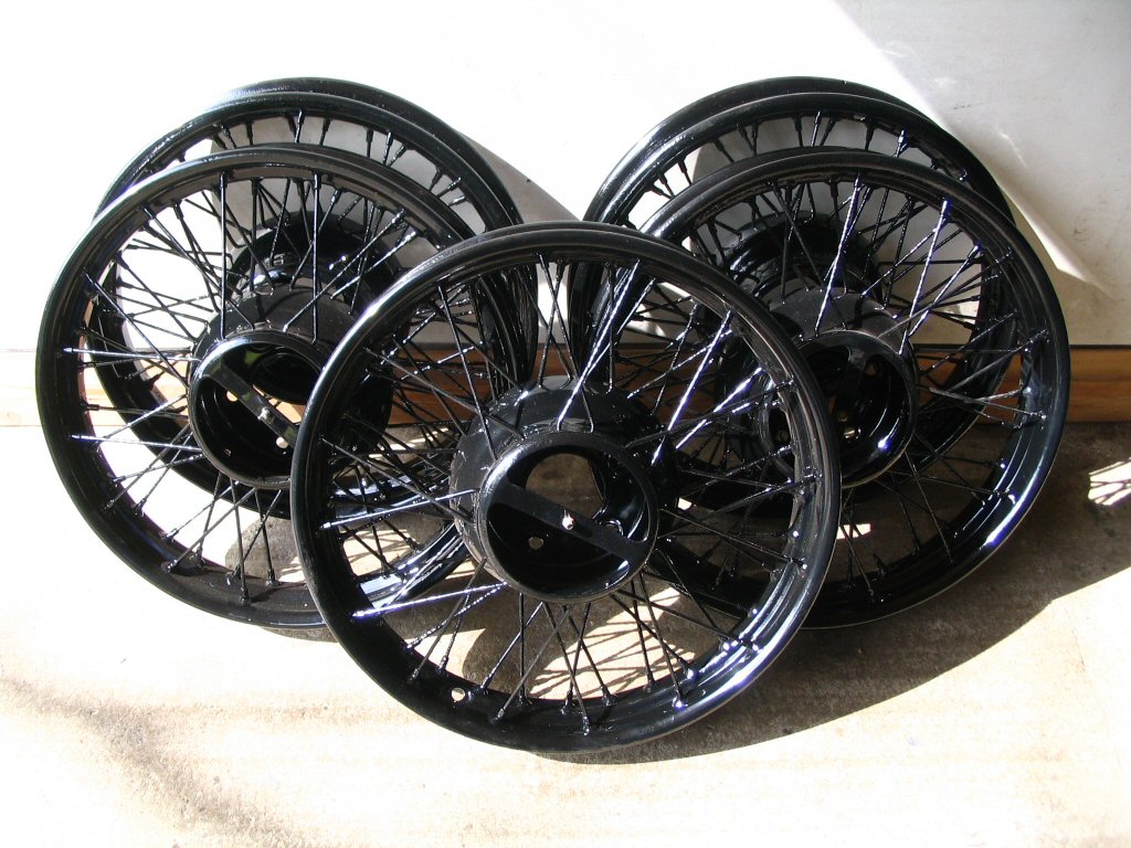

Removing wheels & tires - wheels currently undergoing shot-blasting and powder coating

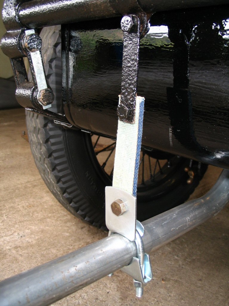

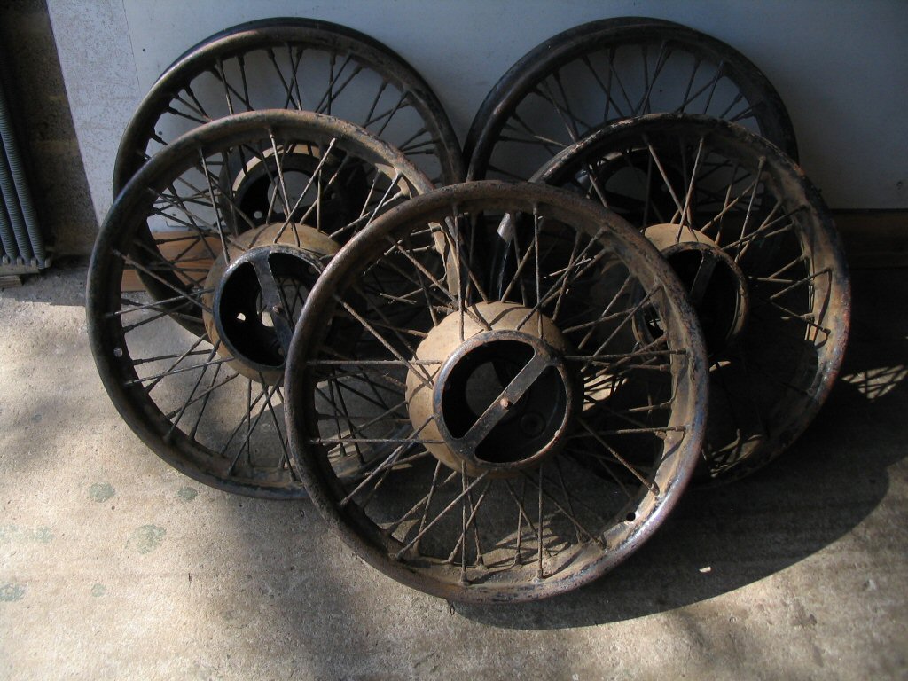

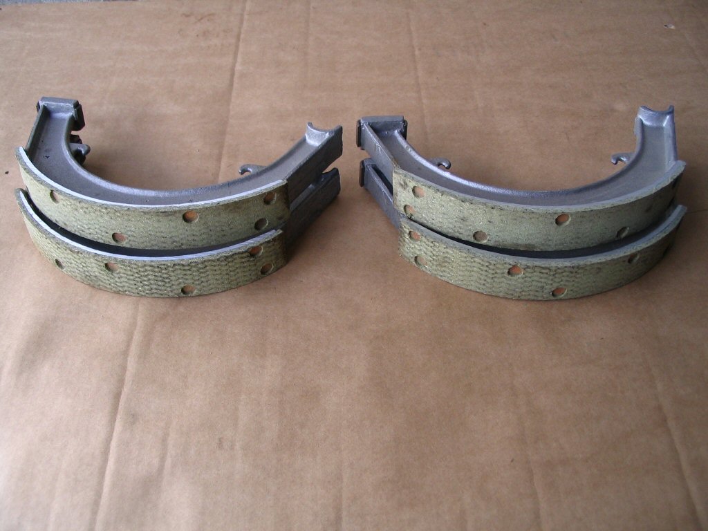

A few more photos:

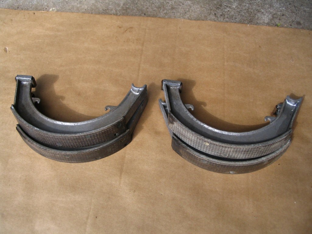

Brake shoes ready for re-lining - note polished rivet on top right shoe
Wheels ready for blasting & coating

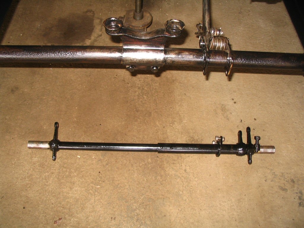

Brake cross shaft cleaned-up painted & ready for re-fitting

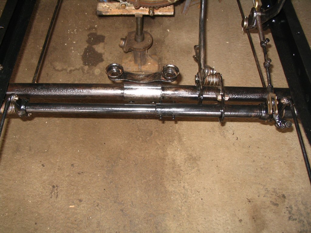

The brake cross shaft has now been re-fitted:
The wheels have been powder coated:

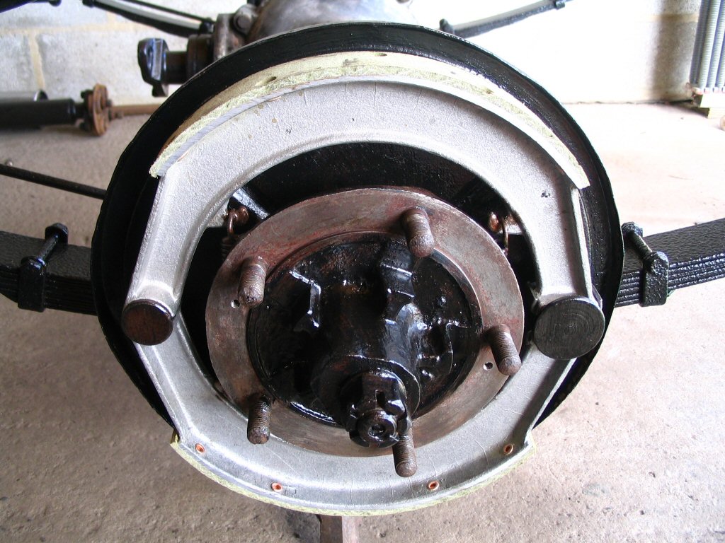

And the brake shoes re-lined:

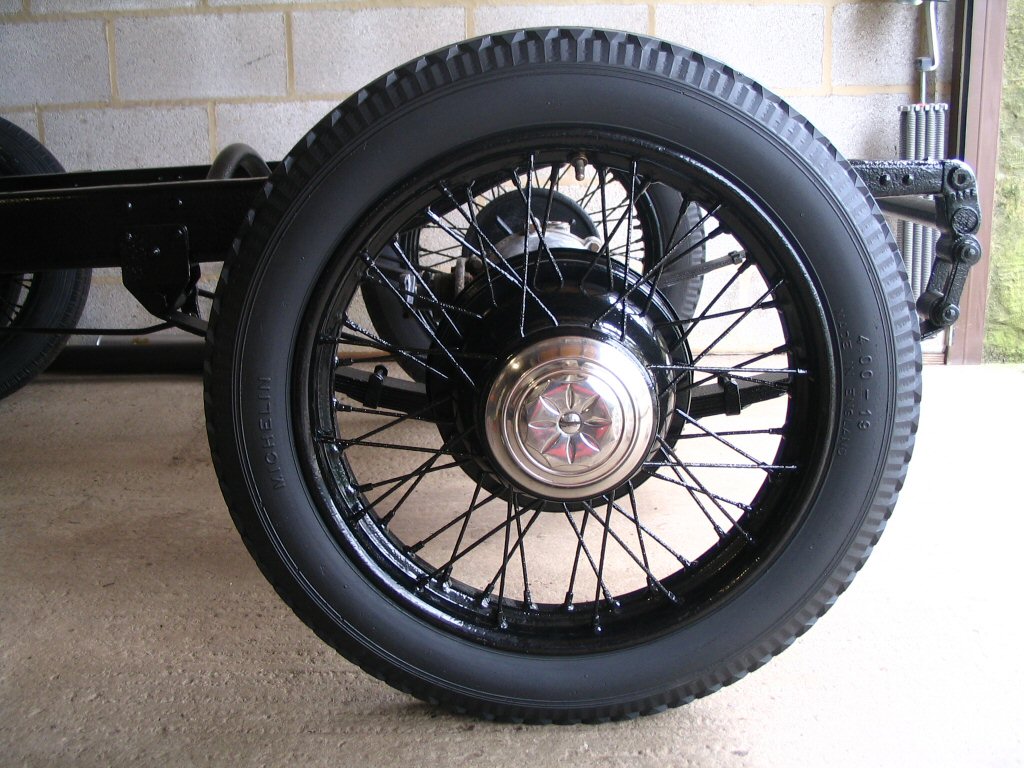

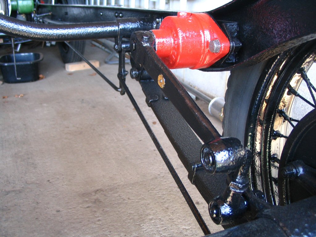

Post by julian »

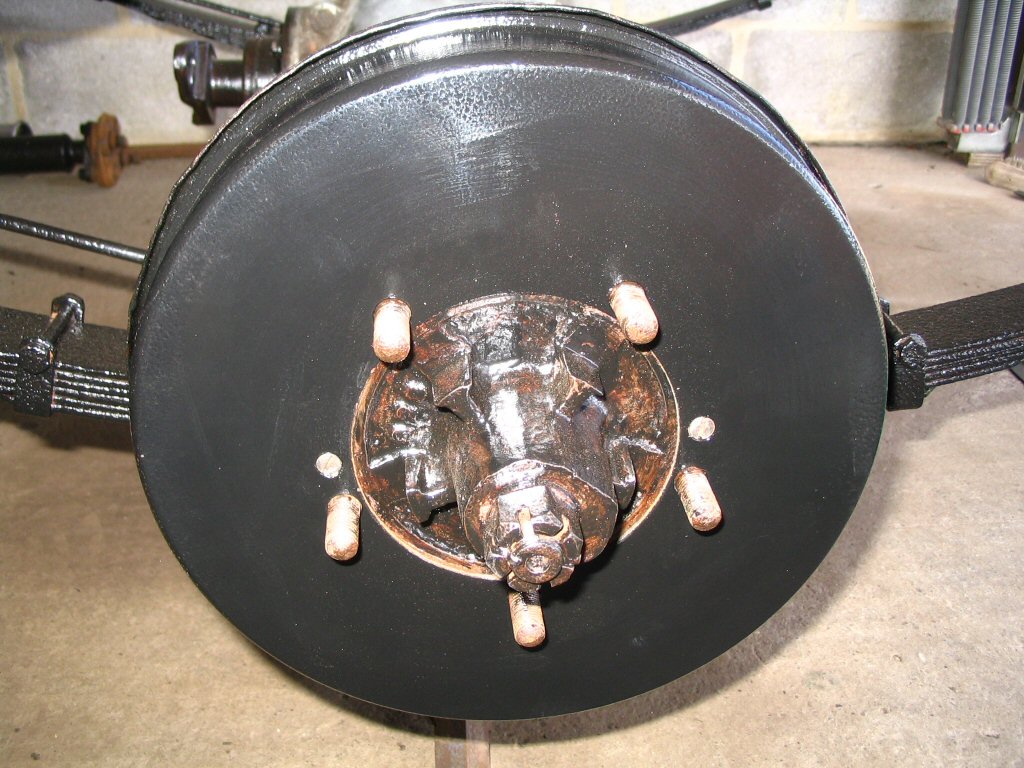

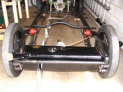

The rear brakes have been re-assembled:
All rear brake rods and linkage arms have been re-fitted and initial brake adjustment carried out.
Tyres and wheels fitted:

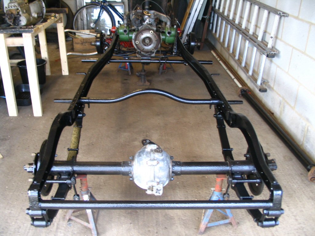

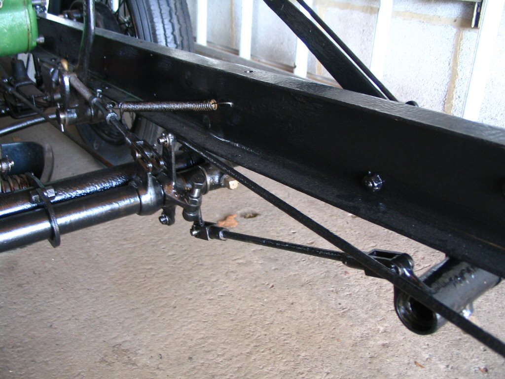

An update on progress is well overdue - so here it is!

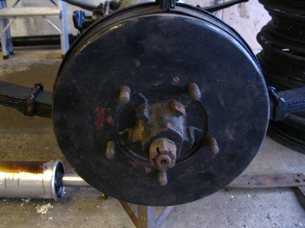

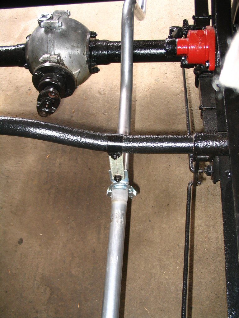

The chassis re-build is nearing completion with the following jobs completed:
Brake linkages and levers cleaned up, built-up and new pins fitted where needed
Hand-brake cleaned up, painted & re-fitted.
Brakes set-up with all 4 wheels off the ground
Rear shock absorbers cleaned-up, painted & re-fitted
Petrol tank cleaned up, painted & re-installed
Petrol gauge tank unit removed cleaned, tested & re-installed.
Petrol pipe polished & re-installed
Last section of petrol pipe refashioned to fit mechanical fuel pump ( previously went to an electric pump).

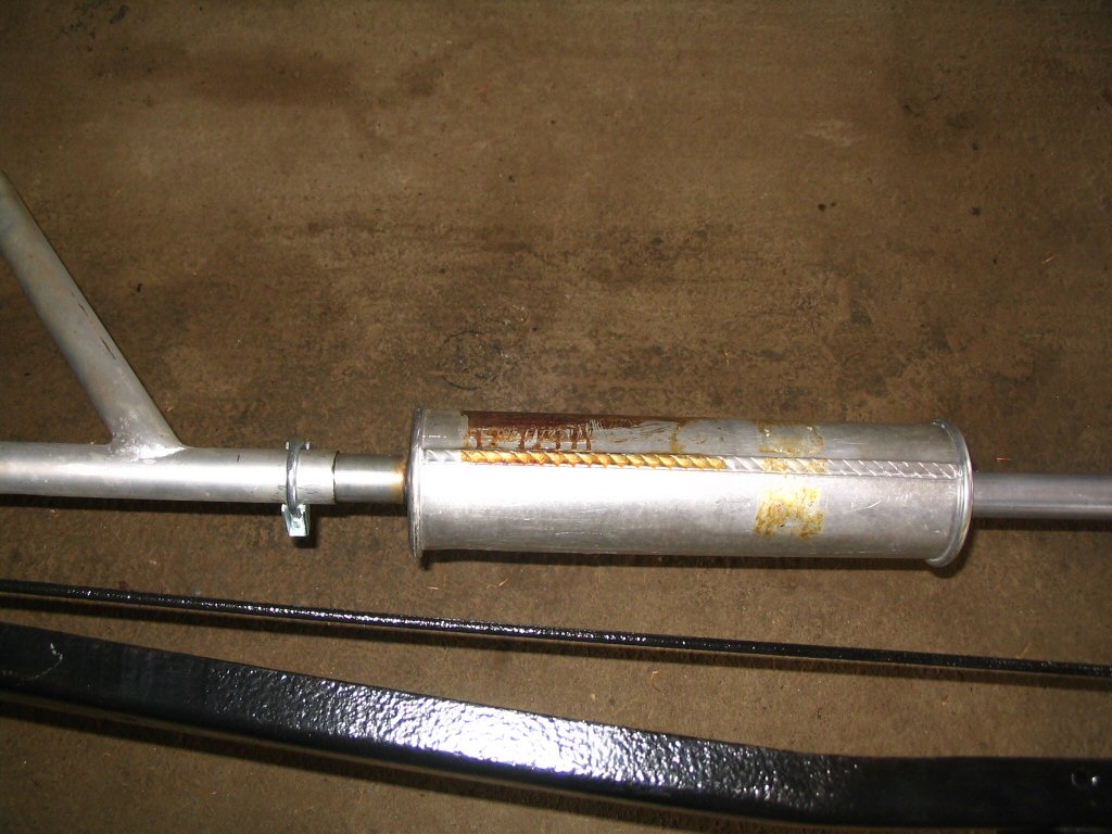

Attention then turned to the exhaust system, which I previously mentioned was taken from all in one part from a Morris Minor. After much measuring and pondering I finally decided to cut the system into a silencer and tail-pipe section with the "hump" reversed in direction to suit the Jowett layout. This of course required the parts to be joined which I did by expanding the section of pipe at the end of the silencer and then inserting the tail section. I positioned the join in line with the cross member from which the supporting strap was mounted.
Photo below shows chassis from the rear.

Here are a few more photos of the exhaust:
I expanded the section of pipe on the silencer by heating up to red-hot and working round with a bar to spread the end slightly. I was then able to hammer in a spare section of tube, a bit at a time, continuously re-heating, until I had a 2" long expanded section. Not something I'd like to do very often as it took over an hour to complete, but it worked out well in the end! There's probably a machine that would do the same job in a few seconds. :?

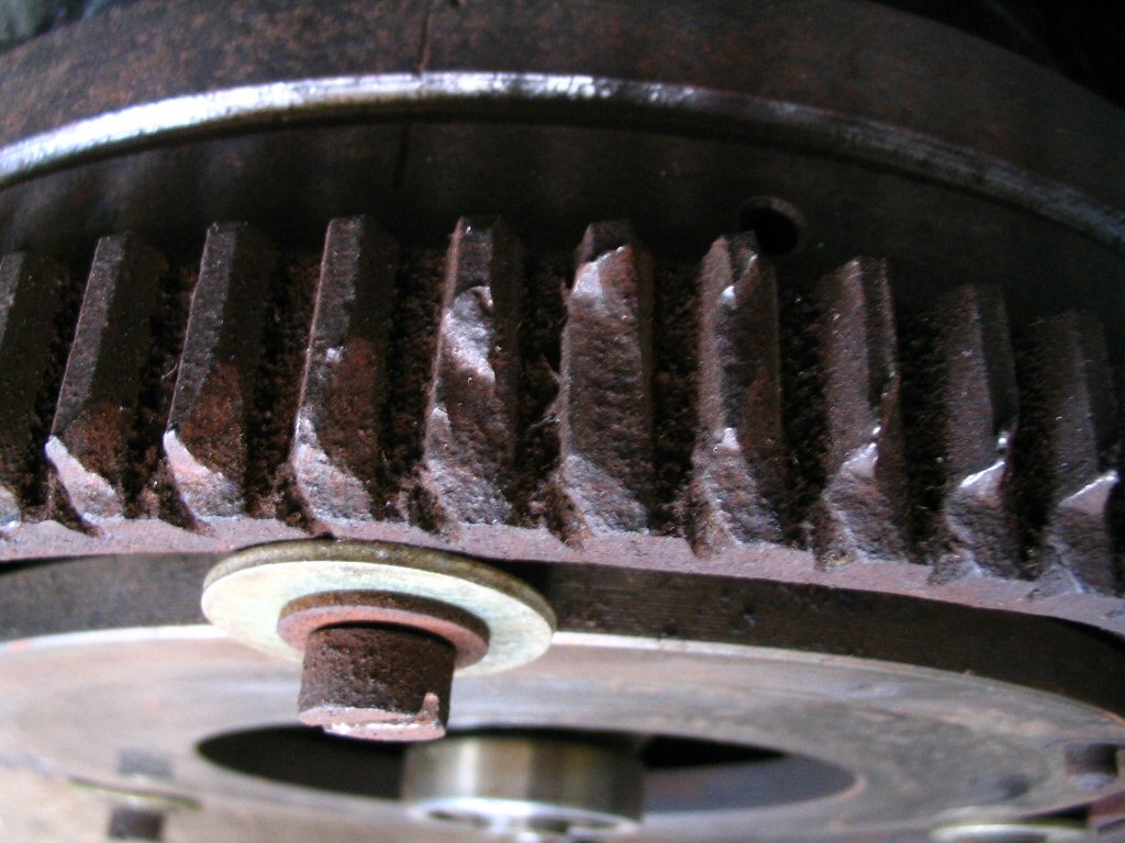

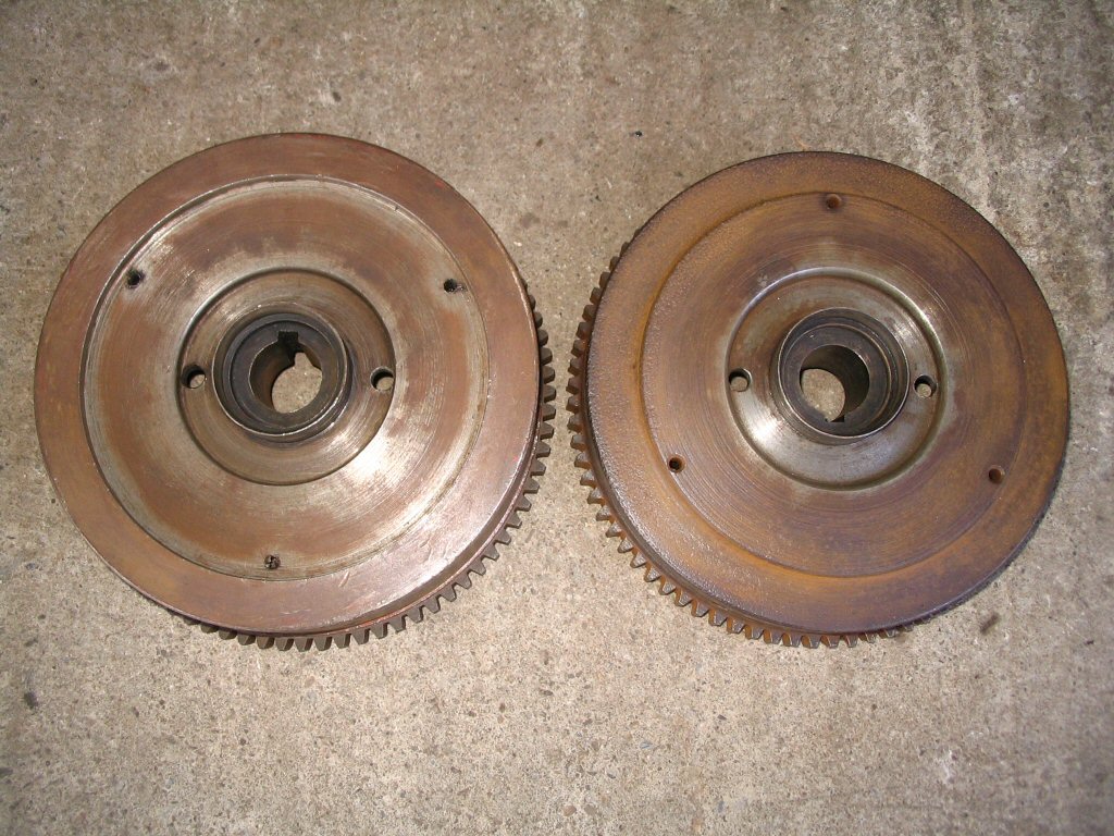

I've now moved on to looking at the flywheel ring gear which is in a poor condition around TDC as can be seen below:

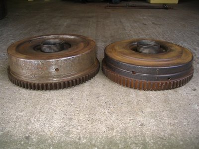

I had a look at the flywheel from the 1932 engine which is in good condition, but also quite different from the one on the 1934 engine. Note also the 1932 (left) TDC mark is on the opposite side to the keyway, and the 1934 (right) TDC marking is in line with the keyway.
The 1934 ring rear appears to be cut from the casting whereas the 1932 is a separate ring which is much narrower. I've decided therefore to try having the damaged teeth built up with weld and then filed back to shape - I post how I get on.
Posts: 55
Given Name: Richard
Post by richard turner »
New ring gear may be available. Vintage Restorations, Colwyn Bay. Regards Rich
I have been told (but have never done it!) that ring gears hay be removed by GENTLE heating and then refitted the other way round.
It occurs to me that perhaps there is / should be a sort of bevel or 'lead in' on the front edges of the gear teeth, or is that just a sign of wear on a used gear?
You will have to remove the existing gear ring anyway, so maybe worth a try?
on most flywheels the ring gear is shrunk on and can be removed by reversing the process i.e. heating the ring gear. However for some strange reason the flywheel ,as far as I am aware , on the twins up to and including the CB Bradfords had the teeth cut in directly in the flywheel itself and no ring gear was listed as a spare part, instead a factory reconditioned flywheel was available . The CC Bradford has a 'normal' flywheel with a replacement ring gear being available as a spare part.
I thought the 1932 flywheel as was of the same integral teeth as other twins ????and wonder if the one pictured had perhaps been machined to take a ring gear of some other engine????
I did know a bloke who successfully built up damaged teeth with weld and then filed to correct profile
Julian wrote:I've decided therefore to try having the damaged teeth built up with weld and then filed back to shape - I (will) post how I get on.
Julian,
Perhaps Jowett car Spares has a reasonable flywheel with a good starter ring. It might be as well to ask, and then if it's 1/3 the price of the welding/grinding you'll be in pocket.
George, Roy Braddock sold me a NOS ring gear about 30 years ago, which I still have. He knew I only had 'Mary Ellen' the 1934 Short Saloon, so I thought at the time it would be a good buy, just in case I would ever need it in the future. How often did that happen!!
Talking of which, I also have a NOS Bradford Pinion and ring gear from Roy, inter alia, which I was led to believe could be fettled into the back axle of the early pre-wars...., and so it went on.
But ..... I also bought a new half-shaft around the same time, and a couple of years ago it came in handy. Good old Roy.
