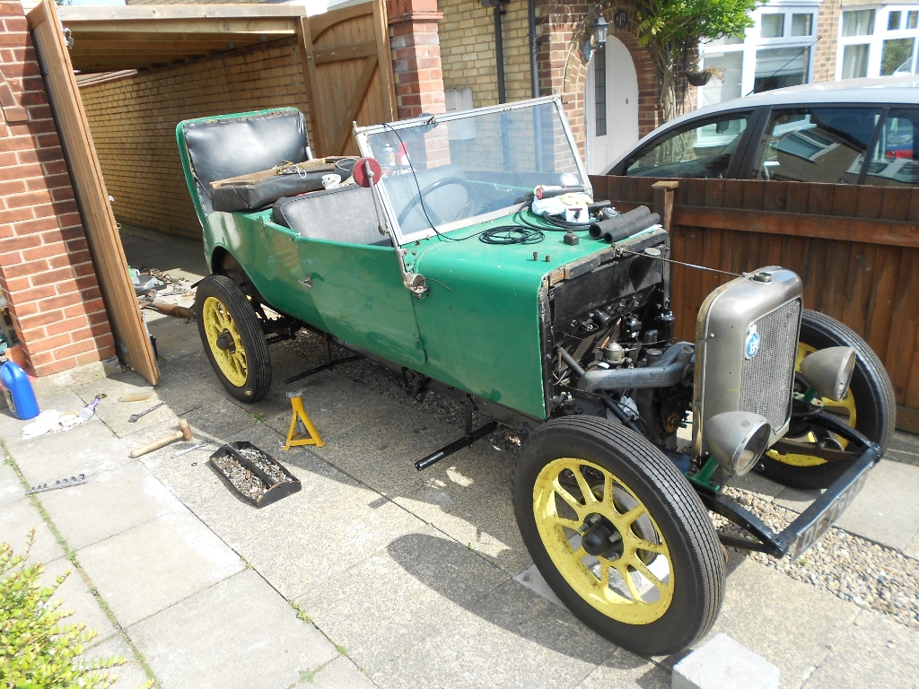

The car is now very much going back together. New rear axle oil seals are in and the brakes overhauled. WIngs are all welded and painted ready to go on and running boards repaired. New exhaust system is here ready to fit up. So far, the only real frustration had been getting rad hoses to fit! I have finally sourced a "classic wrap" style top hose (which spares seem to have in every size apart from the one I need) , but just when I was exctied to try filling the rad, I found I have 2 short hoses for the bottom, instead of one long and one short, so hopefully Jowett Spares can swap one on Monday.

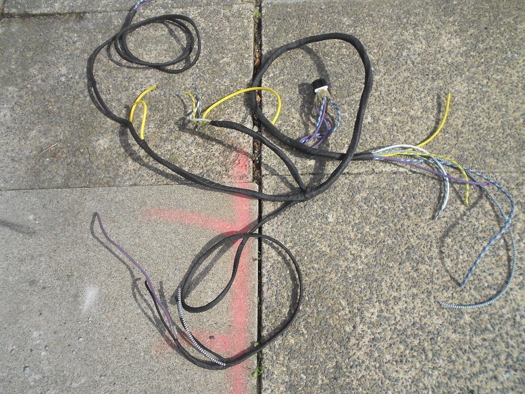

I thought I should take some photos of my new wiring loom, of which I am very proud. I've used braded cable and fabric loom tape, but you will notice the addition of a change over relay (hidden under the dash). This is activated by earthing it via the single wire to the dip switch on the steering wheel (I removed a foot operated one) and swaps from low to high beam on the O/S head lamp. The only other addition is a feed and earth to the bottom of the rad, to future proof in case I need a cooling fan.

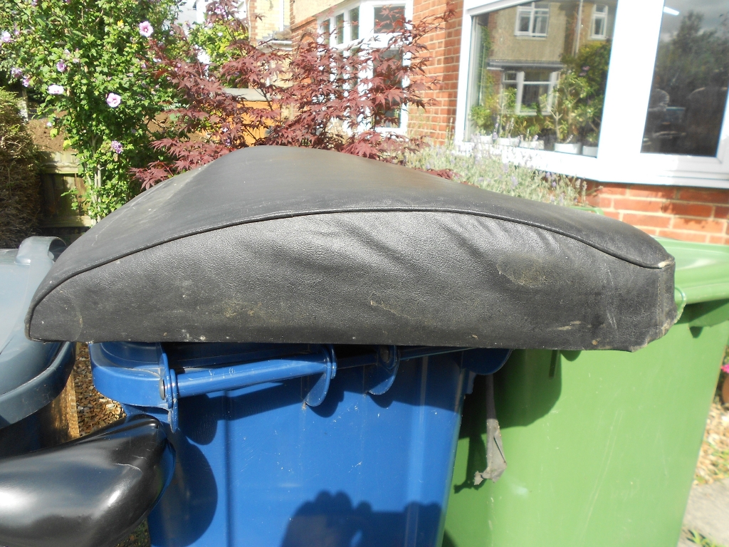

I have had some anxeity from the start about actually being able to drive the car, as I was struggling to get my feet on the pedals and finding my knees jammed under the wheel, and against the door. The 1929 brochure specifically says "comfortable for even a 6 ft driver", so it seemed a bit odd. I had already noticed the clutch and brake pedals were adjused out as far as they would go and putting these back greatly improved the situation. I then found the steering column can be adjusted up on slots, which were hidden behind some large washers and this improved the situation further, but not enough to make me feel I could actually drive it confidently in traffic. However, I think I have now solved the mystery!
The seats have been re-upholstered at some stage and when I removed the front one, I realised the seat back is now around 6" thick. I think the seat is way too thick and the problem is compunded by the odd curved shape which, coupled with the fact the base slopes forwards, has the effect of pushing you off the seat. Sitting in the car without the back in, gives a good driving position! The dicky seat has a massive lump in the middle of it and the whole job is pretty poor, so eventually, I will re-upholster the whole lot. In the short term, we'll just try removing the bulk of the stuffing and reprofile to a flat design.
I need to get to a meeting to have a look at some other cars, but I am assuming this would have only had around an inch of padding on the back??

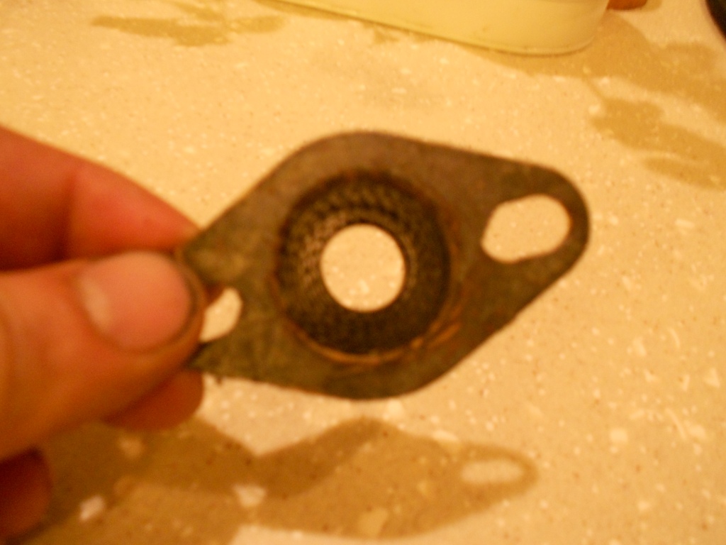

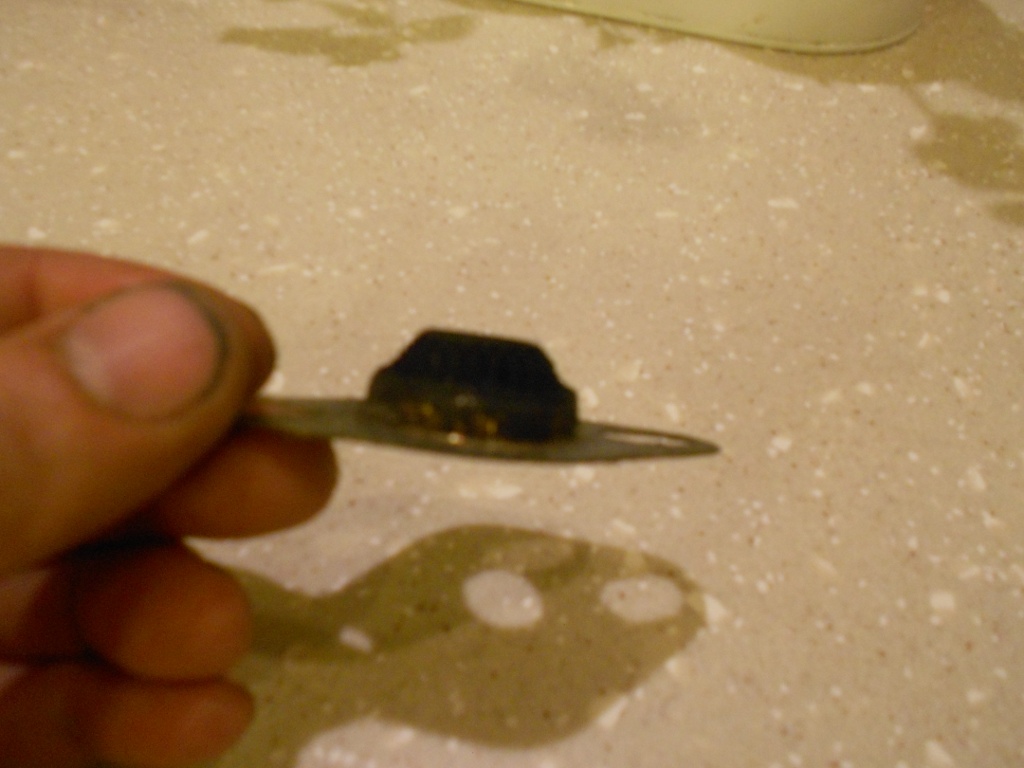

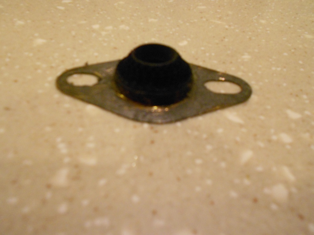

While cleaning off the old manifold gasket before refitting the carb, I found the pictured copper spacer which has what looks like a restrictor/diffuser in the centre. Sorry for the quality of the photos, but can anyone tell me if this is standard and should be there and what is its purpouse??

definitely not original . It is one of the many economy devices available in the 50's & 60's. possibly a cox atomiser. All claimed improved economy and other claims included smoother running, increased power etc etc. some worked better than others and some did n't make much difference ! I used one called the mangoletsi manifold modifier on a javelin ( one per carb) and it did seem to improve both economy and smoothness . It designed by the well known tuning firm George Mangoletsi of Knutfford ( now alpha romeo agents.. George Mangoletsi at one time rallied a javelin and I got him to give a talk to the Northern Section in the early 60's.

Thanks George for such a definitive answer! I did wonder if it was some sort of modification from that era. I won't refit it at the moment, as I don't want any complications setting things up.

I am a little sceptical if fitted to a Javelin as such a restrictor and hence 're-atomiser ' is already part of the throat of the Zenith. Nevertheless this is perhaps another part that needs to be redesigned for modern petrol and its different vapourisation characteristics. This should be done in conjunction with analysis of the 'swirl' in the combustion chamber and the precision of the inlet port chamfers.
The gadget is not the cox ''atmos'' as I thought but is definately a Vokes distribution rectifier. This was patented in 1932 so may have been on the car for quite some time.
Vokes claimed it was suitable for both aircraft and automobiles! and that it provided more power and faster acceleration ''due to the torque being rendered even''. They also claimed a reduction in fuel consumption of between 17 and 30%-------all this for a mere five bob!
In 1932 engine technology was such that many engines could have been improved considerably by such devices. You only have to look at the increase in power from the same displacement that occurs every decade. It is almost the same as Moore's law for semicobductor chips.

You are right, that's exactly what it is:

It had obviously been in there for some time. I haven't refitted it, but once the car is all running and sorted, it would be interesting to try it and see if there is any discernible difference. It does look quite restrictive to me, but I guess whoever fitted it wouldn't have left it in if they weren't happy.
