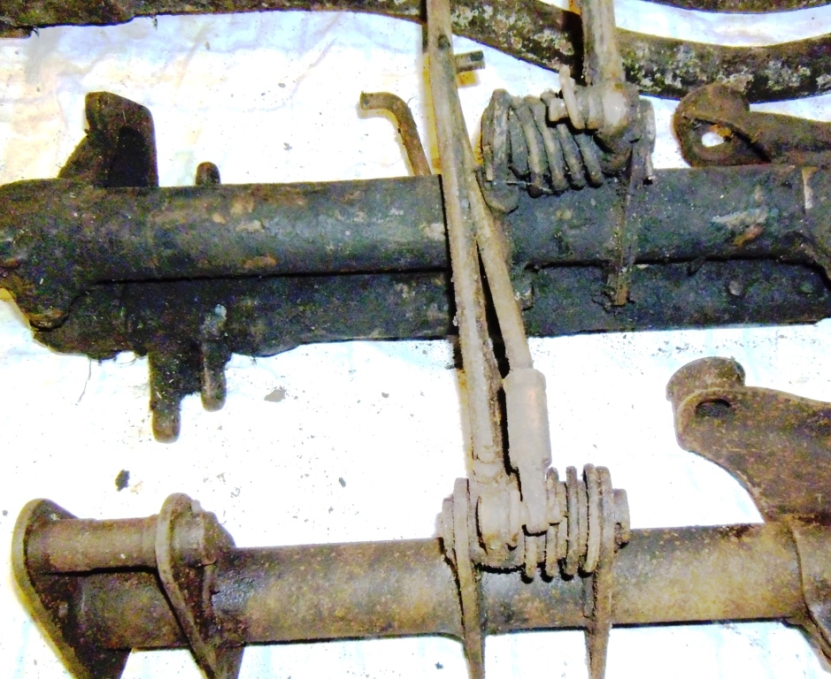

- Posts: 1744
Hi Ian,
Still doesn't show the anchorage points, but you'll have to agree that they are there, as shown in a couple of cross tubes in my spares. Tony.

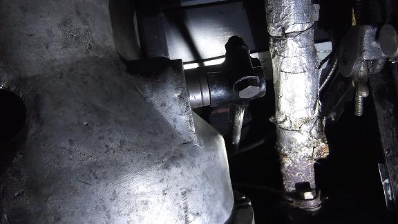

Well now All: -
From these pictures it appears we are 'talking' somewhat at cross purposes. In all these set-ups it looks as if the clutch is operated by TWO rods acting in what the Jowett literature describes as a 'rolling action'. One rod pushing, the other one pulling a double ended lever on the clutch shaft.
On my car the clutch pedal is clamped DIRECTLY onto a tube/shaft that runs in TWO BOSSES cast into the sides of the bell housing.
Inside the bell housing there are two 'fingers' clamped onto the tube/shaft which (after 1/16" clearance) bear on the clutch thrust bearing that in turn pushes three lightly-spring-loaded toggle levers that then separate the clutch plate via plungers.
Both the BOSSES referred to above are practically smooth, with no obvious place for the 'other' end of the pedal return spring to push against.
Perhaps I am wrong in assuming that there SHOULD be a spring, like the ones shown in your various photos, AROUND the shaft OUTSIDE the bell housing where there are a couple of spacers on the shaft that sort of invite the presence of a return spring?
If so, a couple of questions arise: -
a/ Is this the correct type of gearbox for the age of the car? It is definitely a 1930 model and the gearbox is three speed, ball-change type.
b/ If it is correct, then HOW should the clutch pedal be returned to a 'rest' position against the floorboards? As I said before, there is no obvious point on the pedal arm for a tension-type spring to be fitted between it and the floorboards.
I got a photo and it was B----Y cold out there![attachment=0]clutch spring 004v2.JPG[/attachment]

I got a photo and it was B----Y cold out there!(See previous post please.
(Just in case I missed the 'last post'!
The boss on the bell housing is tapered and smooth so anything resting on it would slip.
