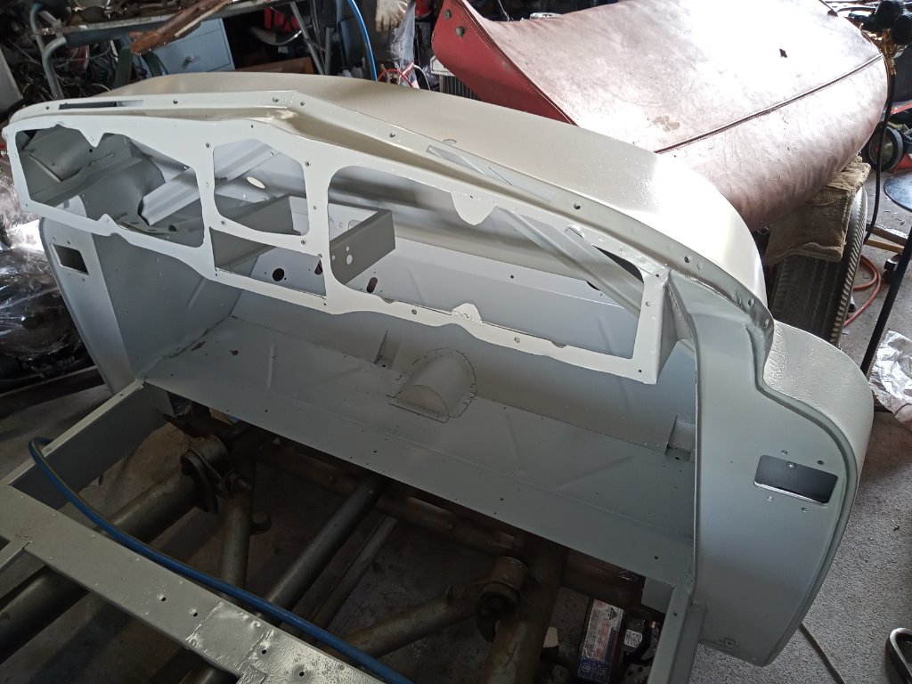

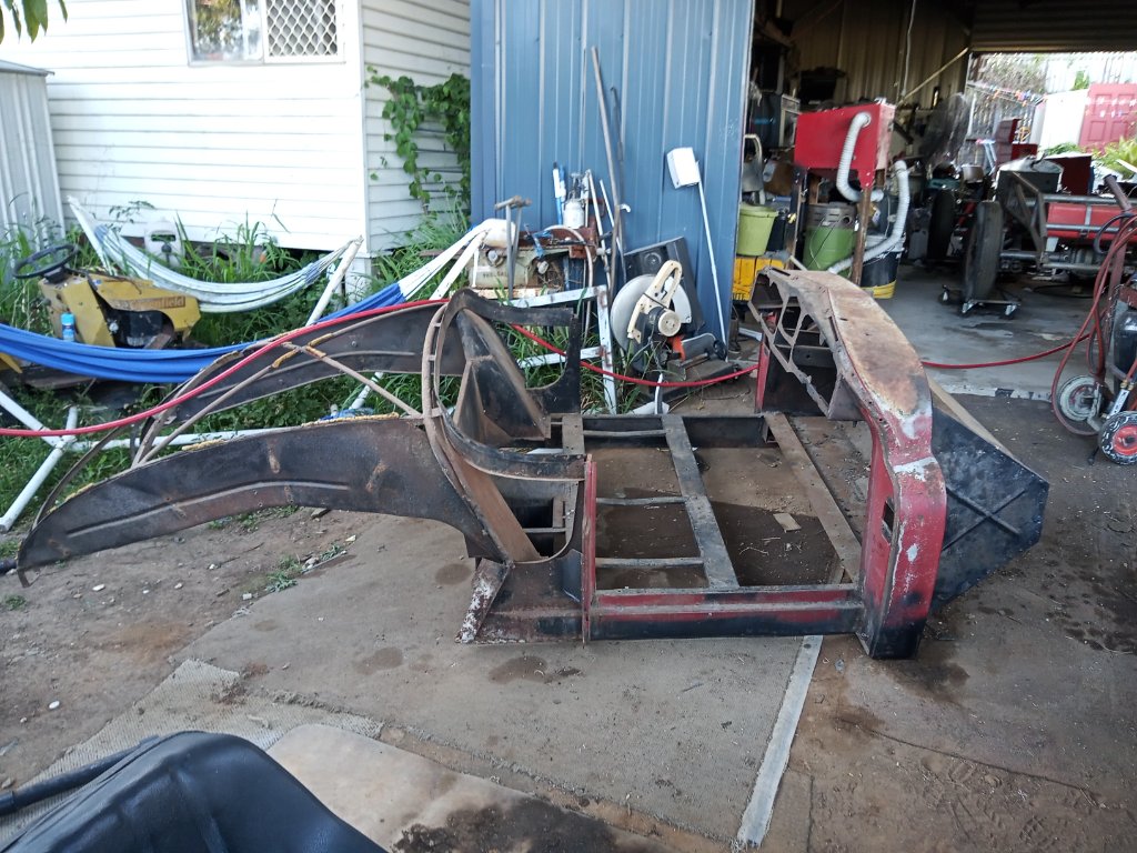

My exiskeleton is back from blasters.
It is primed to give it some protection while I repair it.

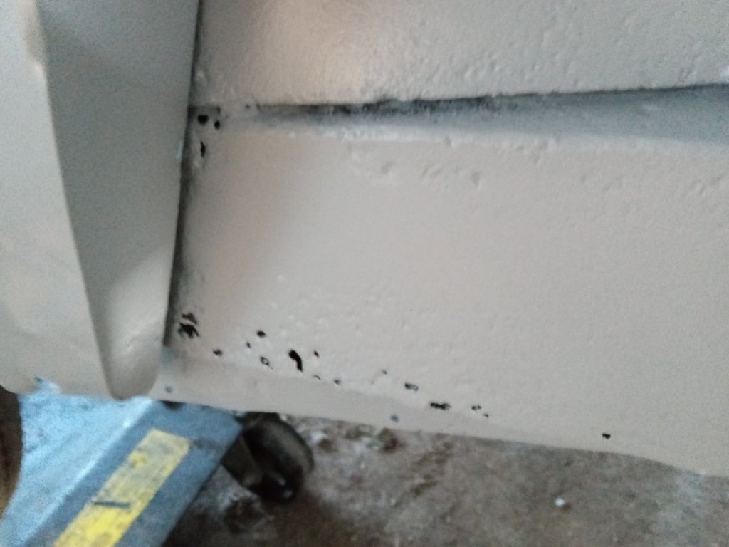

Blasting brought out all sorts of old repairs and hidden rust
Some of the repairs have now rusted through.
Nothing is that bad with the panels mostly flat & easy to fabricate if need be.
I intend to try and weld the holes where possible , as I would rather have a restoration than a recreation.
Any views on this would be welcome.

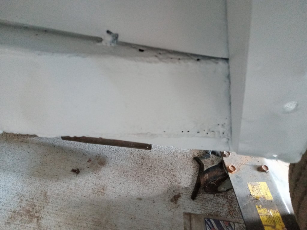

Other surprising thing uncovered is the amount if cracked welds.
