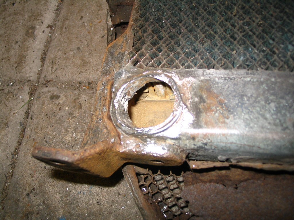

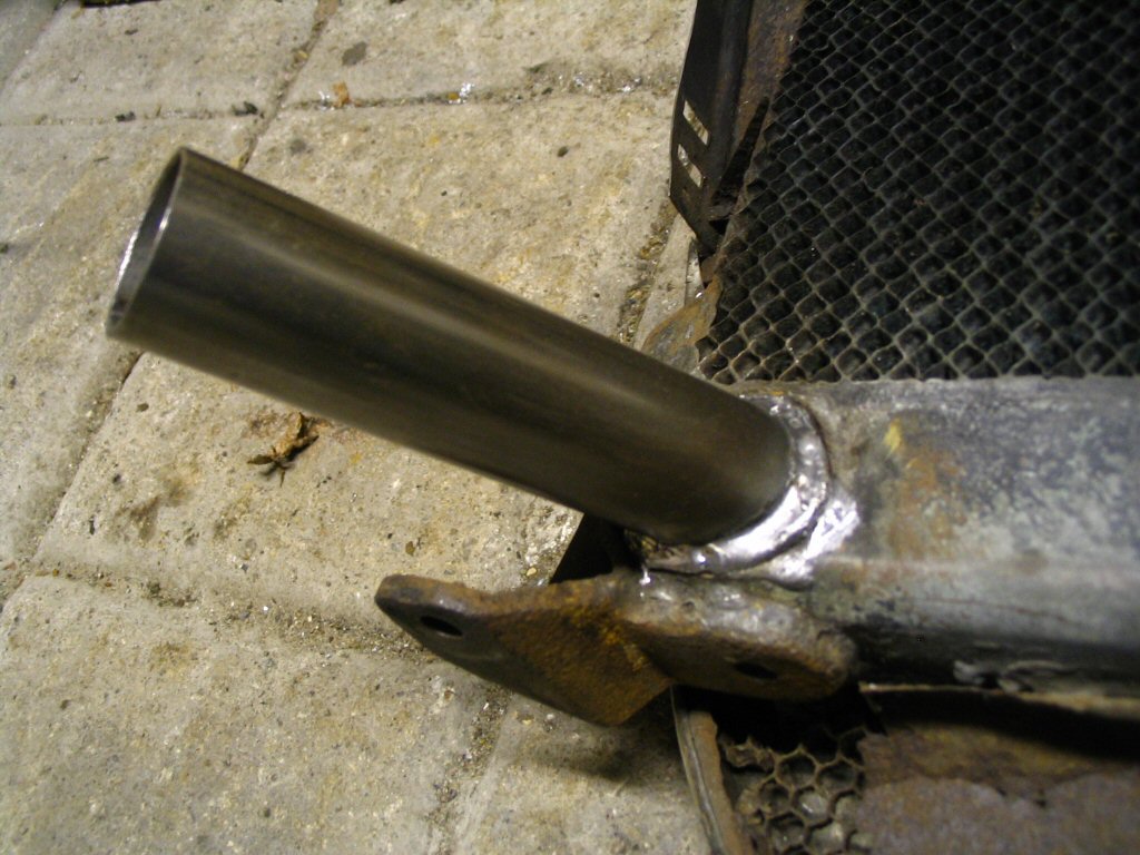

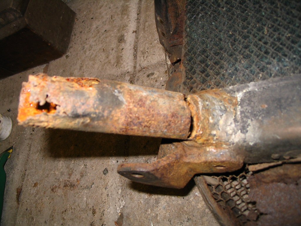

Which brings me round to the radiator repair: I decided to have a go at replacing the lower pipes which were completely corroded. I wanted to used copper pipes, but having had trouble getting hold of the right size I found my steel supplier had just the size I needed and the ones I am replacing were steel (not sure what they would have been originally). Anyway I managed with a lot of cleaning, fluxing and careful heating around the area and using a traditional soldering iron to fix the new tubes in place. It remains to be seen if they are water-tight and indeed whether the core is leaking or not! Watch this space.

Yes the original tubes were steel (that's why they rusted away). Copper would have been OK as there are a lot of dissimilar metals in the cooling system and copper should not create any additional problems, especially if you use modern anti-freeze/corrosion inhibiter.
Leaks on the outlets shouldn't be a problem as you simply re-solder them (using Baker's Fluid flux on the steel parts) until they are gone. I used an old-fashioned soldering iron (Well, copper really innit?) when I worked on my Bradford rad when I was at college. Leaks in the core are different depending on the cause. The odd small hole MAY be sealed with a commercial sealant. Slightly bigger leaks, such as a small group next to each other due to stone damage etc, may be closed up with material such as Araldite but that leaves a very obvious 'fix'.
The correct (and expensive) answer (as I am sure someone will tell us) is to have the rad re-cored.

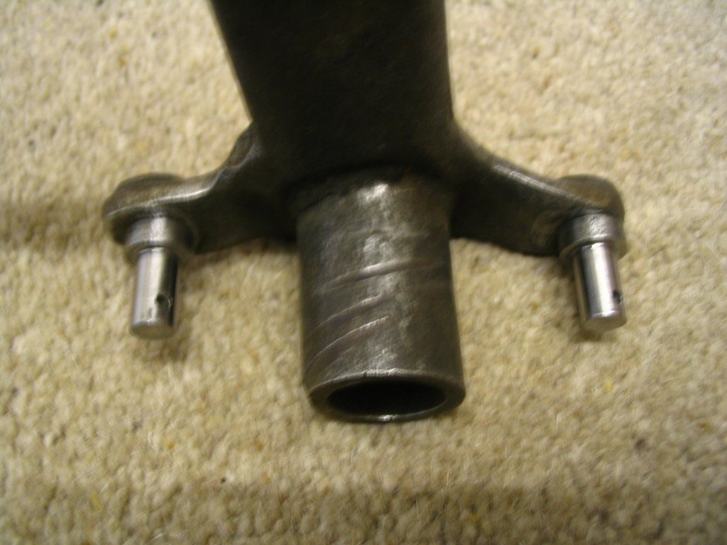

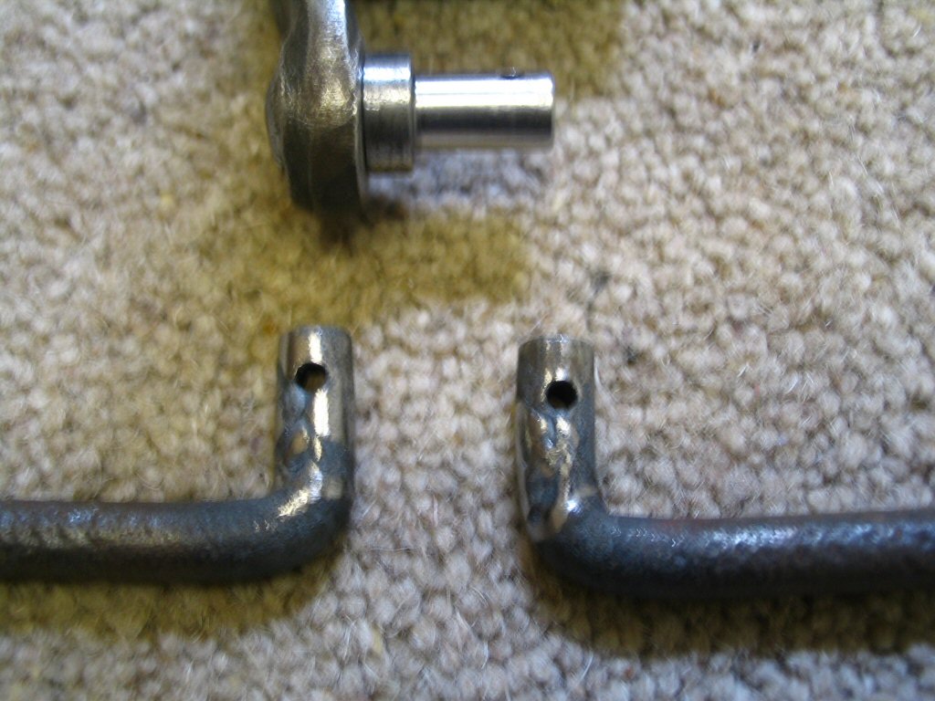

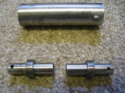

I managed to find a local welder who has been very helpful and I have now made some progress with the clutch pedal. I decided to have the link rods built up with weld and turn new pins for the clutch pedal.
Here are the new parts (including pivot pin I made earlier)
..and here fitted to the clutch pedal.
..and with the refurbish linkage rods - not perfect, I know, but takes up most of the slack & if it lasts another 80 years, I won't be complaining!

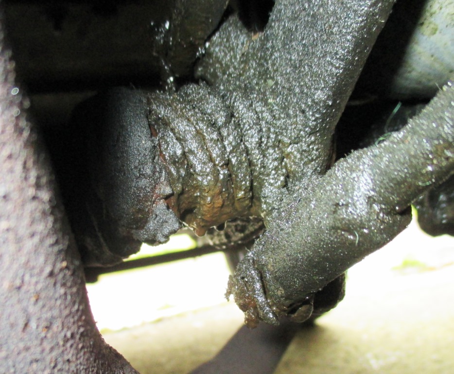

Ian/Julian,Ian wrote: I have looked at the Jowett drawings and I cannot see any sign of a return spring for the clutch pedal. Am I short of a return spring? Where was/should it be fitted?
I've been across to a very cold garage, and it started to rain so I didn't pull the car out, but lying awkwardly, on the floor, under the front wing I have managed to take a couple of rather weary photos of the clutch return spring on the 1934 saloon.
I didn't realise it was such a mess under there!
You'll have to look through the grease, oil and road-dirt, and imagine the set-up, but it's the best I can do at the moment.
If necessary, when it's warmer and drier, I'll clean it all up with paraffin and re-photo.
It would be better to have removed the front seats, carpet and floor board, and photographed it from above, but that's a bigger job. Tony.
its just a coil spring round the clutch pedal shaft that hooks onto the pedal arm at one end. Bradford could well be thhe same spring or it should be possible to make one out of fairly thick piano wire. The spring is very important as it keeps the thrust race clear of the toggle leavers .
Thanks Tony - That's all I needed.
