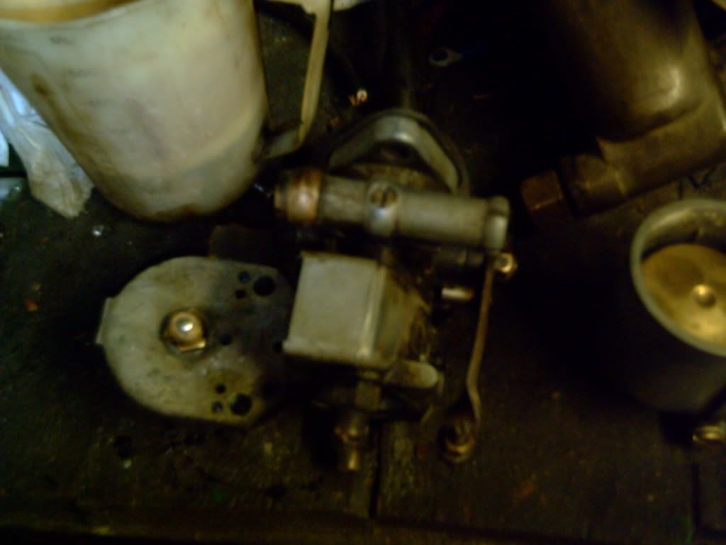

I cannot recollect seeing a zenith withthe copper tube etc & wonder if it is so;me crafty one off mod - perhaps somebody with a CA braddford can comment on this?
I am pretty sure the carb is off a aCA brdford as on the zenith application list I have nothing else uses the VEFH ( I athink the H is for horizontal - most zenith V types were vertical as on Jav & CB?CC Bradfords and of course other makes of vehicle.
AThe jet sizes in the ebay carb are a bit puzzling as aathe original settings were
choke tube 26
main85
comp70
slow 50
progression120
I wonder if the fat that the ebay carb has a much smaller main is something to do with having the extra jet & copper tube .Does the extra jet have a size stamped on it and exactly where does the copper tube etc open into the venturi - from the photo it looks as if it may come out in a position where the throttle valve blocks it when throttle closed???? \just curious!!
choke tube 26
main85
comp70
slow 50
progression120
- Posts: 759
Re: Carburetor mysteries
The copper tube, comes out of the top of the carb down around the side and on to one side of the ventri tube under neath, both ends of this tube, are open, the ventri tube leads up to through the middle of the carb, and comes out just in front of the throttle spindle, according to my book its part of the auto matic starting device, more problematic at the moment i must say. now looking at my carb and the ebay carb the hole for the copper tube in the top comes out of the side and the hole inside the top of the bowl area is also presnt on mine but doesn't exit to the outside. Ive taken the copper pipe off and the venturi pipe off, to see if i can run it alone, but seems not, though with both ends of the venturi blocked up the idle does slow down dramatically as it seems to be getting too much air, which i think could be a good thing. according to the manual its like a seperate carb, but with bits missing i fail to see how. ideally if i could get this one run properly id use this one as everything seems in better shape than mine.
have dug deep and discovered that the export CA van was fitted with a starting device rather than a strangler as used on home models (same as pre war). This could have been because the export version was fitted with some sort of air filter (as was the export CB/CC.( With the pre war jowett stangler an air filter could not be attached). The only snag with this theory is that apparently the export CA van apparently used a zenith 30 VEH rather than a 30 VEFH. ( I have no idea what the F stands for)
However if my theory is correct the copper tube & its bits & bobs will be the starting device which may well follow standard Zenith practice on other V type carbs.
- Posts: 759
On further investigations, many numerous differences have come to light, my plan was to use the good bits from this "ebay carb" and switch them onto my carb. but after stripping more of it down i have found more differences though i should have seen this coming but other than the added auto starting gear on the carb the overall appearance was identical to mine.
The throttle chamber are both different sizes, the studs which hold the bowel beaker assemble( middle of the carb if youve got the throttle flap at one end and the air strangler) are difference size, plus the casting holes for the studs are smaller diameter. So i cannot fit my longer studs to fit the air strangler on the end.
And Keith you were saying about the tapered point of the idler screw, im guessing that these were tailor made to suit each carburettor?
Also on the auto starting gear I'm wondering if it were possible to take it off? I guess this did the job of the air strangler?
Oh and George the thin other jet was numbered 06 or 60 as the screwdriver slot was a bit chewed so could only just make numbers out.
