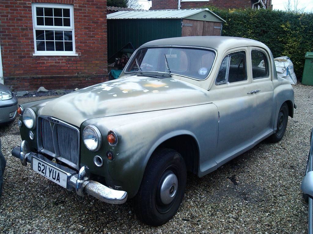

Over on the Rover Forum my 200TDI engined P4 causes indignation everytime I post [ frequently, tee, hee, hee :twisted: ], and yet they quite happily babble on about fitting radial tyres, power steering, alternators,........... to their otherwise "original" cars. Yes, these items are fitted to improve the car's OEM shortcomings - but rodded nonetheless. :wink:
ALL that said, I just got my "Jowett History" book, and that engine does seem exceptionally well designed for the period. Turbo, Eaton Blower ????????? :twisted:
"Nelson" in early build
And "as is" - awaiting the next phase - lowering, alloy wheels, paint job [ Satin Black ? ]
