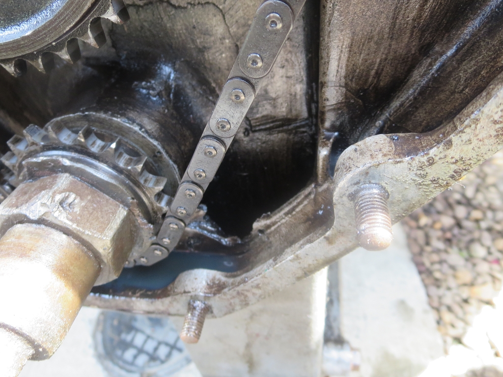

Barry, if you have to take the timing case cover off it is worthwhile drilling a small hole between the bottom of the timing case and the crankcase so any exess accumulation of oil in the timing case drains back into the sump. This 'mod' may of course have already been done to your engine.

Inevitably (and I mean inevitably) taking the timing cover off revealed more damage. As Tony predicted, the case was badly bent at each nut and along the bottom edge, and the chain and sprockets are all badly worn. What did puzzle me is that the chain was completely dry and in fact the whole case seemed to be too.
How is the chain supposed to be lubricated? It looks to me as though it should run in an oil bath in the bottom where there does look to be a small hole, as George suggested. However, it also looks like a bit of the casting is broken off, so the bath can't fill to the level of the chain.
Does this look right? I wonder if it was broken when a chain snapped, or when someone was beating the crank nut with a chisel! I assume the washer behind the nut was a locking tab at one stage.
