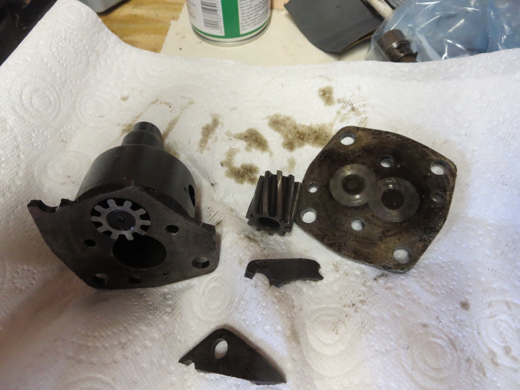

I found ten minutes this afternoon, so thought I'd have a go at the oil leak. Following instruction I spent 15 minutes heating the sump with an electric heat gun and sure enough, a quick tweak on the puller bolts and it started to ease itself out. I actually felt quite smug ........... right up to the point when two bits of flange fell out onto the drive
It was clearly running like this for some time as the breaks are completely blackened.

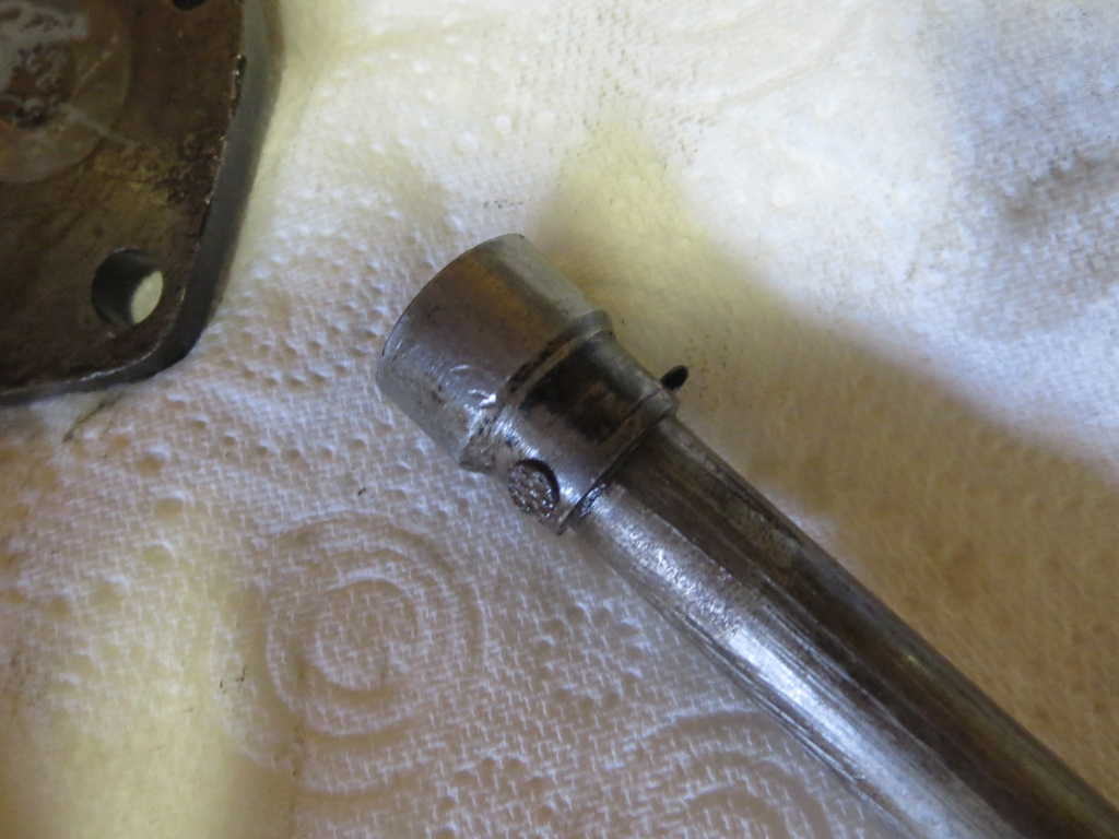

Further inspection revealed a bent nail holding one drive socket onto the drive shaft and it was at this point I realised I can remain in denial no longer - the 1967 engine rebuild proudly stamped onto the crankcase has been done to exactly the same standard as the rest of the work on the car.
It's clear that while the internals of the engine and gearbox seem fine, it's going to be safest to strip and check the whole lot over the winter before something lets go in spectacular fashion.
As a plan A, I'll ask JCS if they have another pump, but I'm guessing they are a bit thin on the ground given their fragility. So my question for today is, which engines would the pump be fitted to? Was the same pump used in the Bradford engine??
Plan B is to go down to the engineering labs and start crying to see if they take pity on me.

Stick it back together with Araldite, a tried and tested Jowett owner's solution!
It is a period bent nail...

Ok - I'll try gluing it, but it needs a good soak in acetone before I start I think. The pump itself has no wear at all and at tick over, the oil pressure is right at the top of "Idle" on the gauge, even when it's been running for an hour or so.
As for the bent nail Keith, I can only assume it was put in during the engine rebuild. This was 1967, so certainly pre decimal, even if not the correct 1930's item. If I can straighten it accurately, I could maybe measure it to see if it is an inch or 25mm? I do have a 1934 parts list, but it doesn't show up on that, however, I have just demolished the old wood shed, so I maybe able to find a replacement there.

It may be worth drilling a couple of small holes in the casting and put some pins in. Araldite may not have enough shear strength.
Any idea what caused the breakage? Sometimes it is caused by not having a gasket between the joint and then excessive tightening. Or could it have been knocked when the sump was hit?
BarryCambs
- Posts: 331
- Given Name: Barry
There's no obvious sign as to how it got broken. I was hoping the leak was down to a gasket failing, but there wasn't one fitted, so it could have been over tightened. The puller bolts are only threaded through the top plate, so I guess could break that if over tightened, rather than the flange. I'll check it all on the surface plate before reassembly, but the marks on the cap are polishing more than wear. Might treat myself to a a rivet too!
the glued bits will not be under any great strain as they will effectively be clamped by the bottom plate. The usual reason for that type of breakage is cack handed attempts at removing the oil pump by force rather than aforementioned heating until it drops out.

When re-assembling the pump, and putting back into the engine casing, perhaps a bit of blue Hylamar goo between the casing and the pump flange, and very sparingly between the pump bottom and the cover plate will help stem the drips.
The araldited bits will have to be in the same plane as the rest of the flange or the join will break on re-assembly.
George, I can't remember if heat is again necessary on the engine casing just before re-fitting the pump.
When the pump is removed, the driving spindle joining it to the gear on the camshaft just drops out.
Re-assembly may necessitate removal of the front engine cover (timing case) so you can see to marry the ends of the spindle.
If this is removed, and it is the pressed-steel type, then tap the flange level again at the bolt holes before replacing it with a cork gasket and more Hylamar on both gasket faces. Otherwise you'll get more of the dreaded drips .

if the pump body does not push into the crankcase by hand I would advise heating the crankcase until it can as this enables the pump body to be rotated slightly if necessary to line up the bolt holes. It also ensures a good tight fit on cooling. To ensure that the araldited bits are in line I would suggest putting some thin polythene sheet over the bottom plate and clamping the pump body and areldited bits together until the glue is well and truly hardened.

Probably best to assemble the unit whilst the Araldite is still setting. A paper gasket will prevent any excess from permanently fixing the bits together.
