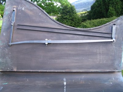

Another update - this time on the bonnet latch mechanism which was completely missing from the car when I received it. Fortunately the bakelite handles did come with the bonnet.
Thanks to Tony for removing his mechanism and allowing me to make templates of the parts. Here are the new parts after lots of cutting filing and bending:
And after further bending and drilling, the assembled mechanism, which amazingly works very well!!

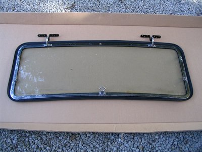

I've been working through a list of jobs that need to be completed before being able to put the car on the road. This includes things like installing the windows. After a struggle splitting the windscreen apart and installing new seals I've managed to re-fit the laminated windscreen. See before and after, below

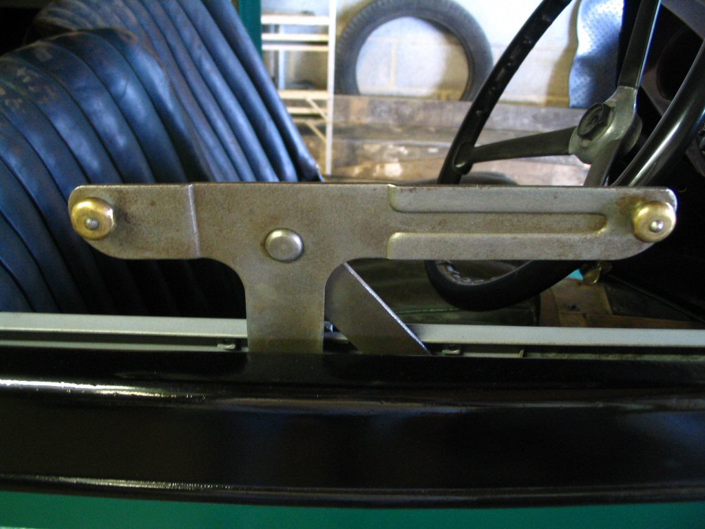

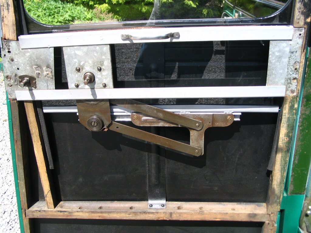

The rear door windows were salvageable, but I had to have 2 front door glasses made to a template in 4mm toughened glass. The rear and front passenger windows are now in place, but I am having trouble locating a lifting channel for the drivers door. The winder on the drivers side differs to the other 3 as it operates on a single turn of the handle ( presumable for speed to assist with hand signals). The picture below shows the spring loaded brass pegs that I assume engage with a channel and slide along as the window is raised & lowered. I ordered a channel from Paul Beck Vintage Supplies, but unfortunately this is the wrong shape & size for the pegs
I know its a long shot, but does anyone have such a channel (any condition) or failing that a photo of the channel showing the profile. Any help & advice as always would be very much appreciated. :D

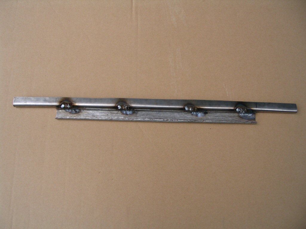

After much discussion and searching for parts Tony Fearn came to the rescue and literally knocked together a channel that would slide along the brass "wheels" I then managed to fold a channel for the glass and a friend welded the two parts together:-
Fitting it all together with the glass and winder mechanism was a bit tricky & in the end I removed the door and laid it down to minimise the risk of dropping the glass. Photo shows the completed assembly:
..and the passenger door for comparison:
The movement of the driver's window isn't perfect, but this is more to do with the wear and tear of the winder mechanism than the channel, so further work to improve this will be needed.

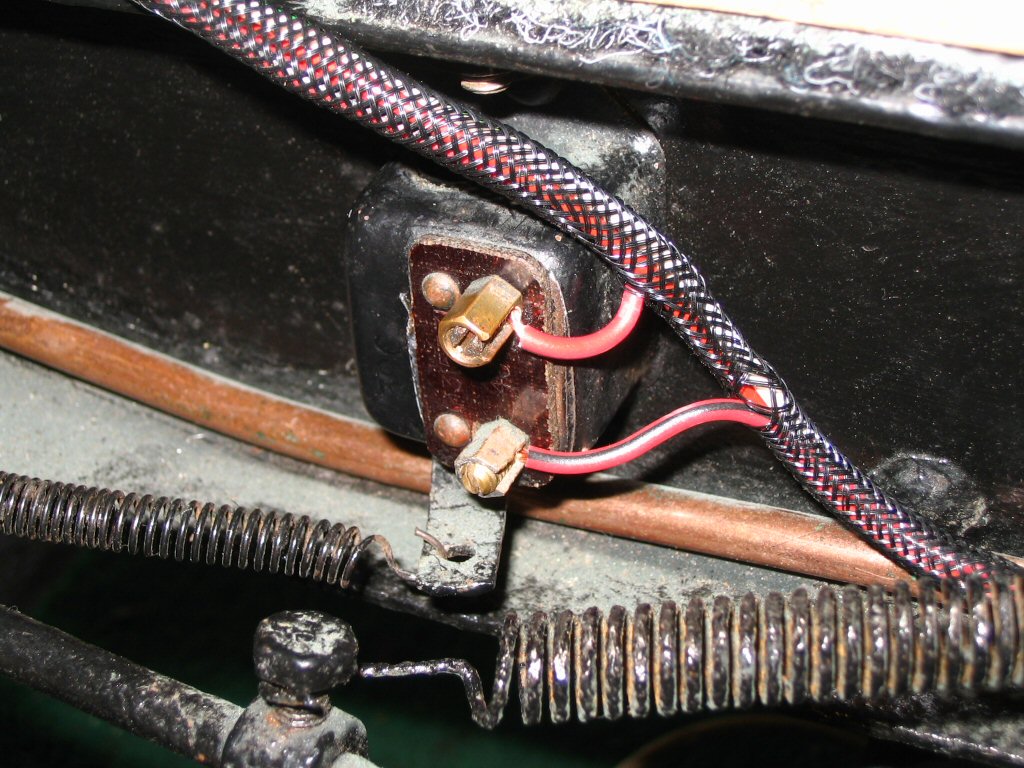

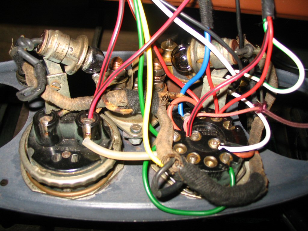

One of the other main tasks to get the car on the road was re-wire the temporary ignition and charging circuits and to to wire up the lights, horn & wiper. I used coloured wires, rather than black with coloured sleeves, but kept to the colour codes indicated on the wiring diagram where possible.
I used a mixture of pvc tape, cloth tape and expandable sleeving for the long run from the front to the back of the car. Pictures show some of the details
Behind the instrument panel:
Headlamp & side lamp junction box:
Horn & dip switch junction box. I added a 12V and 0V supply here for easy access for updates like indictors/ power socket etc.

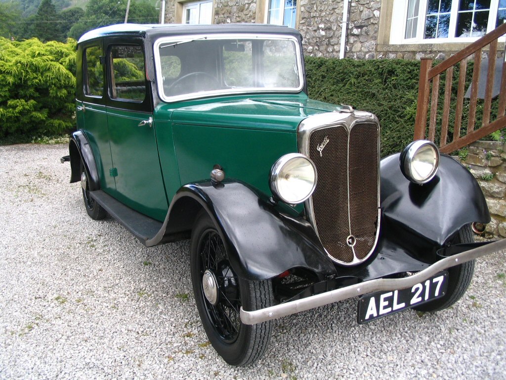

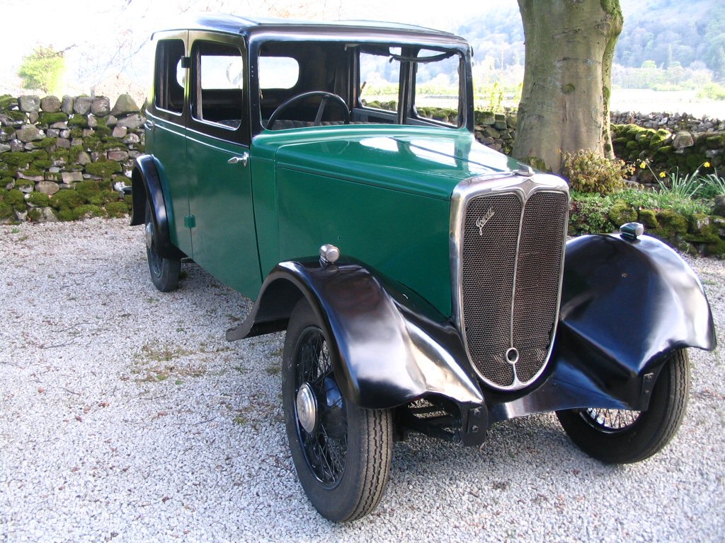

Pictures of the "finished" car below. Still lots of work needed on the interior!!

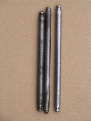

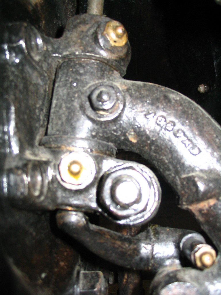

Having returned from the Jowett re-union where Tony demonstrated how the brakes should be on his car, it became apparent I needed to investigate the brake performance on thy Kestrel.

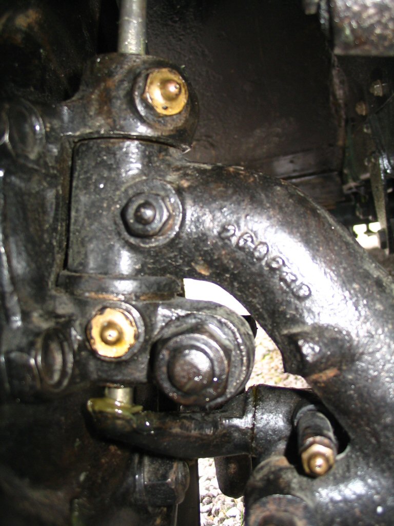

I put the car up on 4 axle stands & it was soon clear that the front off-side brake was not being applied as firmly as to the other wheels. It didn't take long to find the cause of the problem: The operating cam at the bottom of the king pin was hard up against the casting. The nearside on the other hand had a good 3/8" of clearance.
Having removed wheels, drums and operating arm at the top of the back plate, the king-pin brake rods were extracted. The off-side rod was around 6.25" long, whereas the near-side was around 6.5" and was clearly home made. Presumably the previous owner had had problems but only attended to one side! I expect with new brake linings and no ware on the various levers, that the standard rods are OK. During the restoration I didn't replace the front linings as they had plenty of material left, but maybe I should have! I decided though to continue with the longer rods solution and turned a new rod from 5/16" bar. Picture below shows the original rods and the new one on the right
I also reshaped the ends of the other rod to match before refitting and checking clearances. Photo below shows off-side with new longer rod:
I then went round and set up the brakes with the front starting to “bite” slightly before the rear and took the car for a test run. What a difference!!
